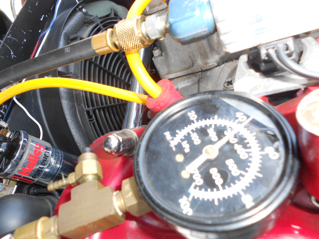

pic of mine mounted on an aluminm fitting, you could get a shrader valve, and install it into the square steel tube.
pic has FP gage hooked up, only takes couple minutes to test.
Summit racing has them.

Hi Ron
Cheers!
Yes, that's just the sort of setup that I need, except that I don't have the skills to make my own fuel rail
So was hoping for an out of the box solution
Like fitting a new fuel rail from the later model, that already has a Schrader Valve built in
Anyway Thanks for the Pic, that looks a great Setup

There is no schrader valve on my 6.0L fuel rail, and I would be a bit wary of them. If you want a FP gauge I would do it the way Ron did and plumb it permanently, less to fail. Or use a JIC and a good quality ball valve and remote mount the JIC to connect to a gauge.
