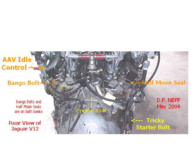

Wonder if its that half moon seal at the back of the head?
That or leaking pressure senders, or the cam cover gaskets, or a leak through the ungasketed joint between the tappet block and the head. Or all of the above!
greg

hopefully it is that half moon.
when looking from above and then underneath, its a bit difficult to keep track of the physical locations of each of the various components.
this photo i found on the other forum (luckily its already credited) shows that half moon right above the starter location.
Attached Thumbnails Gear reduction starter... questions on a few details-1%7E1084206612.jpg
