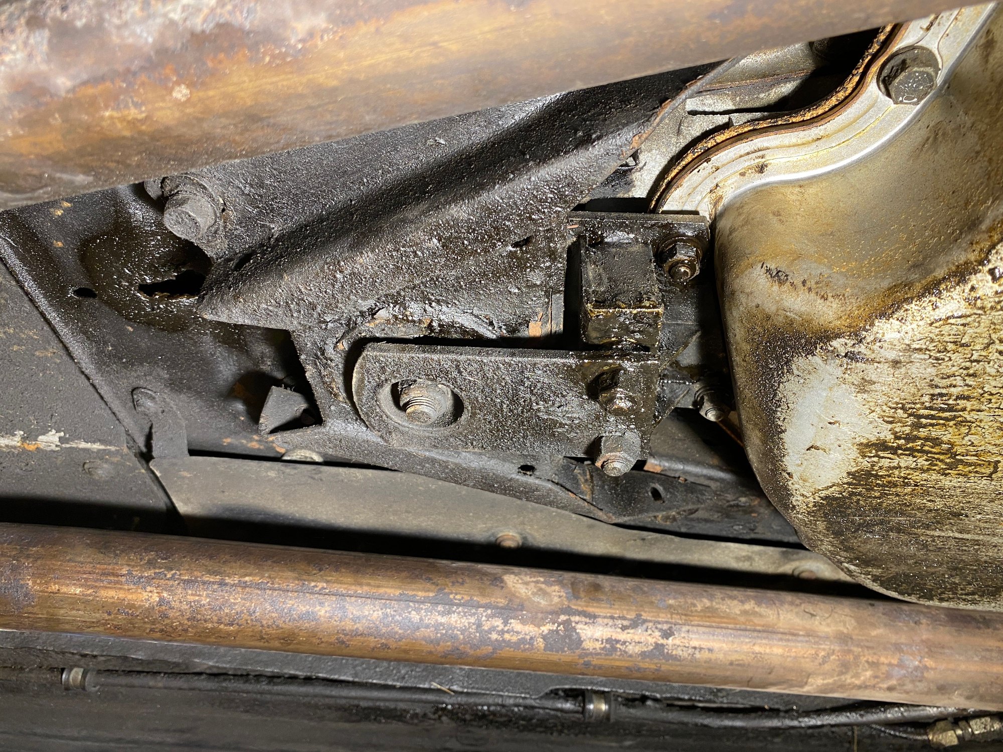

Hi
My 1977 had an HE transplant long time ago, and I suspect the gearbox was changed at same time and that my rear mount is custom made.
Gearbox pan has Turbomatic and Div of GMC embossed, so it’s the TH 400.
The ROM suggests I just loosen the bolts holding the pan and lowers it. This gearbox mount is for sure obstructing that.
Could someone experienced make a qualified guess of how I should proceed from here ?

Leo,
I THINK you've got a standard mount there. Have a look at attached video for help on changing transmission filter.

Finished viewing the video, and it’s clear that I have the standard mount and that the ROM is pretty unclear on this topic.
Thanks Paul and Adam (for the video !)
BR Leo

Leo
To get the pan off you have to remove the rear mount, which is not easy. There are various ways of doing it, but it involves supporting the gearbox pan and the brackeT. This might help:
https://www.jaguarforums.com/forum/x...itting-145478/

Yep, standard V12 TH400 mount, WITH collision bracket fiasco.
I have removed that collision bracket on all mine, and dropping the pan is soooo simple, as is putting it back.
That removal does not sit well with some people, but down here, it is as common as Cold Beer.
Your car, your choice.

Thanks. I had heard about that bracket, but didn’t know what it was.
What gearbox oil change interval is normal ? Mine decided to blow out most of the oil at the line to the radiator, so I was kind of forced into changing it. That also explains (most of) the oil on my photo…
Leo

Job done. That was not fun !
I fully appreciate both Grant suggestion to get rid of the safety bracket and Greg’s suggestion to use threaded rods to guide the mount back in place as that was a pig of a job to do on the floor with just the front end raised. I’m not 60 yet, but getting close…
Adam’s video makes it look fairly straightforward and leaves out a few details, but it still explains the general process well. He does by the way recommend using an oil suction device for the repeated oil changes to get all oil changed.
Tomorrow it’s just the oil cooler rubber hoses that shall be replaced and then it’s oil filling time. I’m curious to see how much it will take as oil level was so low that it lost drive after being parked. I’m not too worried as it has done max 5 miles laid back city driving from a no-drip-parking to the no-drive-parking…
