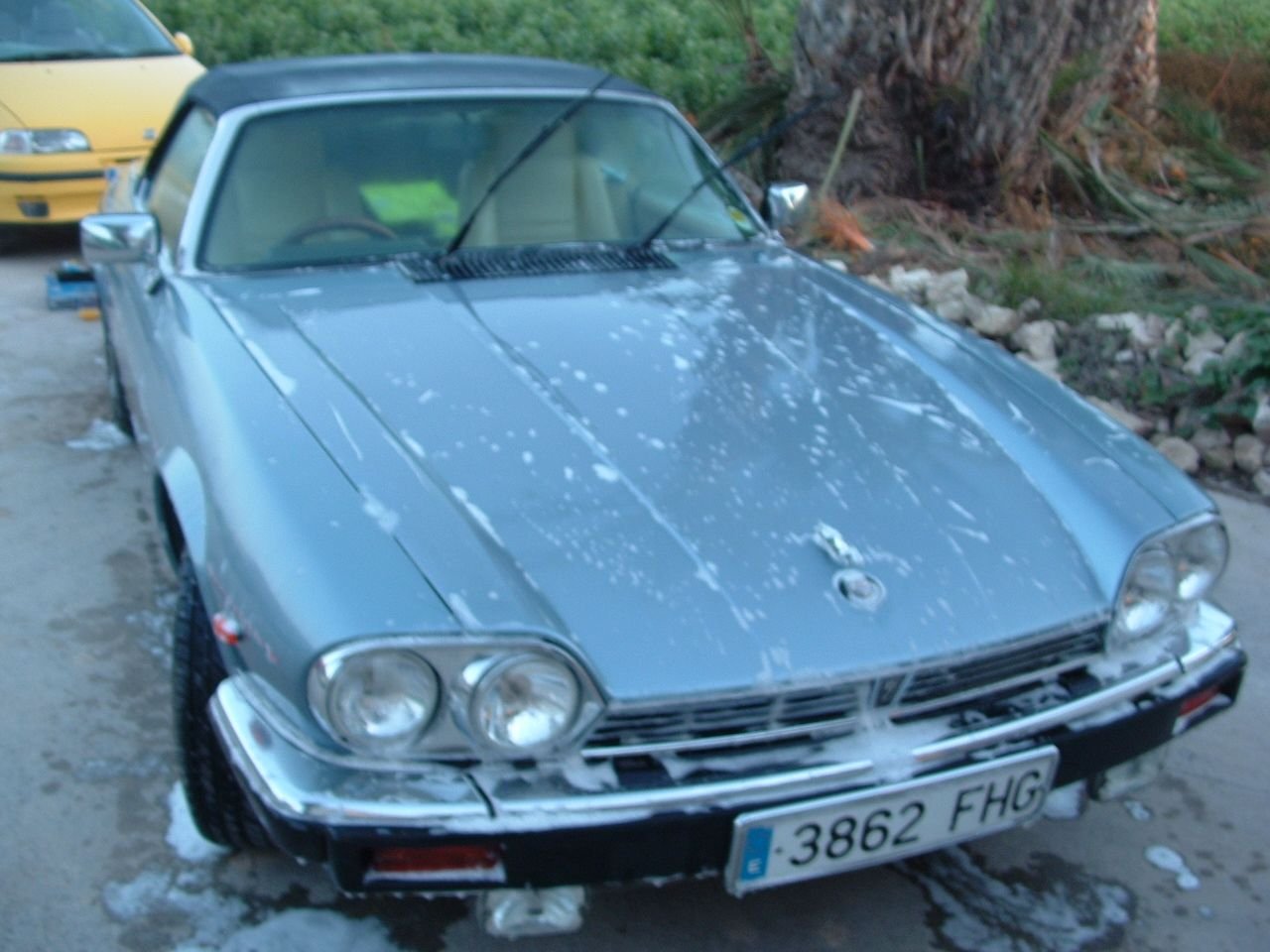

Hello all.
I have had a good look through all the posts regarding GROWLER and LEAPER removal/fitting for XJS but cant find anything.
A kind member of the public decided that my XJS would look better without the GROWLER and the LEAPER that were fitted on my 1989 XJS V12.
They both survived, but there is damage to the bonnet (hood) which needs attending to.
I have removed the LEAPER, but the GROWLER is still there.
I had assumed that the GROWLER is held with a bolt and pin through two holes, just like the LEAPER. However, the bonnet (hood) under the GROWLER is double skinned with no access holes.
Is the GROWLER just stuck on? If so, its stuck bloody well!
Any advice would be greatly appreciated.
Many thanks in advance.
Paul.
Alicante.
Spain.
Damage to hood...someone wanted the growler and leaper and tried to prise them off.

Do You really need to remove it?
As the 'Growler' is a fitment on many an XJS unless of course you need it out of the way to repair the Hood/Bonnet.
As you can see from the Photo, its just held in place with one bolt and a very deep washer/spacer, so you will need a slim socket wrench to get into the hole to undo it.
And a squirt of WD40 would not do any harm before you start.

I removed my growler for painting and it was held on by a big nut underneath like your the leaper looks like it was. I don't think 2 sided tape would hold on that well.

Thanks for the relies OB and Gunner. Its looks like my LEAPER was fitted where you have the GROWLER, and my GROWLER is a couple if inches lower down the bonnet. It needs to come off as its been prised up slightly on one side (not enough to see under or feel with a plug-gap gauge). Has to come off to repair bonnet and paint. As I have to respray the whole bonnet anyway, I guess I will have to cut it off and see what I can get away with. Its positioned over the twin skin part of the bonnet. Could be glued on with two-pack or something. I would like to get my hands on the nice chap that did this to my girl.
Got to get it done as its going up for sale (3600 pounds + project car, well cheap!). Need to generate a bit of cash and make some space in the garage.

I think your leaper was fitted to the original mounting point intended for the growler and the growler was moved forward on the bonnet. I would guess it is stuck on.

I agree that the growler was moved from its original location and is most likely just stuck on with some double-sided tape.
Use some dental floss or fishing line to cut through the tape. Once the Growler is removed you will be able to remove any tape that remains stuck to the hood.
