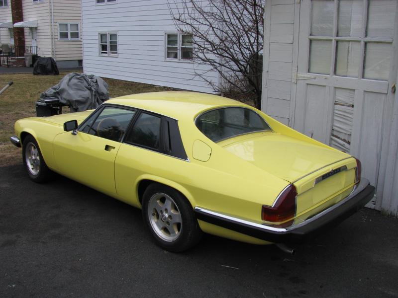

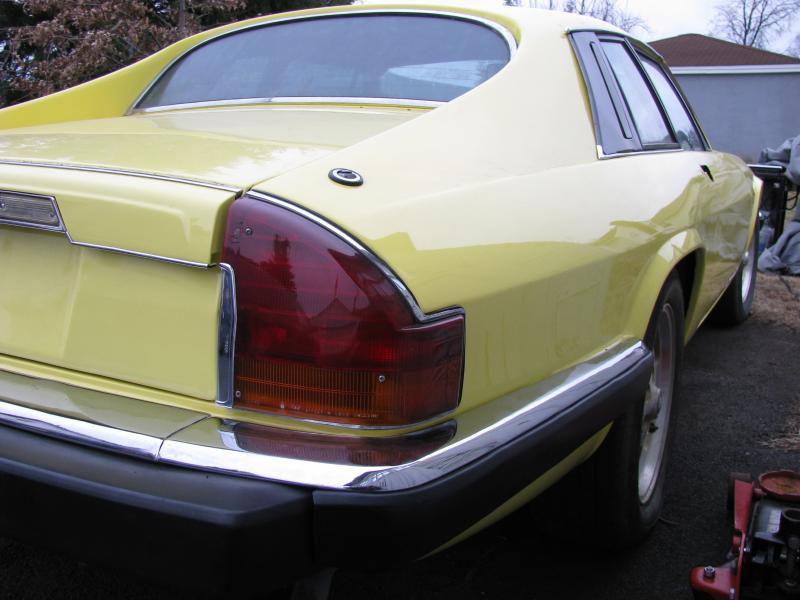

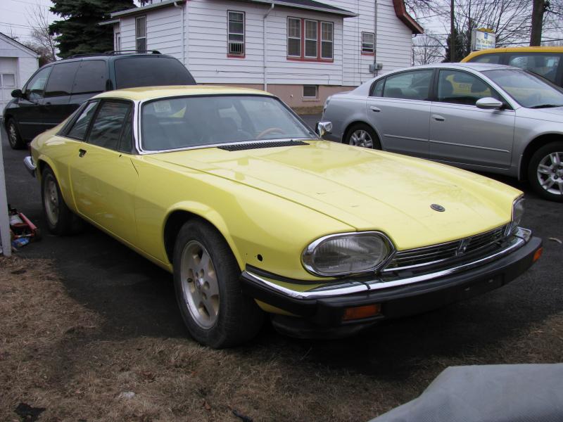

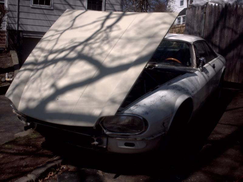

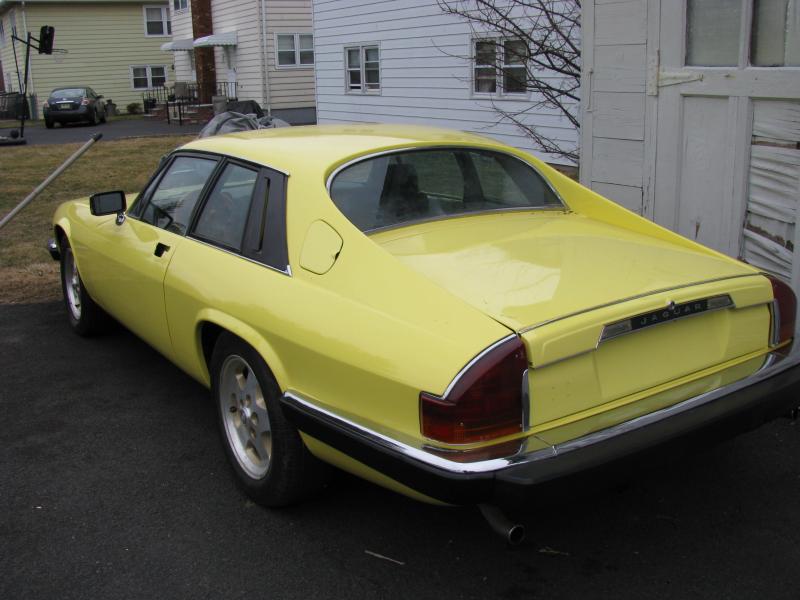

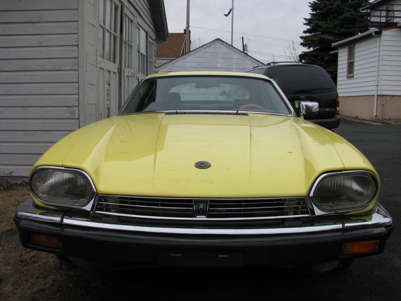

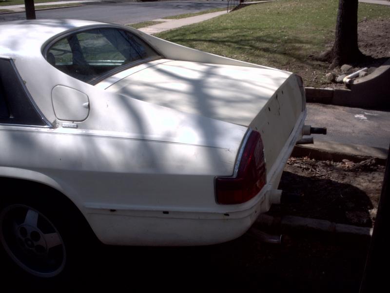

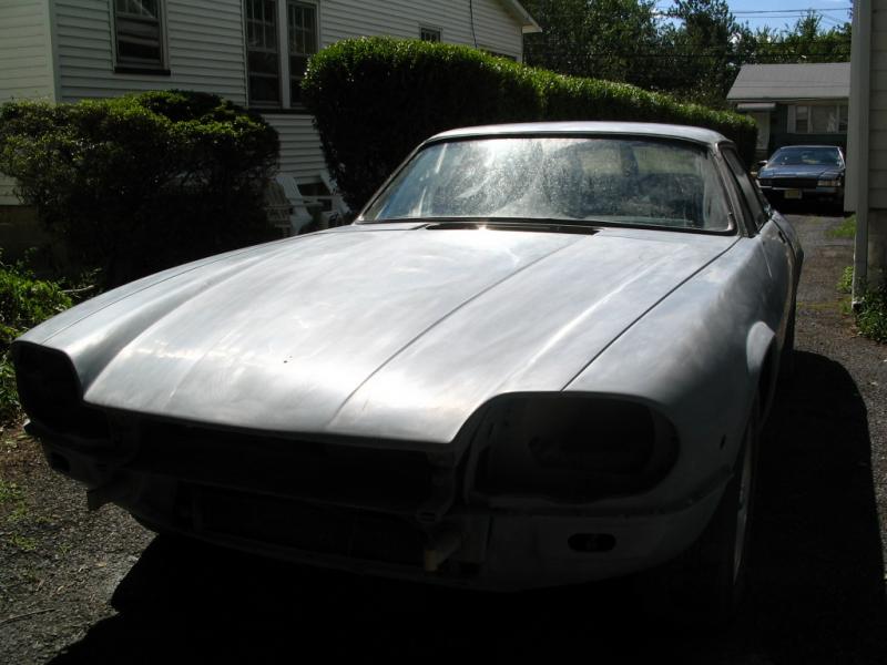

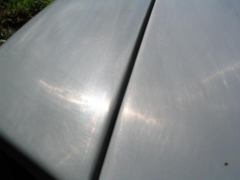

If I can upload enough of the pics, I'l tell a little story of the car. Here goes. The car was originally white with one foot in the grave. I bought the car for $800. I did extensive bodywork on the car for many years off and on and eventually got it to a finished (ready for paint) stage. I then went to Maaco and had them prime the car over my primer, sand it and apply a single stage, with epoxy hardener added to the urethane, light yellow paint. I lined up the otherwise poorly fitted panels the best I could. I re coated all the rubber with bumper paint and re chromed the bumpers. To make a long story short. A lot of parts were replaced and the car is a great driving, stopping cool running highway car. I turns heads everywhere. It's not completely done in these pics. I'll send some most recent pics shortly. Bud
