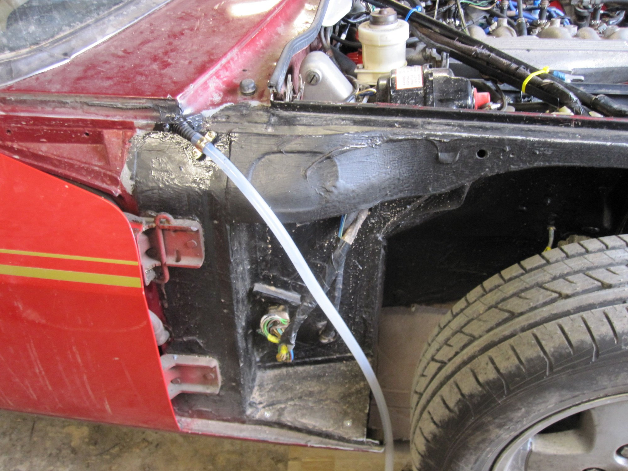

general layout
general layout

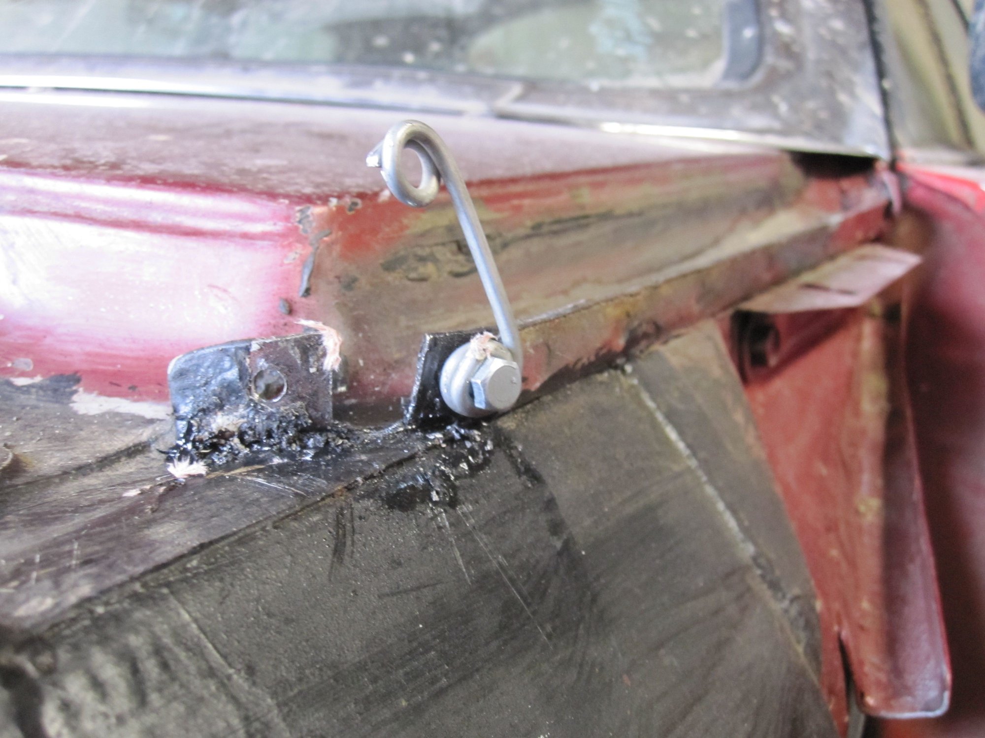

drain tube held in place by bridge-type fixing

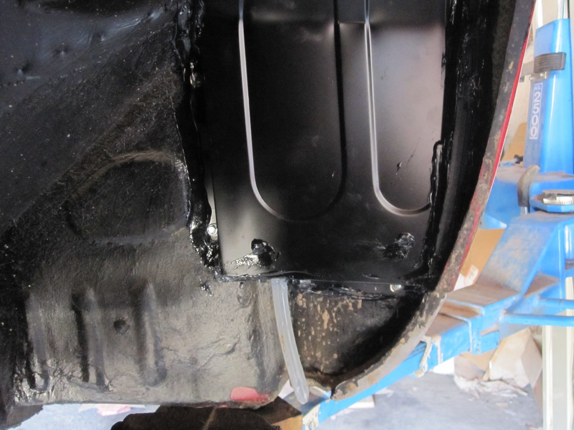

drain emerges from bottom of wheelarch baffle

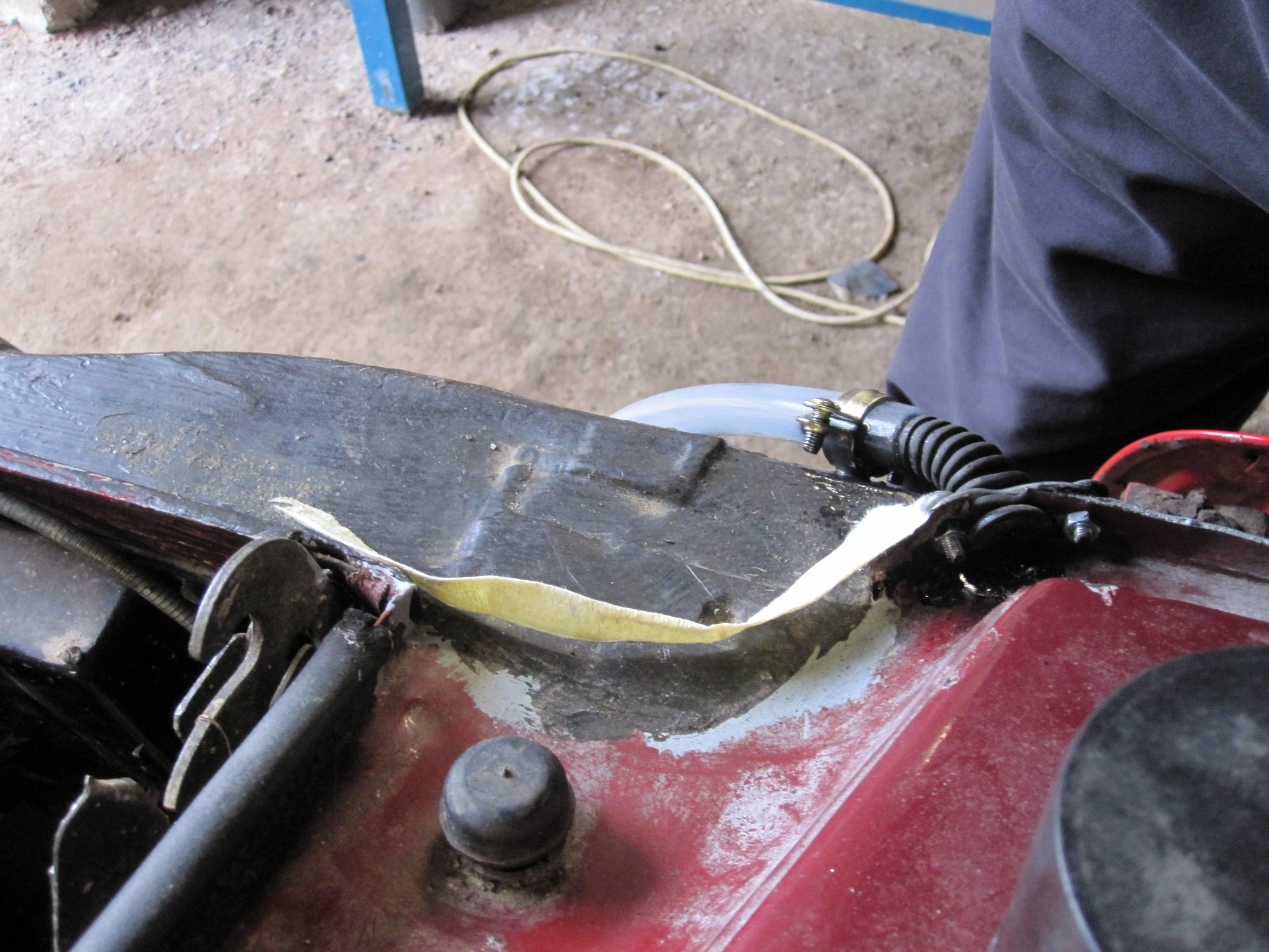

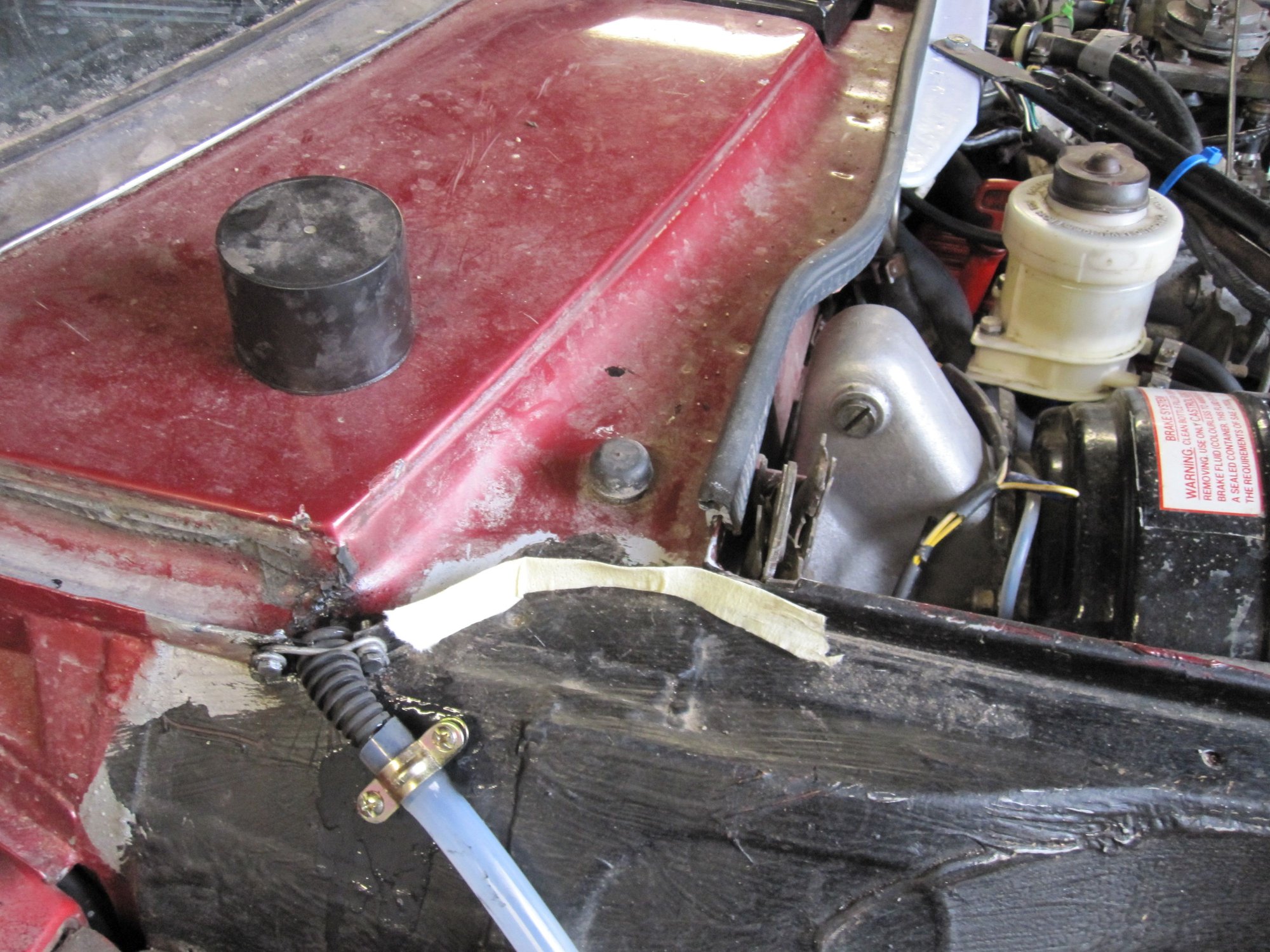

hole cut on OEM water diverter to secure drain tube
gunk dam to stop water running down the rail and under the wing fixings.
gunk dam to stop water running down the rail and under the wing fixings, so it goes into the drain.
