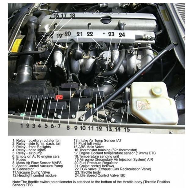

Depending on the year of your car, 96 with the AJ16 engine, you'll have a Headlamp Relay Module mounted on the left side engine bay. Small black box. Your stalk controls the output to the headlamps for low beams, high-beams from here. There is a PC board with several rely inside. The relays can stick or the solder traces can break or lose contact. Taking the box apart is not hard as you'll have to remove the rubber potting near the connector and slide the innards out. There has been sucess at re-flowing the solder joints.
I have to do it to mine. Low beams work as soon as I turn the lights on but sometimes going from ow to high and back to Low, all headlights will go dark. I will have to keep at it or bring them back to high. Eventually, they will go to low and will just keep it there for the rest of the trip. Because our facelift cars headlight system works on a "momentary" ON and momentary OFF principle from the stalk, it engages a "toggle" logic in the module. So one pull turns on Hi beams, another pull, back to Low beams. In the earlier cars, the high and low power ran directly through the stalk lever, forward Low, back toward you, High.
The modules can be procured but are very expensive I heard.
See photo of where the module sits n the engine bay: Item 12

Assuming that Jess is talking about his 1989 XJS, there is no control module
