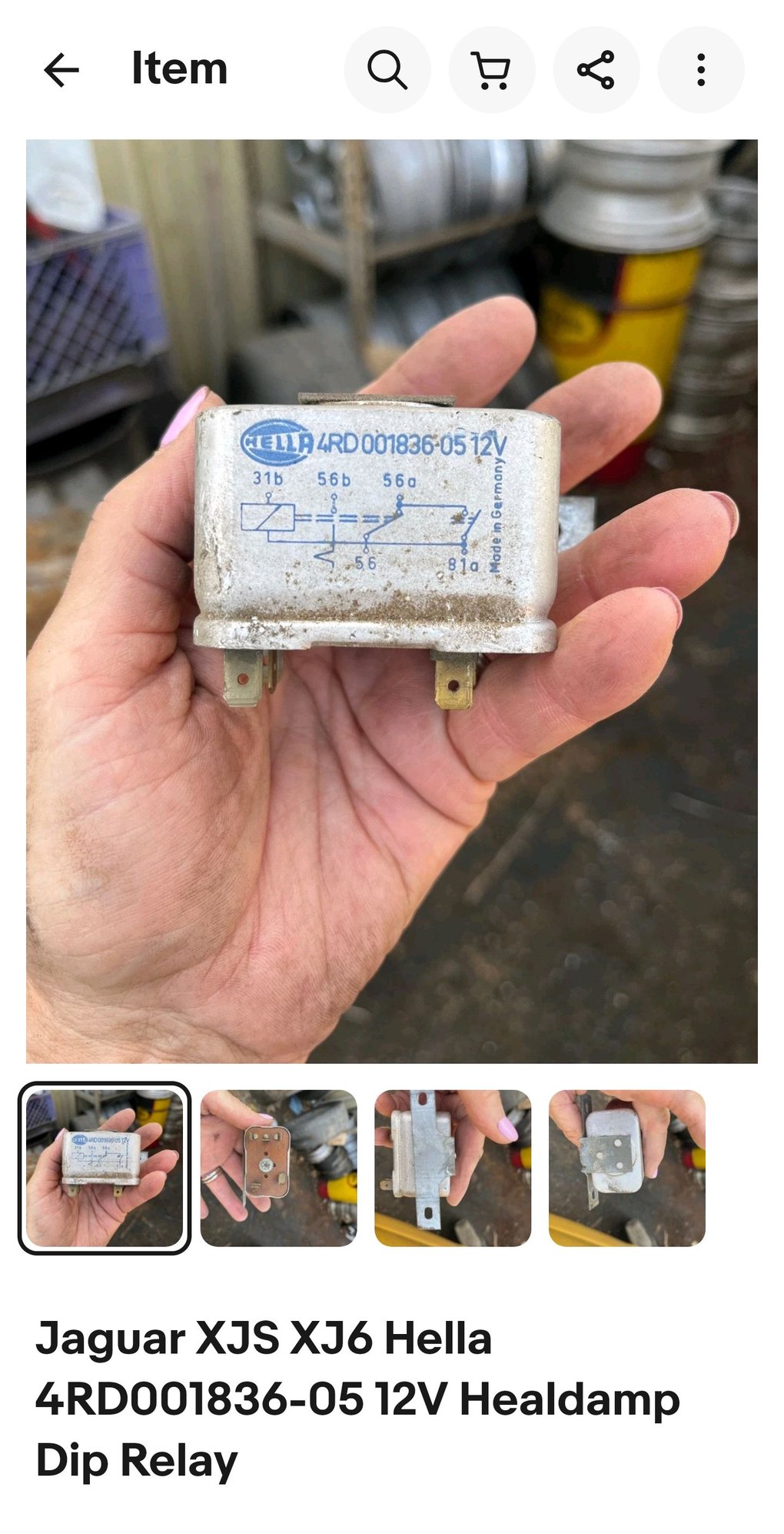

I've replaced the Jaguar XJS Hella 4RD001836-05 12V Healdamp Dip Relay under the black cover and got the same results.

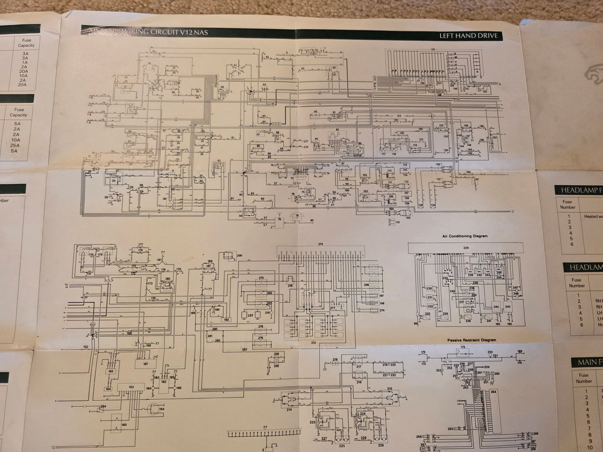

this is what I have.

The attached pdf is what you need.
