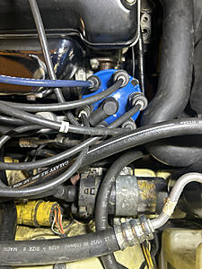

As you can see, #1 points directly to the radiator hose elbow. How to adjust Jaguar XJS 3.6 Inline 6 Ignition Timing?-photo942.jpg the cap is keyed so it will only go one way and the clips are about 2:00 and 8:00. The firing order is 153624 clockwise.

So only thing i have to do put the pistons in right order and adjust distributor to start from #1 am i right?
