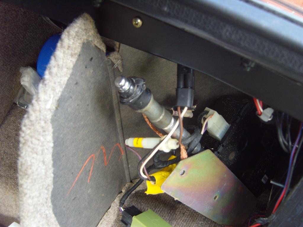

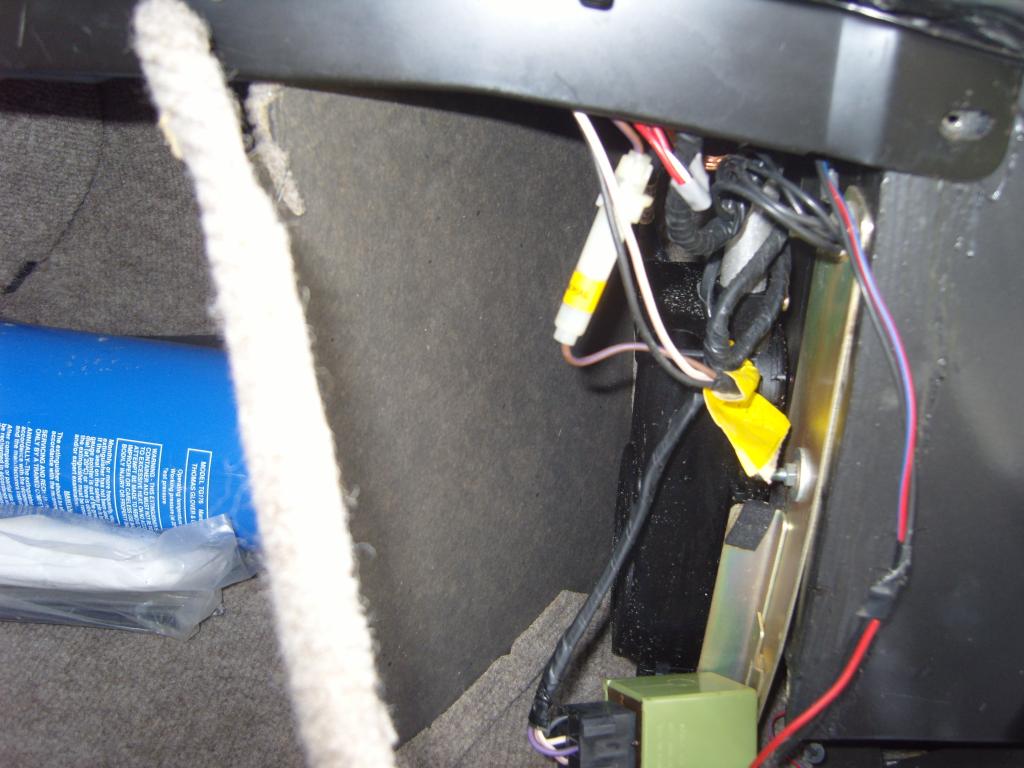

Removing the Aerial

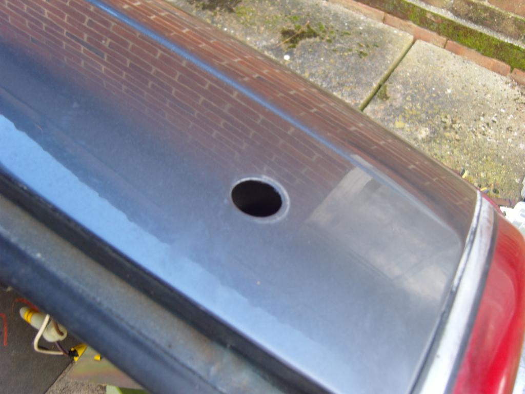

After this Pic was taken, I cleaned up the hole and then smeared it with grease.
