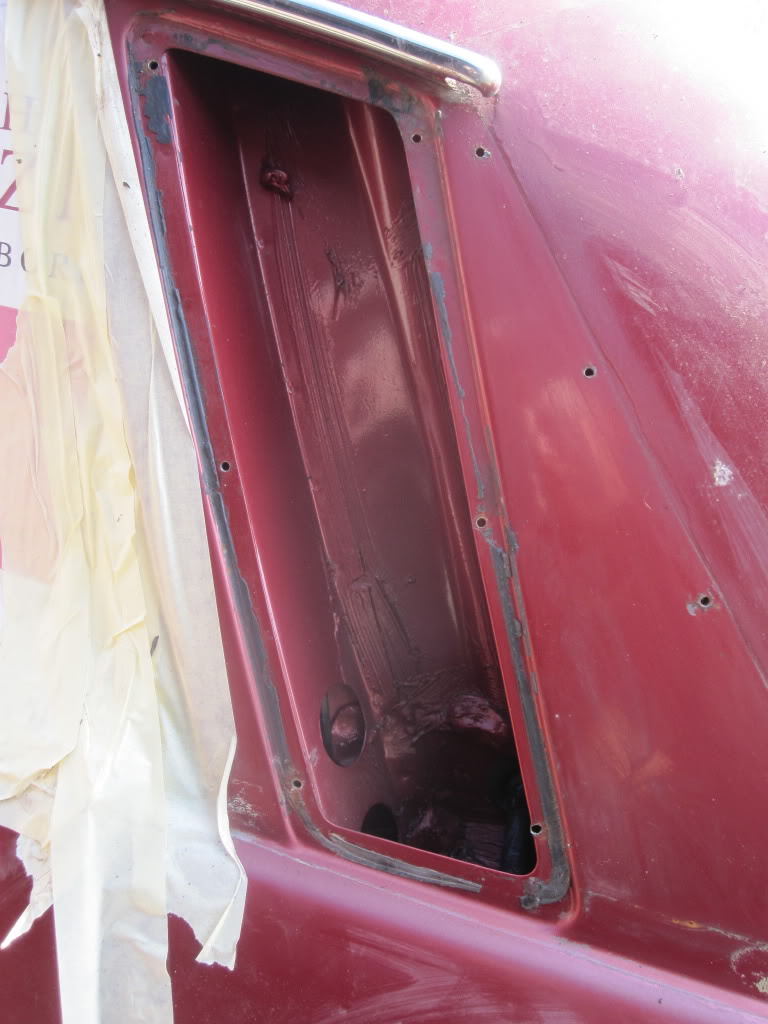

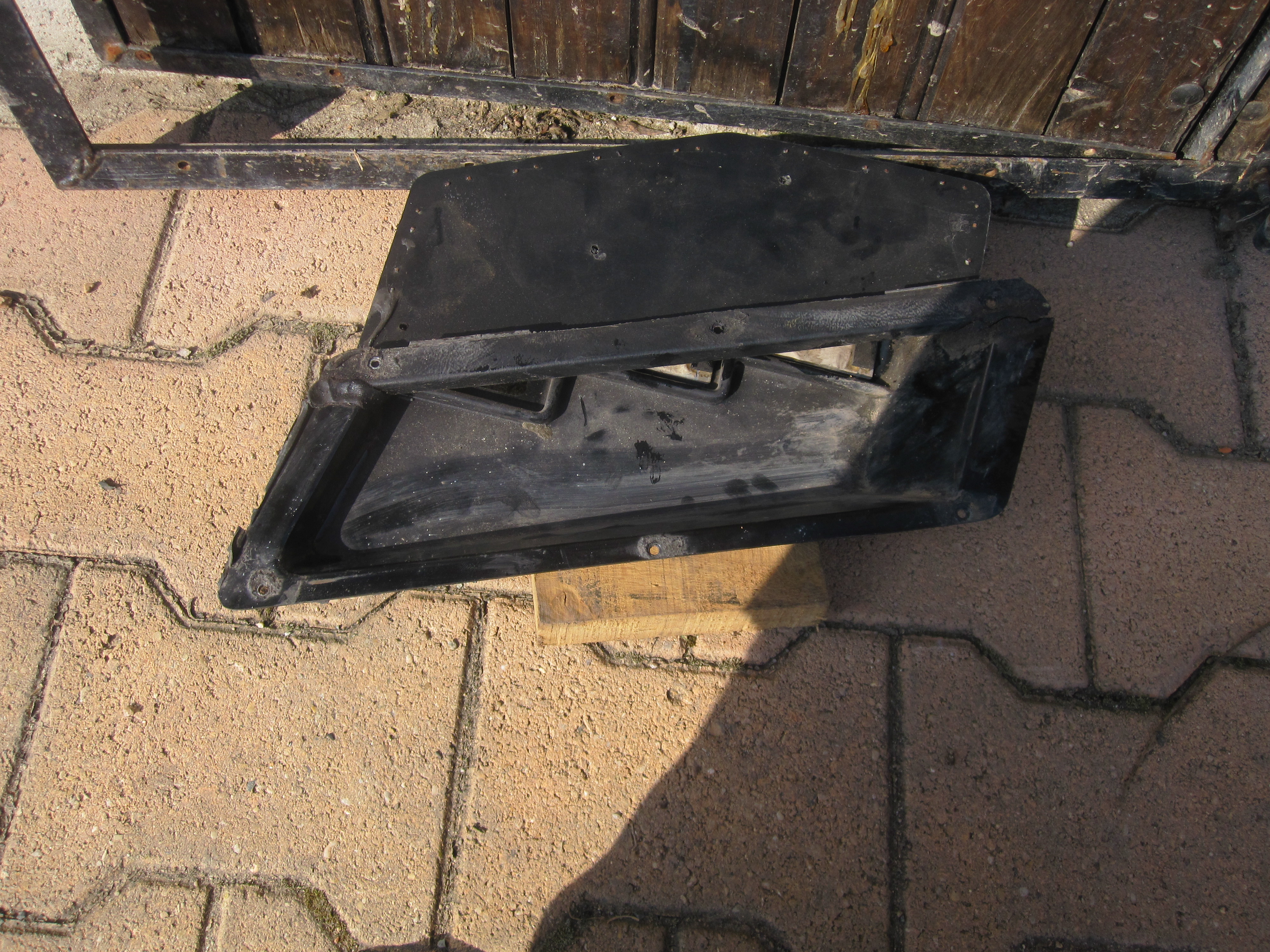

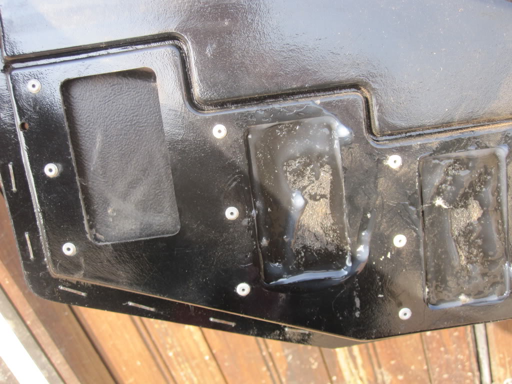

Under the black panel you will find an idiotically complex plastic flap unit arrangement, also pop riveted in. These flaps form one way air exit passages. After a bit the foam damping fails and they rattle infuriatingly. I stuck two of them closed and removed the third to make a permanent air exit. Absolutely fine.
While in there, you have pretty decent access to the cavity between the wheel arch and the outer panel. Strongly recommended to use a garden sprayer or an airgun of some sort, to blow rust killer and antirust stuff in here. It must be thin, I used AquaSteel, followed by wax. Some photos attached. Good luck
