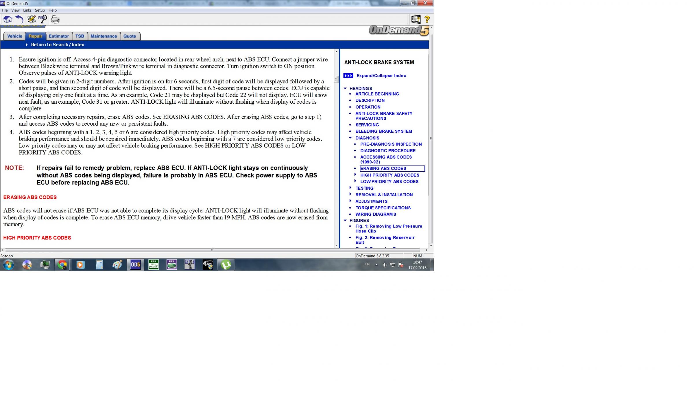

Accessing ABS codes

Originally Posted by xjsv12
Accessing ABS codes
I'm not sure if that will work for my '90 but I will give it a try. Do you have the section where it explains how to clear the codes and reset the ABS ECU?
Thank you!
Mark

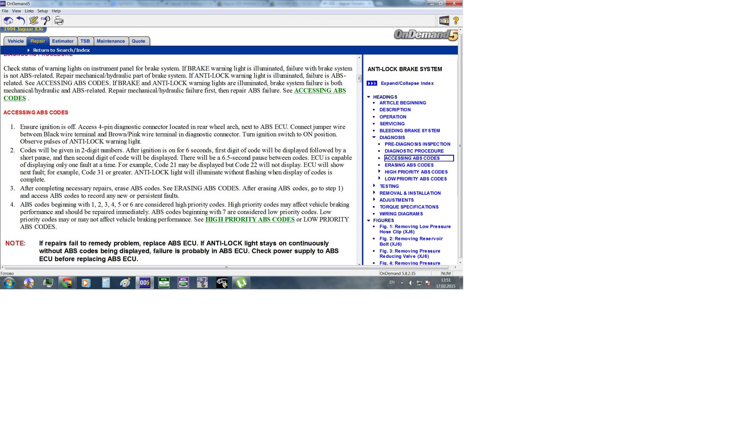

look

All years with teves ABS is the same

Some good progress today. The information provided above allowed me to get the fault codes.
The only code so far is a #32 - Right Front Wheel Sensor.
I did not have time to get under the car today but I will do that this weekend. Hopefully it will just be a dirty connector. These sensor look like simple coils so I should be able to measure the ohms and compare it to a good sensor.
