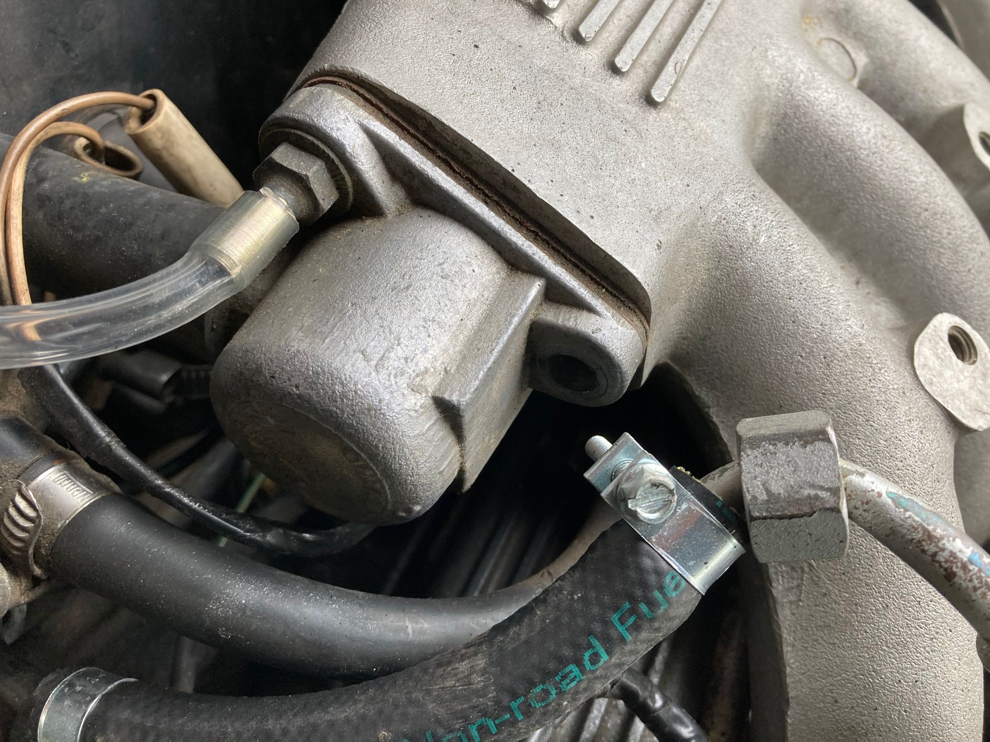

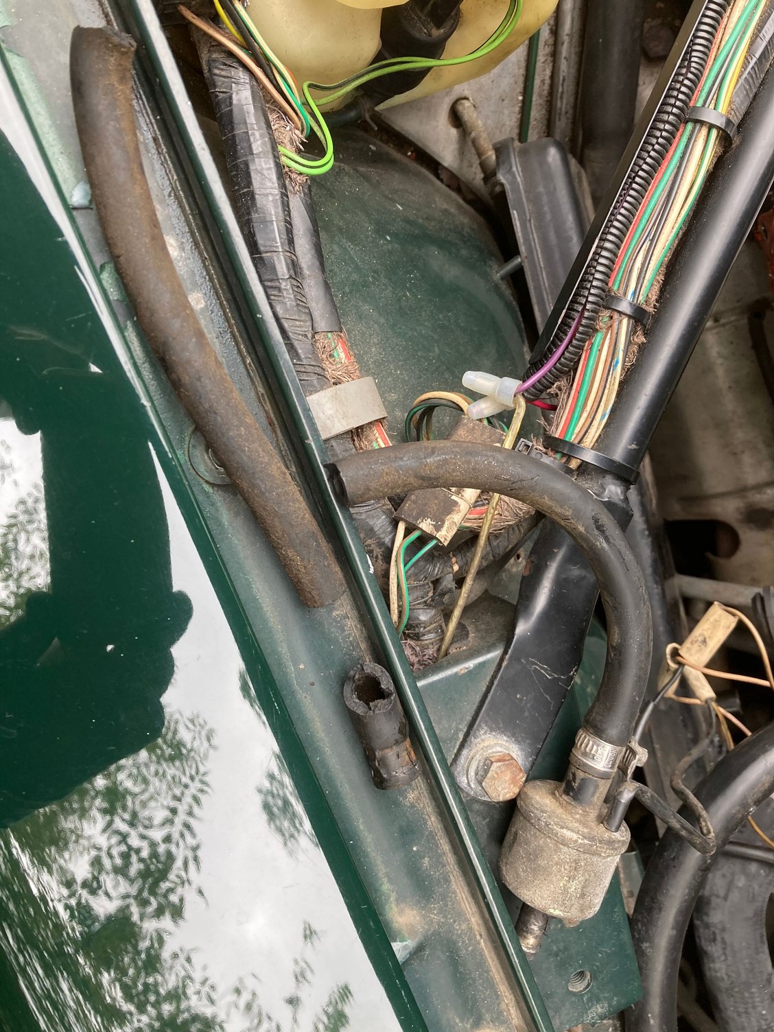

well, smoke tested it today. Lol it’s unbelieve how bad the vacuum leak was and how I never looked before... Whoever had it before me, completely removed the vacuum screw on the right side and nothing is connected to the nipple on the bottom. Plugged those holes and did it again. Then the hose going from underneath the intake to the right airbox(runoff valve?) was split in half. Haha I’ve never felt this car as it should be! It now idles perfect if not too low and can coast to a stop. It usually wanted to run about 35mph with foot off the gas. I’m feeling really dumb.
I wouldn't feel 'dumb' or bad about anything at all. If anything these cars are great teachers.
I've been learning that listening (can be hard when the idle is high) is a good way to check for leaks. THAT and a giant can of brake cleaner. Spray it around the manifold and air intake areas and when the gaseous fluid is sucked in, the car will sputter, if not stall completely... That second photo is a supplementary air valve. It kicks open (when everything is working correctly) when the AC comes on to bump the idle up just a lil lil bit for added load. Works good when working... The hose runs kinda close to the RH manifold under the intake and gets heat, drys and cracks or, worst case, melts.
Had to be a air leak you were dealing with.

the rubber turned into plastic from the heat

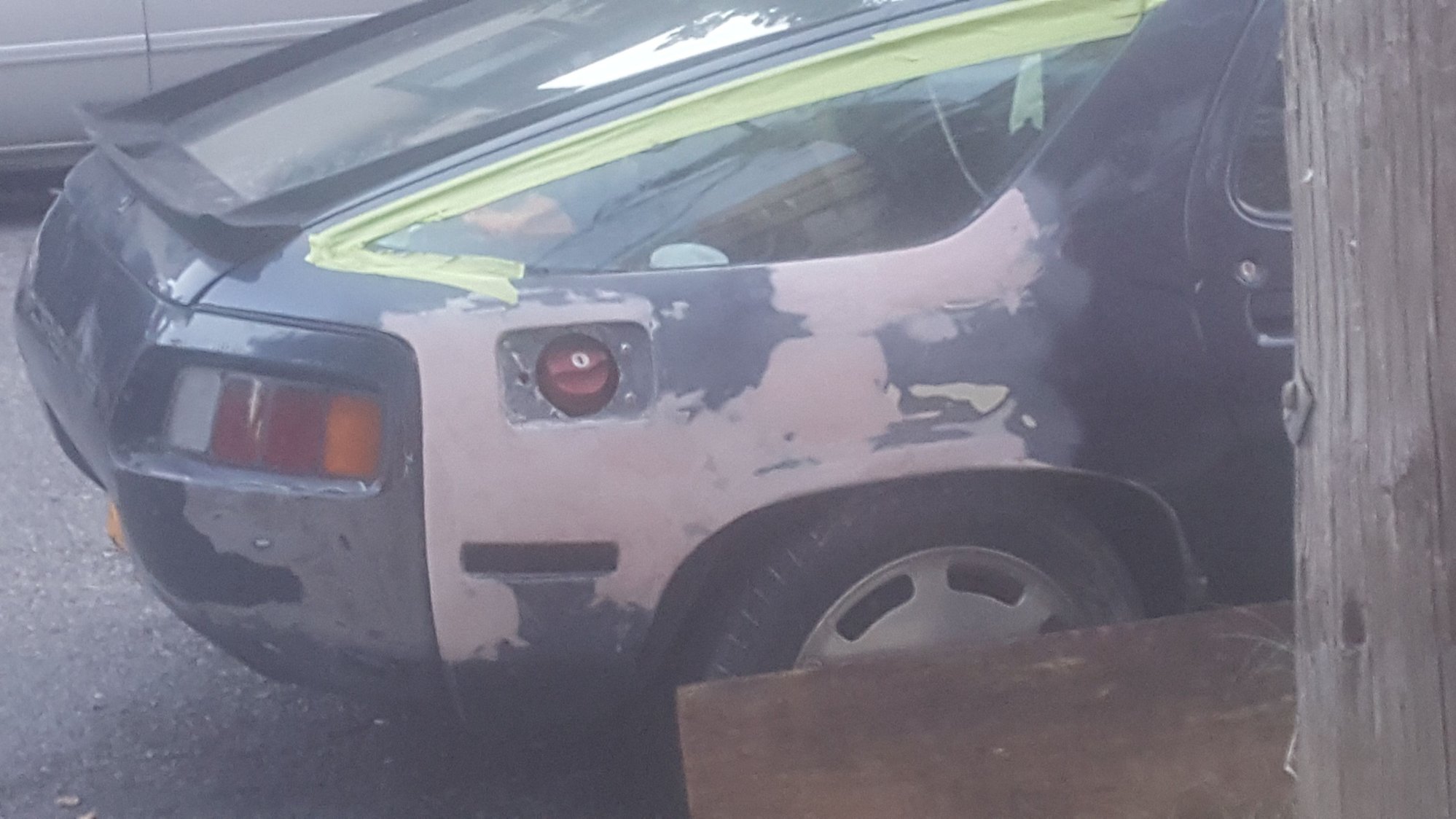

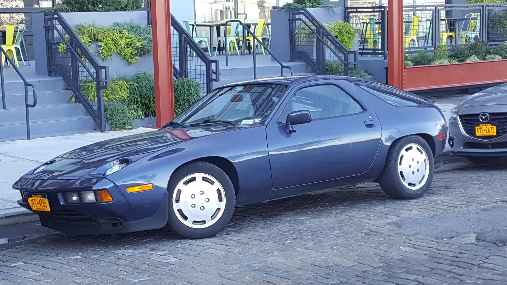

By the way, do you have a 944?
Don't cringe... Well ya can if ya want, I did.
My early 928 attempts at body work. Luckily a body guy screamed,,, drop the paper and back away. He's an enthusiast and is gunna take over for me for a small fee...
Ol BooBerry...
She can be purrrty...
