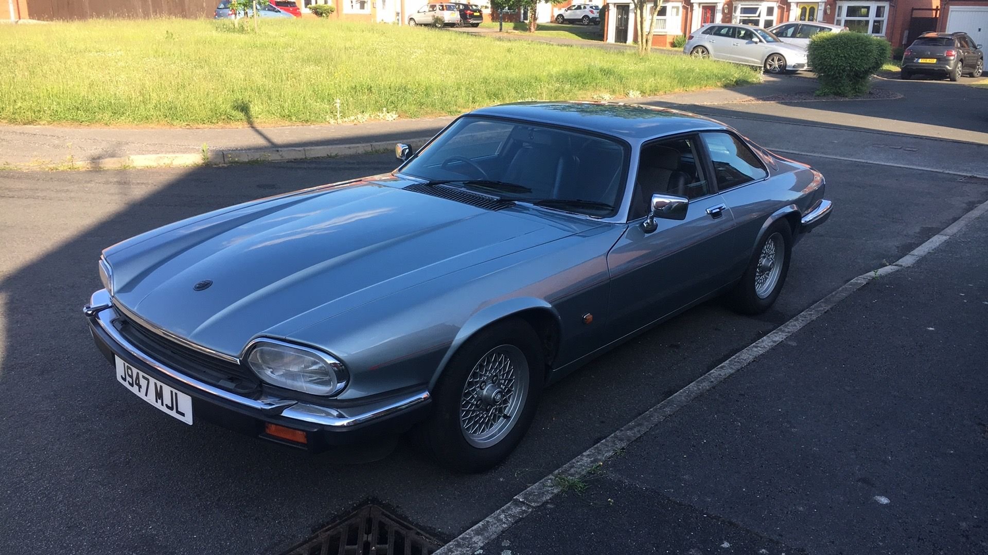

I'm based in the UK, bought a 4 litre '91 facelife coupe in November last year, had a great time getting to know it and wafting around. It's a Japan spec and spent most of its life out there before being re-imported a few years ago.
Couple of issues resolved so far - despite being fairly well prepped by the dealership I bought it from, they stopped short of actually replacing things, so it needed shock bushes and bearings doing (absolutely transformed it!), and the dump valve on the cruise needs replacement (not working when I bought it, but following advice online I blanked off the dump valve and then it worked ok, so need to replace that for it to be safely useable).
However, after a good run a few weeks ago it has not enjoyed sitting unused and is struggling to start (I think this is my error in letting it sit for most of winter without a trickle charger on it, and I'm not sure how old the battery was but seems it's on its way out). When this first happened, I stuck the battery on charge overnight and then seemed OK for a few days, but left it a few more days without use and it was back to a no-crank condition.
