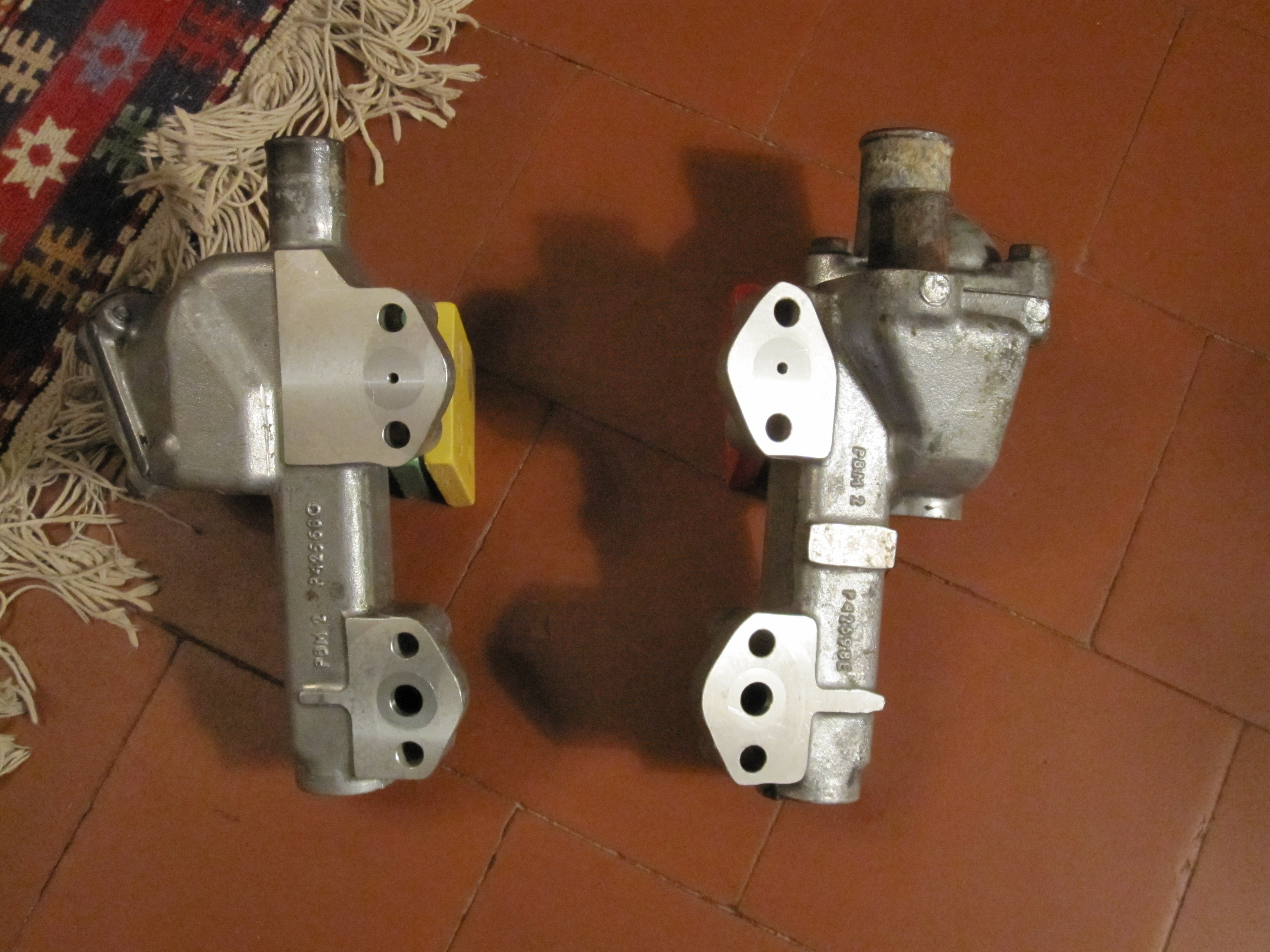

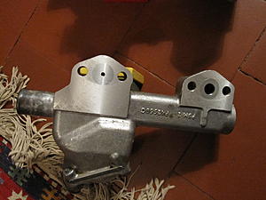

Re the Lutz mod, which I have done and believe in, here are my thoughts and findings:
6802 II Dual Channel Digital Thermometer with 2 K-Type Thermocouple Sensor Probe | eBay
and tape the probes to thermostat housing exit to the rad and from the water pump intake casting. Then run the wires to the cabin though the doorframe rubber seals and take temps on the on the move from the cabin. Assuming the cooling system has been properly serviced, I am prepared to bet that the top hose rad intake temp is never above 100 C and the rad intake temp never above 90 C, even in the most extreme conditions; while usually they will be much lower. Of course real V12 aficionados can install permanent temp sensors in both thermostat outlets and one in the water pump intake, with a switchable digital interface in the cabin that reads them as selected! But the temp probe will reassure you more cheaply and with no bother.
- The theory: The exit holes from the heads to the water manifolds (and thus to the thermostat housing and the radiator) are all the same size front and back of the head. Therefore there is a tendency for water closest to the pump to short-circuit the engine, and preferentially flow out of the front part of the engine exiting through the front part of the heads. Thus, the theory goes, the rear of the engine sees less effective coolant flow and so runs hotter than the front.
- In racing conditions this is undoubtedly true, and all V12 racing teams paid great attention to getting water flow though to the back of the engine.
- The theory is ALSO true in normal road engines, I believe. However, the question is: does it matter? Well I did about 100,000 miles in my car BEFORE I did the mod, with absolutely NO problems at all. So have thousands of other V12 owners; so in the real world it probably does not. However, it seems a very good idea to promote even cooling across the length of the engine, so that is why I did the mod!
- The Mod (as invented by Norman Lutz the famous Australian engine builder, who is also helping our own Warrjon with his engine): consists of reducing the diameter of the holes allowing water to exit the head into the FRONT water manifold and thus back to the radiator. In this way pump pressure forces more water into the back of the engine, thus equalising the actual flow volume between the rear and the front water manifolds. (see attached pics of the modified front water manifolds, clearly showing the original and modified hole diameters. Norman Lutz gave the required diameters to equalise flow).
- Gauge temps: I "proved" to my own satisfaction that water flow WAS preferentially short circuiting the engine on my car (even if, see 3 above, it may not/does not matter!) because as soon as I did the mod, the gauge temp showed a bit hotter, and the needle immediately sat almost on the N rather than below it. You would expect this, as cooler water is being forced further back rather than going straight into the front water manifold where the gauge sensor is. So one effect of the Lutz mod to improve cooling is to make the gauge run higher! Of course, were the sensor at the rear water manifold, it would show cooler!
- Having said all that, someone on the forum, and I have forgotten who to my shame, actually did install proper gauges in both back and front water manifolds, with no Lutz mod, and found the water temps within a degree or two the same!
