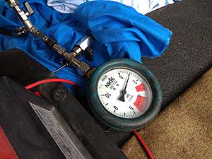

Hi, today I did a new test with a pressure gauge.
initially it was 2.5 atm, but after 25 Km the ploblem is back and pressure gauge was like in the picture (1 atm).

Old Mar 9, 2018 | 11:36 AM
Greg in France's Avatar
Posts: 14,571
Likes: 10,770
From: France
OK
So it is fuel pressure. This is what I would do:
  • Change the flexibles to the sump tank and from the sump tank to the pump (14 and 19).
  • Change the main filter (behind the spare wheel) EVEN IF NEW. Make sure it is connected the correct way (there is an arrow on the filter which should go into the pipe going TO the engine, NOT the pipe coming from the pump).
  • When the filter is off, undo the fuel feed to the injector rail in the engine bay and blow out the fuel feed line to the engine with compressed air.
  • re-check the inside of the sump tank (undo 14 and 15) and make sure that the metal pipe is not blocked and that the filter (18) is clean.
Good find on the fuel pressure. If after the above it still happens, change the pump.
I believe you have already changed the fuel pressure regulator? If you can try a new one there too, it would be a good idea, and it could be (just could be) the FPR is giving up when the engine bay gets hot.
Greg
