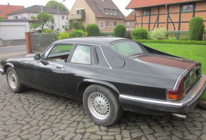

Hey Folks
Im new at this forum. I have a problem and i`d like to ask you guys for some opinions. So i want to buy this Jaguar XJS 1984 3.6 Oil . Its in UK. The Steering Wheel is on Right side. I made some research on internet. I live in Romania and i need Wheel steer on Left side of the car. So you guys know which parts needed to change for this operation, where to find parts, and costs?
Please help me with this problem , im looking towards to make this operations if the costs are how i imagine )
Thanx a lot

I am sorry to say you should forget the idea. Why not use it in RHD form in your country? Incidentally, the photo you show is a LHD non-UK registered car, so it is not the car you describe !
You will need a new dashboard trim piece, new dashboard loom, new steering rack, maybe new engine/cabin loom, and these are VERY hard to source in mainland Europe or in the UK.
Greg

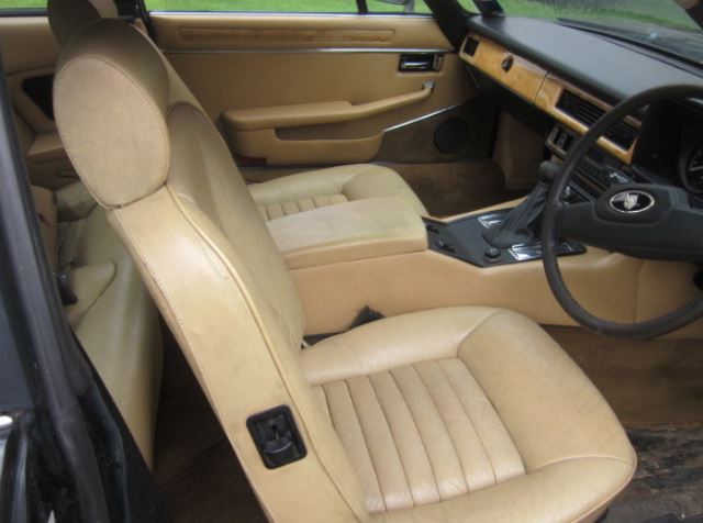

This is the car
