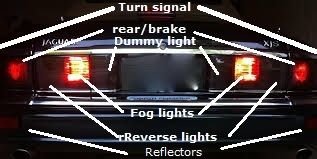

in canada rear facing white lights is illegal on road

I think rear-facing white lights would be illegal in all countries, except for reversing lights.
The rear fog lights in the photo shown are not white, they are bright red, but just look white in that photo.
