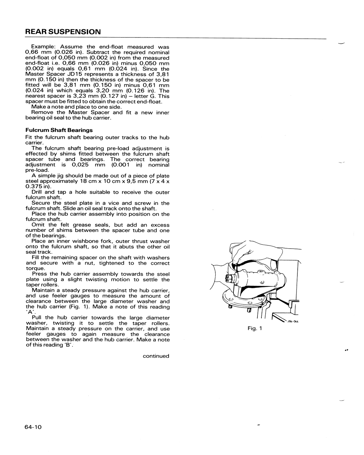

The hubs will work, it should be a straightforward swap of the hubs.
You will need to set up the bearing preload with appropriate shims, but that is the same procedure for all IRS rear ends, so plenty of information over at Jag-lovers in the E Type forum about how to do that.

Here is the setup from a 1985 manual:
