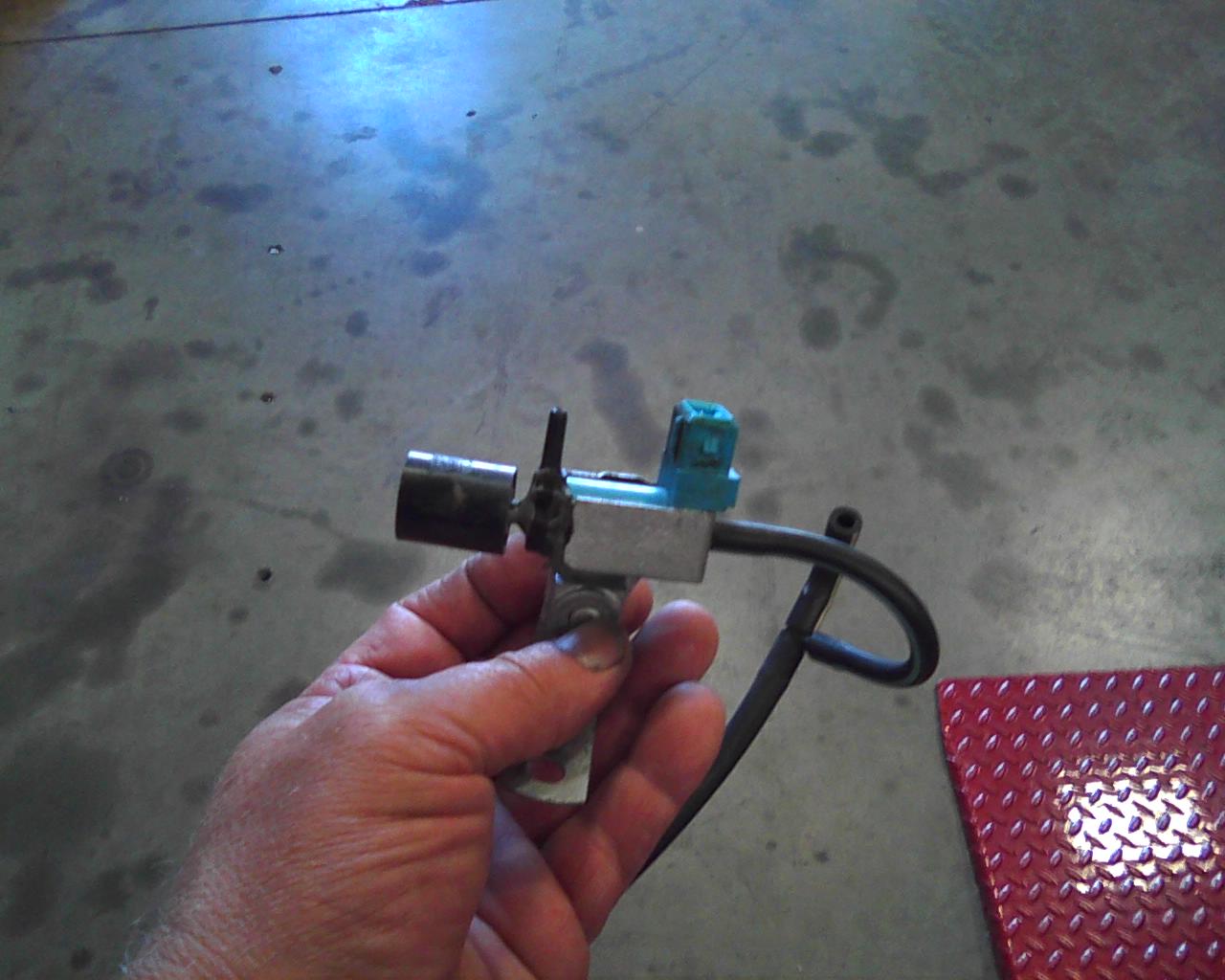

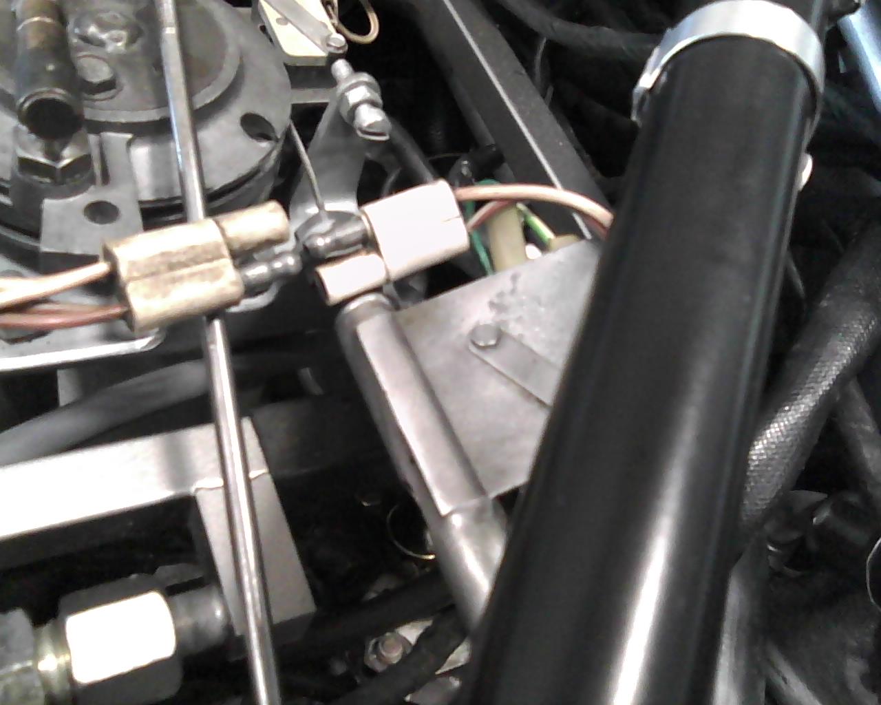

I can't find the original posting but I'm 99% somebody was asking about a mystery connector. This is a two-pin connector just aft of the throttle turntable and above the big balance tube. Brown/slate and pink/white wires.
I think I figured it out. It goes to the Supplementary Air Valve (backside of RH air filter housing) and the Solenoid Vacuum Valve (blue widget at rear of RH inlet manifold)
I discovered this as I near completion of my '88 V12 project
Hope this helps
