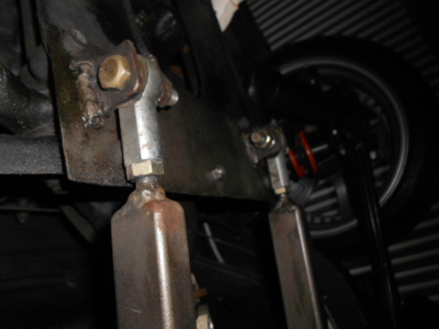

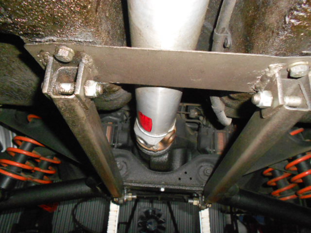

my 1978 XJS came standard factory with 3.07 ratio powerlok(not the 2.88) , so my diff is stock original, when i had it apart i took the ring and pinion gears to a local diff. shop, guy looked at them and went in back supply room ,came back with a set of gears , made some measurements, and said there you go ,3.73 ratio fits a JEEP truck,i fit them into the casing with new bearings &seals. i use a standard HD GM yoke on pinion input shaft,Aluminum driveshaft, less rotating weight!
