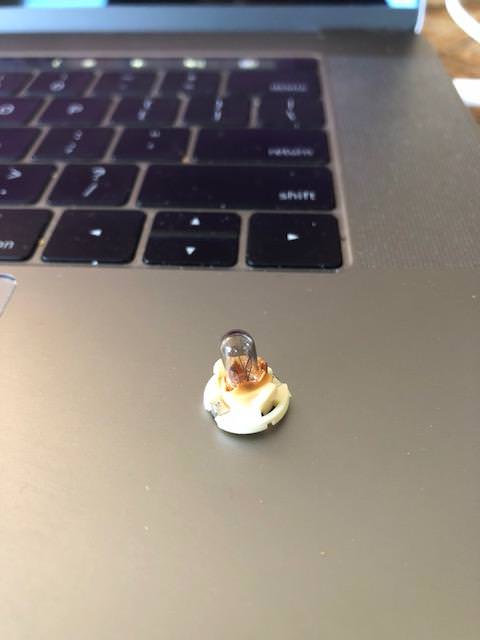

I've been over every post I could find, which is how I was able to extract the bulbs from the trip computer. But now I'm stumped. I removed this "fixture" that the bulb appears to be soldered into.
When I found the part number for the bulb I found "LHD5180AA" which goes to a bulb that looks nothing like what I have removed.
https://www.terrysjag.com/SEARCH.html?Search=LHD5180AA
And before anyone asks, no LED's please I despise them. I just want to replace the original bulbs.

The bulbs are integral with the base. It's called a neo wedge bulb and come in different sizes that start with T, such as T3, T4 etc.
I'm sure an internet search will turn up a chart of sizes and you can compare to your existing bulb. They are fairly common in the auto industry for switch and dash lighting.

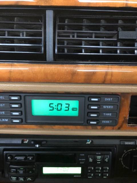

All done.
