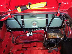

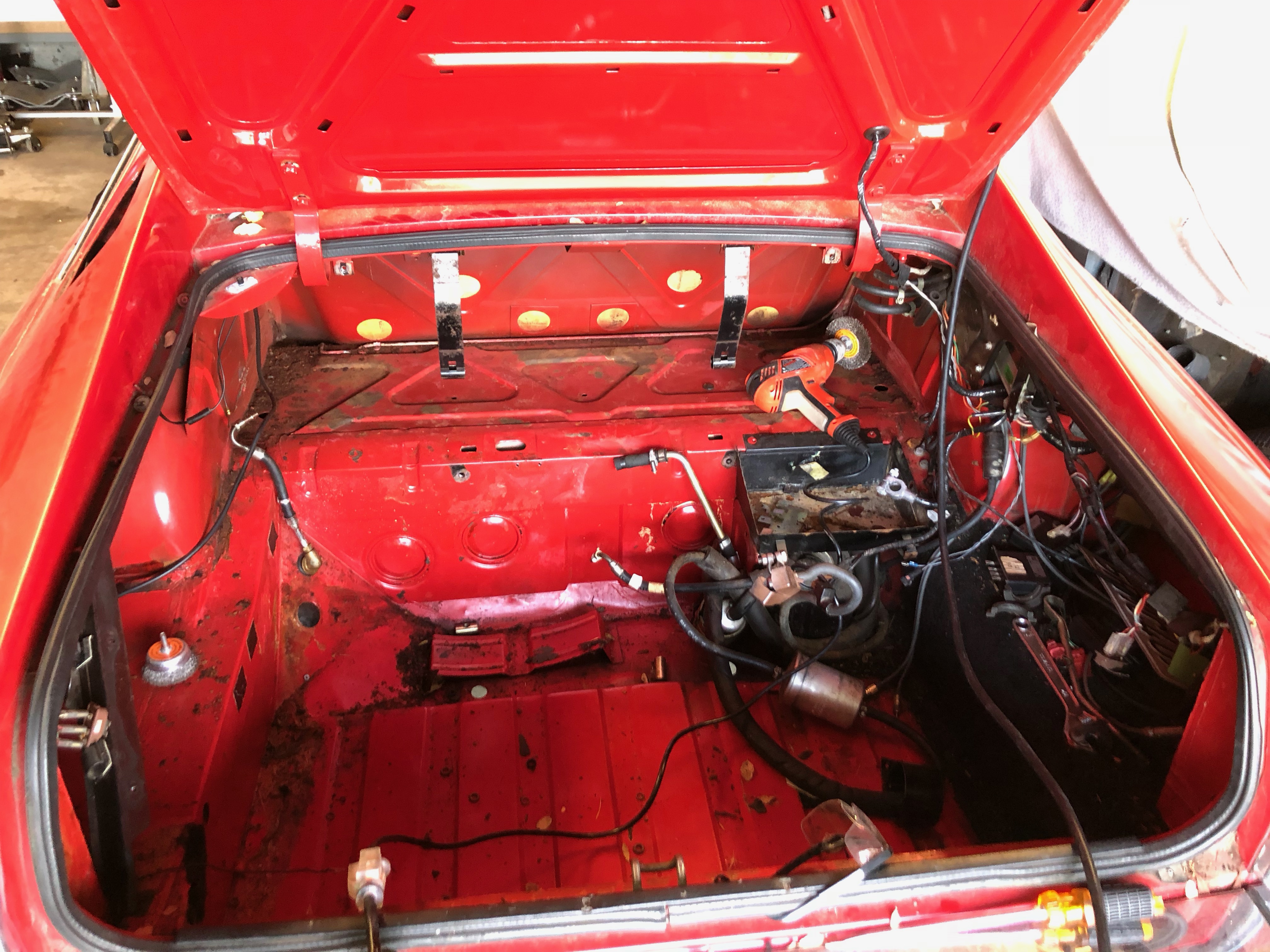

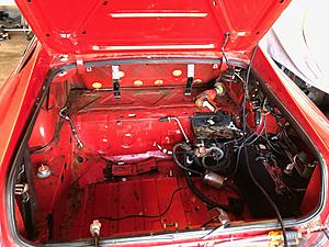

Today I started the removal of my "leaking from somewhere" fuel tank.
I picked it up at SNGbarret. Although the hose fitting are different on the tank, ill be making a phone call on Monday, to hopefully get the correct new hoses.
Removal wasn't that bad at all. the foam pads were the issue. when I got them out, it just slid right out.

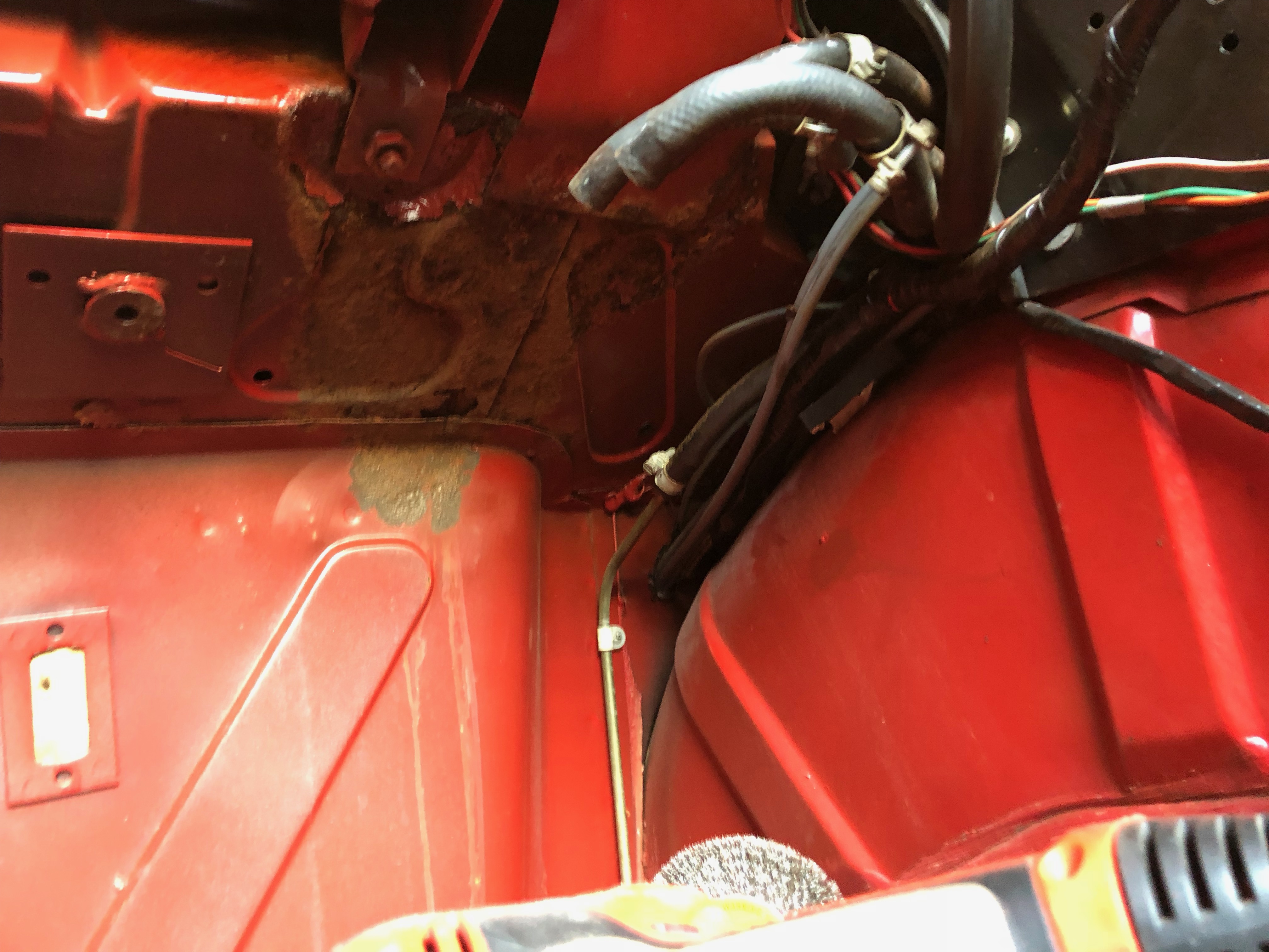

Found out it was the bottom of the tank that was slowly rusting through.
I have a fair amount of rust on the top right of the inside. the plan is to clean it all up an por15 the whole area. and the bottom of the new tank.
Fellow member SARC came up with an idea of a few rubber feet on the bottom of the tank, instead of the black pad, to promote airflow.
as you can see in the pics, its with friends, a gourgus 35K miles 1990 xj40 "possibly for sale" and the 75 v12 coup we are slowy building back to life.
