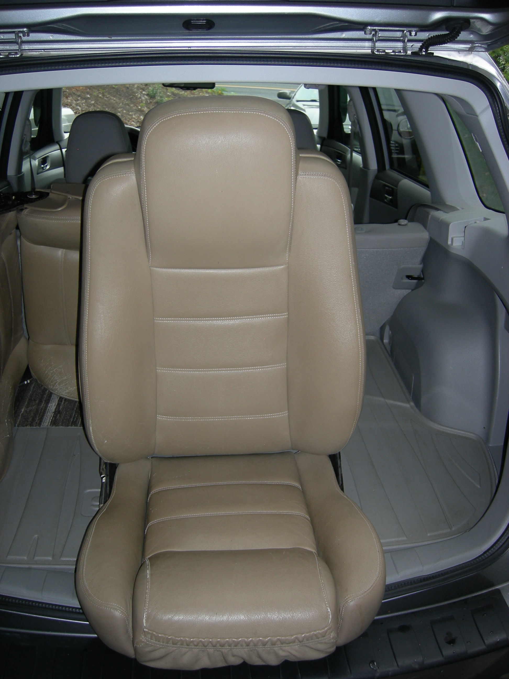

OK two pictures. The seat is the passenger seat and is in not bad condition. I had to buy the leather replacements for both front seats. I'm going to see if I can sell the leather that comes off this seat. (In the back of my Subaru waiting to be delivered Monday.)
