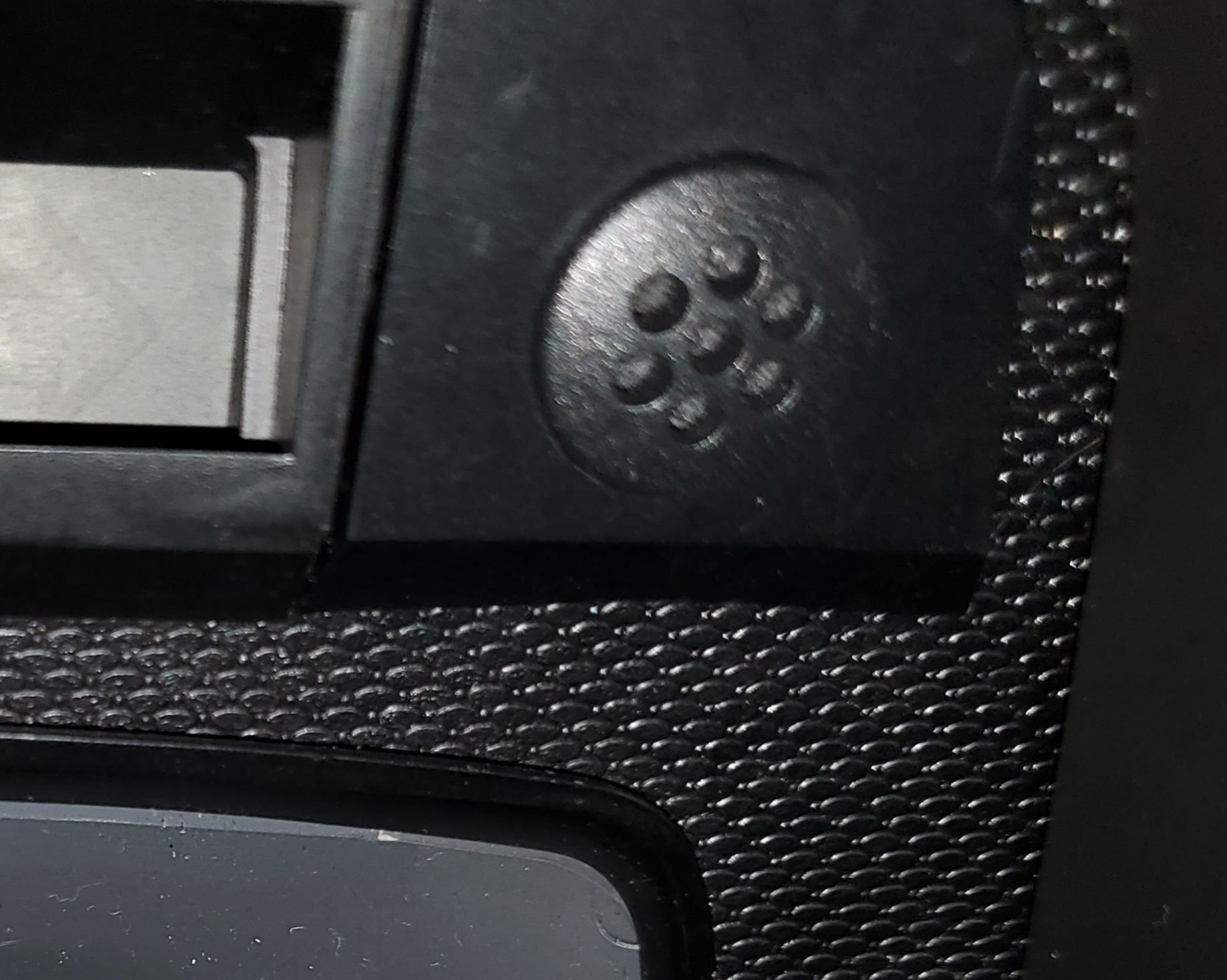

Just to close the loop on this, I hadn't come up with a good solution for the handsfree microphone installation..up until now..I dismantled the microphone body, keeping the front grille, carefully drilled a hole in warning lamp screw cover and routed cables as required. Happy with it now:
