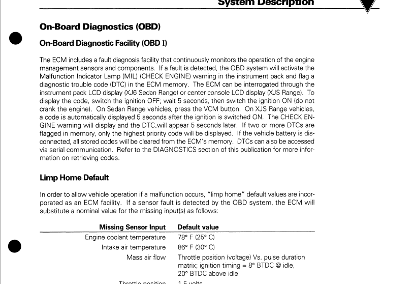

Don't the OBD1 cars output codes through the computer screen?

Originally Posted by Vee
I wonder if it would help to swap out the ECU with one from a 96?
Huh?
Isn't a 96 OBDII instead of OBDI? Either way unplugging either would reset the DTCs

Originally Posted by sidescrollin
Huh?
I thought all the AJ16 engined XJS were OBD2. If the early ones are not, would it become an OBD2 car if you swapped out the ECU for one from an OBD2 compliant car (such as 96) would it then respond to OBd2 tools?

All cars with the AJ16 engine are OBD2.
