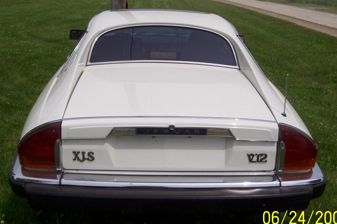

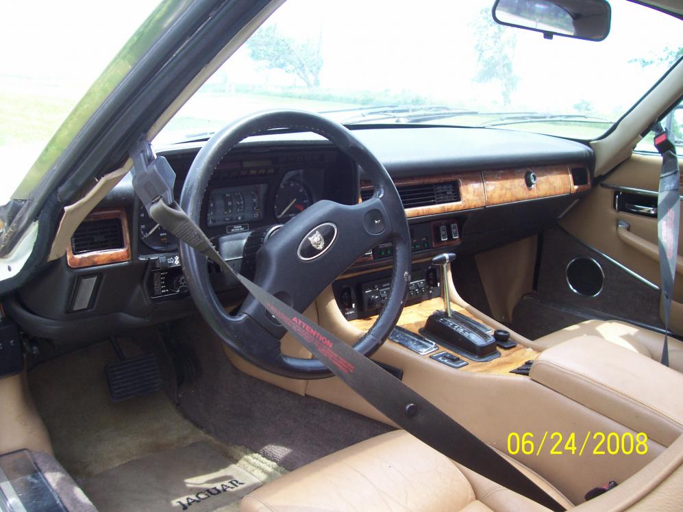

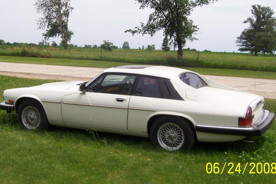

Hello all.
I am in the process of looking at a 89' XJS V12. Two owner car with 67,000 miles. Known issues:
1. Pass door will not open, from inside or outside.
2. AC in-op.
3. Headliner coming undone.
I am currently with 2 other fun cars that I enjoy turning wrenches on, a TR6 and Porsche 928, so I will be more then willing to dig into any issues and deferred maintenance that comes along.
Right now, all I have is pictures and a story.............I plan on seeing the car in person in a week.
Are there any key things that need to be looked at with the XJS?
Beyond the obvious things?
Any advise (besides Run Forest, Run...........)

Check the body lines on the pass side carefully. The door not opening sounds like accident damage. Check all the rust spots, I've seen some great looking cars in pics and then when you get next to them you see the bubbles :-(
