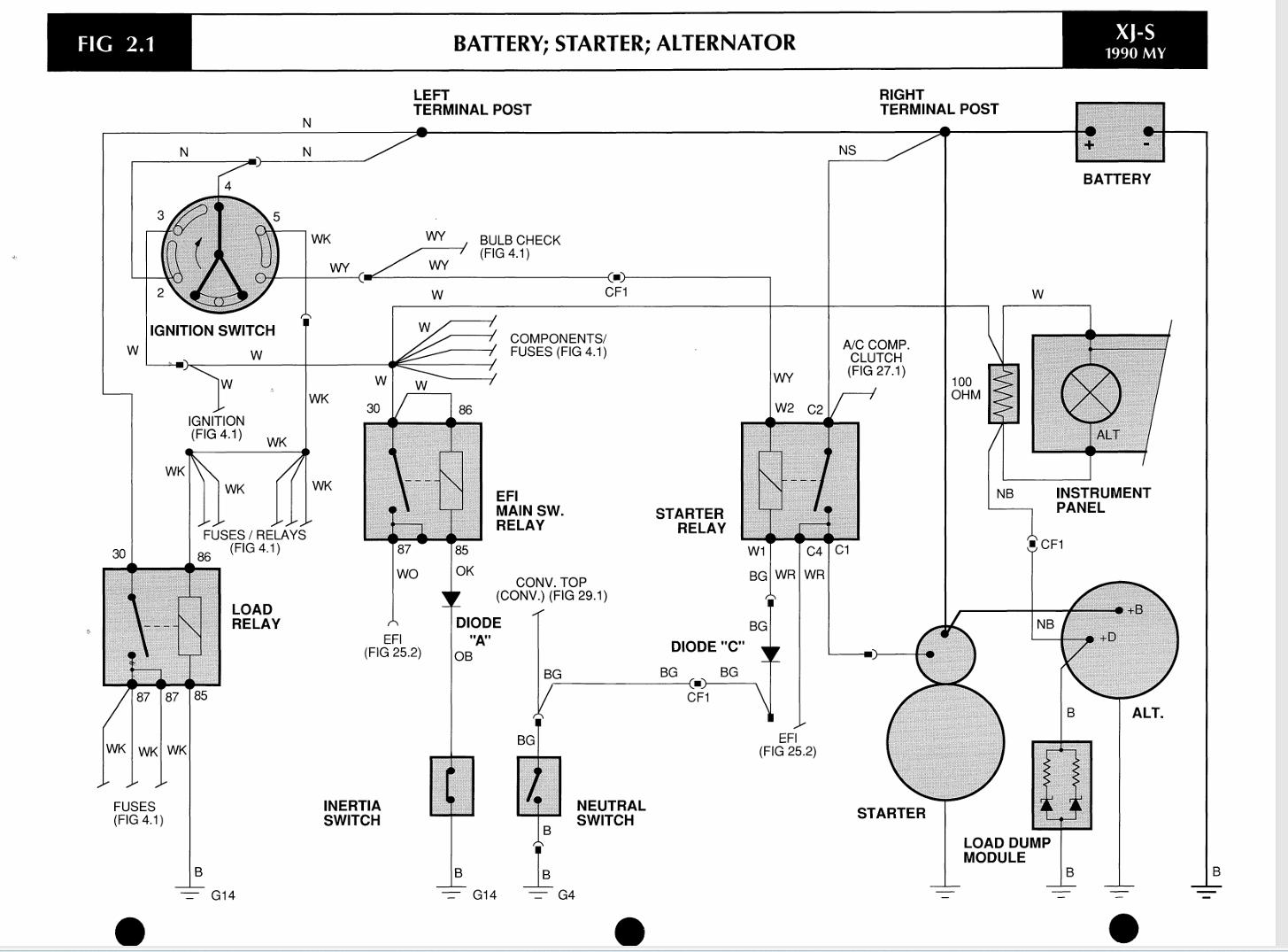

Is the dashboard warning light still non-functioning? If it doesn't work that might be a clue. The resistance from the warning light is what "excites" the alternator....although you'd think the resistor wired in parallel with the bulb [see diagram] would do the same thing.
Your car should have the dump module that grant mentioned. I never learned how those actually operate.

Thank fellas, all good suggestions. Just getting back to being able to work on things, so I'll go through some of the items tonight. The battery leads are very new as well as the battery, so I can rule that out. I agree though, many times on other vehicles it has been just that simple. I've considered the harmonic balancer and will try the suggested test. That would make sense if it was slipping. I do get the indicator light in the on position, but once running it still turns off (even when it's "warming up" and at 12v or lower). I would think that should be on until I'm up near 13v. There is a small box/cover where the two thin gauge alternator leads pass through on the interior passenger wheel well. I can get a pic later. It looks to have two screws keeping it attached to the well. I'm not sure if that's the load dump module, but is where the two smaller leads make a stop before going into a loom up near the top (I'm guessing there is some sort of junction in there, if not the module)

So I did find an example of the load dump and it is what I am seeing on the wheel well. Any reason to not bypass it? Looks like one wire goes to a ground and the other to the alt. I thought it was both wires from the alt going into it, but it's hard to see in there, so I'm thinking the other must go the gauge and not that box.

That load ump is "supposed to" dump excess voltage to earth, whoopee, another electronic thing to mess with the humans.
Unplug the wire AT the alternator, BATTERY DISCONNECTED of course, then remove the earth screw, and the box itself, bin it.
The theory was good when it was new, its not new anymore.

Just disconnecting the ground from the load dump module fixed the issue. Immediately gets to 14v. Next time I’m down in there I’ll remove the whole thing. Thanks everybody, never would have guessed that. At least I have a new alt, not even sure if the old one was bad, but I got much more familiar with that area and also removed some weight.
