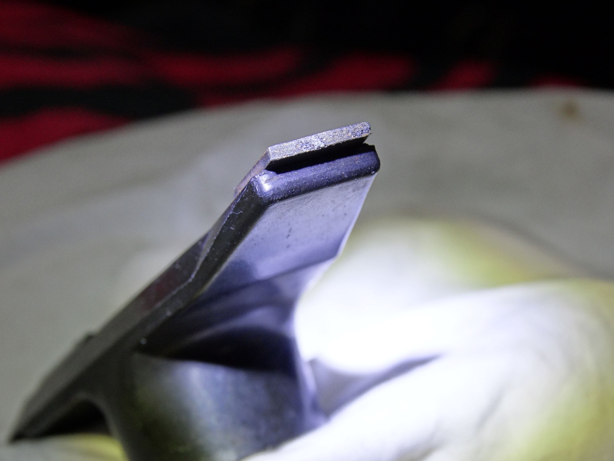

The rotor has some very light pitting / arcing - can I lightly sand this off with some fine sand paper?

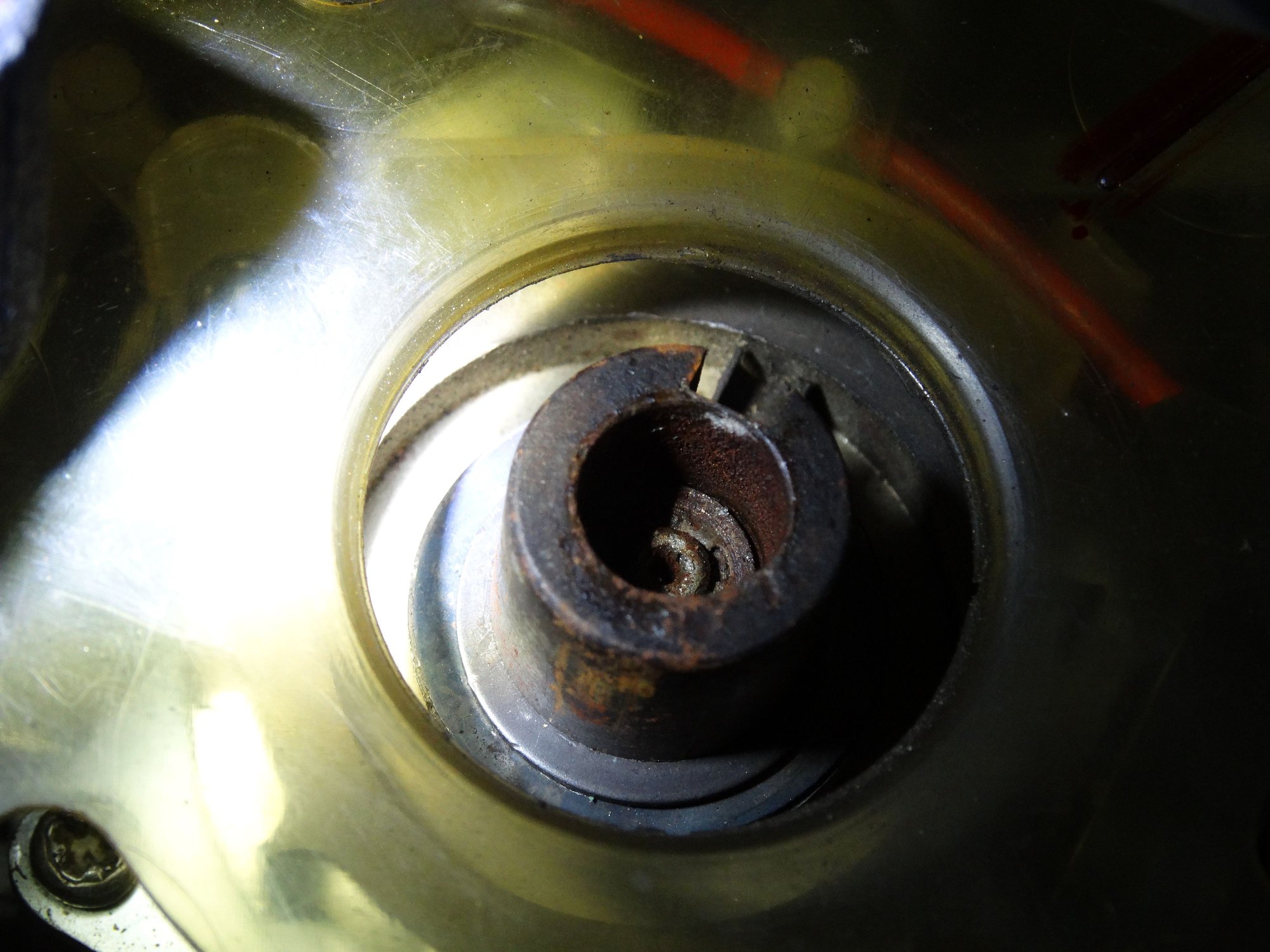

The rotor mount / shaft is a little rusty, can I put rub some oil around it?

DO NOT, repeat DO NOT clean the tip of the rotor or the related contacts inside the cap. These 2 things pass each other with a precise "air gap", and if that gap is increased too much, the issues with the rest of the ignition system is what keeps this section of the Forum flowing.

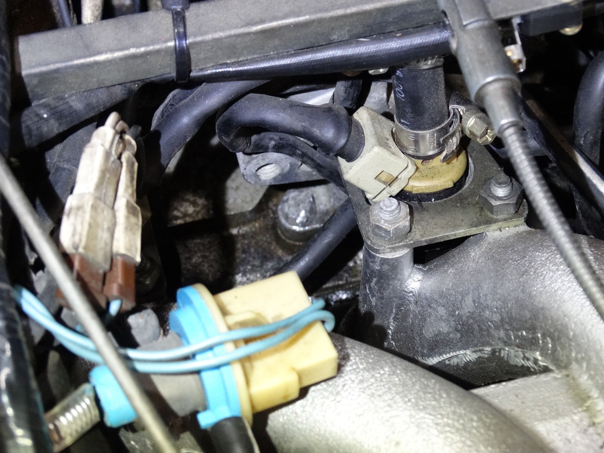

Mine goes from the manifold, to a tee..
One end to the distributor cap the other goes through a couple of weird looking filter things under the manifold then to these two switch looking things and then to the manifold end.
Any ideas what to do here?

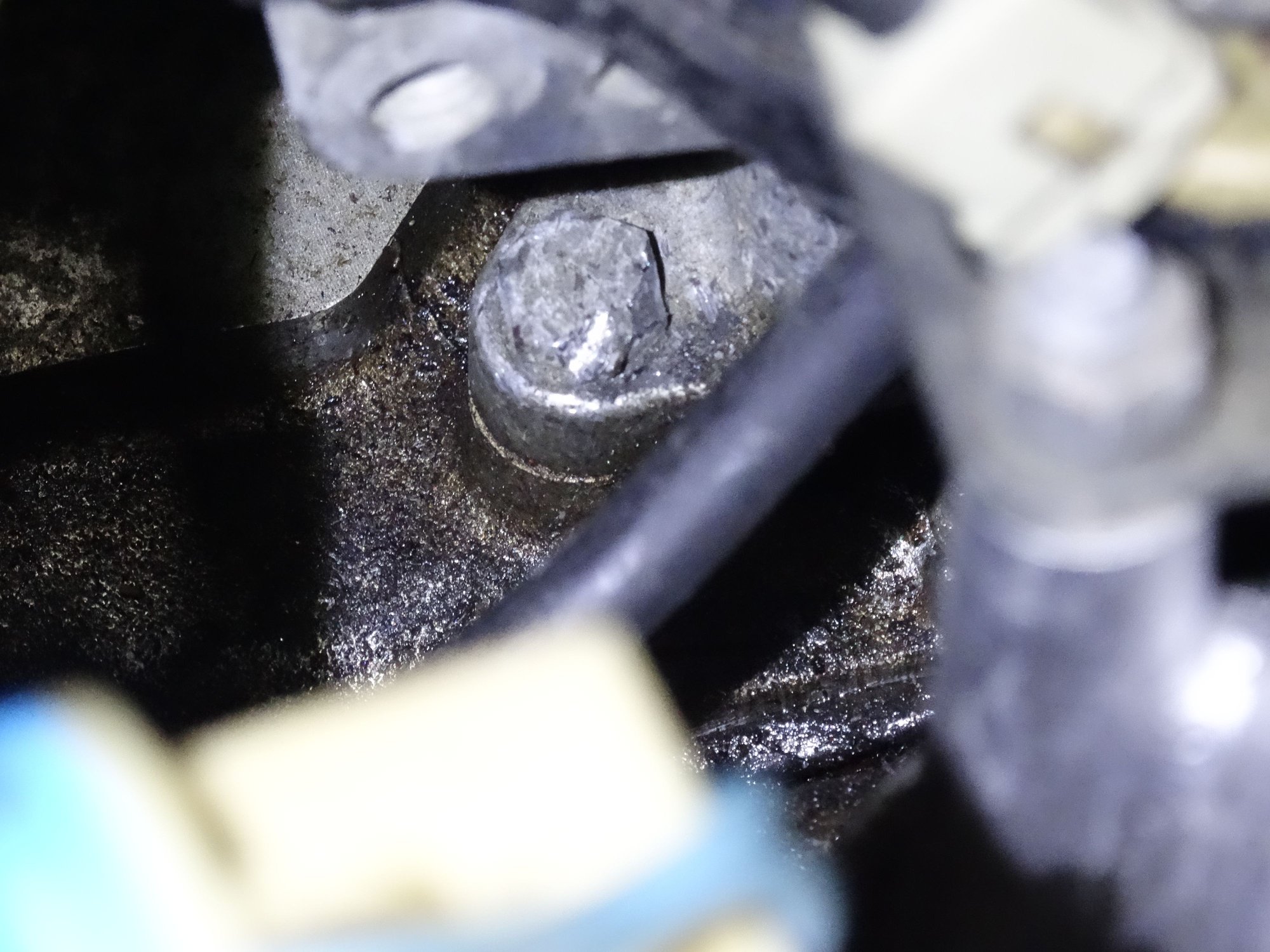

Well that is the end of that job.... throttle tower is not coming out to change the last 4 plugs....
Bolt is round...........
So i will not be changing the oil sender and switch.
My guess is this is manifolds out to get to the bolt, looks like it to me.
Then I will do the hole job....

Here is not what you want to see, crows foot rounded the bolt sides, then I had a go with a large screwdriver to see if i could shock it to turn.
Well the answer to that was NO... so boo hoo.
At least I checked the cap and oiled the rotor shaft, it was needed.

BUGGA.
I use JagDaim, no issues ever.
I have NEVER removed that pedestal to do those plugs, maybe its the angle of the dangle across the ditch. 3/8 plug much socket, uni joint, and go for it.
Early days, the balance pipe came off, then I removed that sucker totally, and access was better.
I always do the "A" bank plugs leaning over the "B" bank fender, and then swap sides. The only mongrel plugs were the 2 #1, until I changed to the Sanden compact compressor.
The vac lines, SIMPLE, drink beer. I will think on it, and do a mud map of what I did to incorporate that Blue/White valve and the dump valve. It was YEARS ago.

What are these?
The dump valve ....... that must be under the manifold?

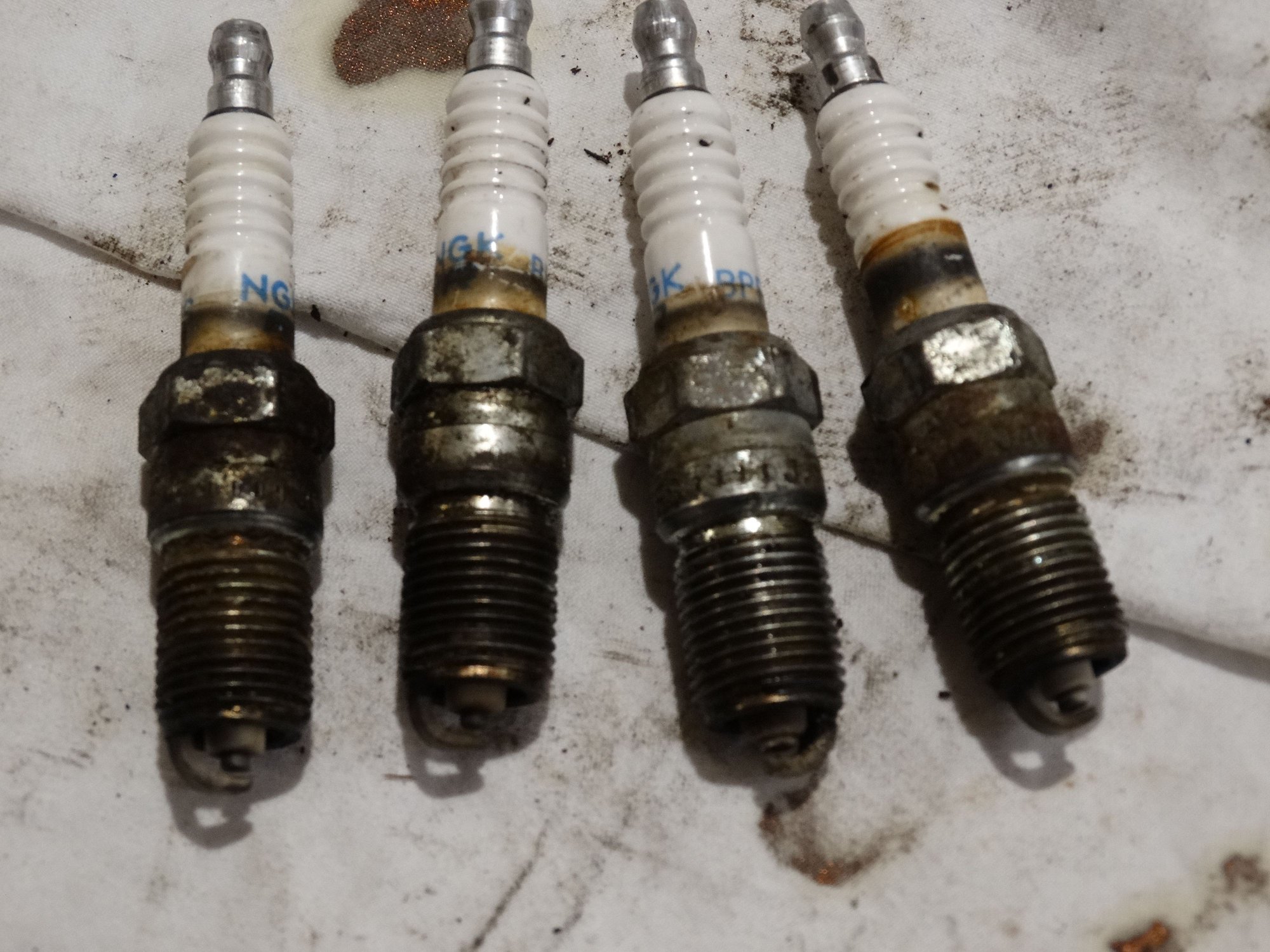

Thanks Grant, all plugs changed!!! LOL
There was one which was a pain in the ***... others went well.
6A and 6B some gorilla must have tightened them.. I thought my arm would snap, seriously scary.
But bang and they came undone, the other two were not tight, or should I say nipped up as they should be.
Some antisez on each plug, nip just to tighten and good to go.

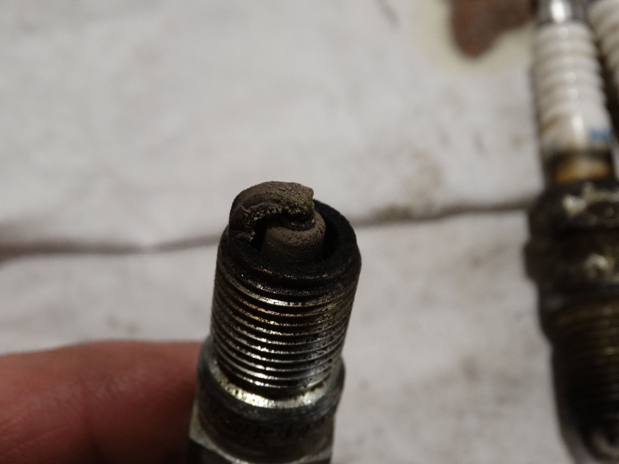

One plug looked like that cylinder is not running like the others.. any comments?

Pollution junk, removed from mine the 1st week of ownership. Left those units screwed in to keep the coolant where it belongs, properly sorted with blanking plugs much later on.

Those plugs are like that from age, lack of use, driven too kindly, wrong fuel, dirty fuel, and so on.
All that vac crap does no good these days, as most of it is inoperative anyway, and NLA from suppliers.
The Blue/White is usually near the 5A Inlet tract, the dump valve is generally nearby, or attached to the end plate of the A bank Inlet manifold, usually the rear.
The dump valve is a "dirty White/Black capsule, 2" maybe diam, flying saucer shaped, after 6 beers, and 2 vac hoses attached. It may even be missing, some of the ones I played with were AWOL.
