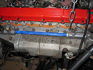

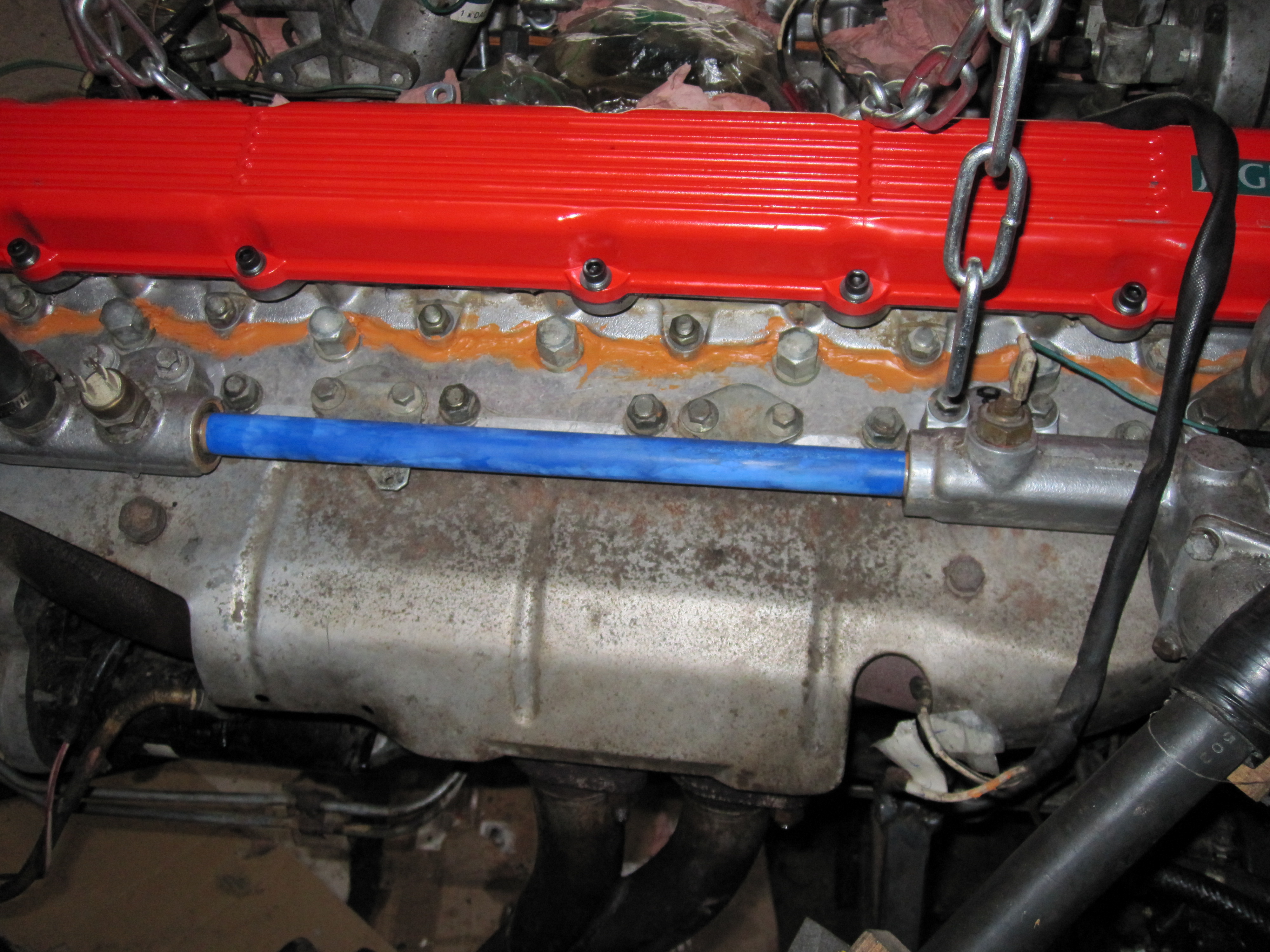

A leaking, and only very slightly leaking OP sender blew out about 60% of my engine oil over a 300 mile journey. Oil all over the underside of the car, etc etc. Almost impossible to detect at tickover. As my v was relatively clean, leaning over the sender with a flashlight (torch) when I rev'd the engine I could just see a drop of clean oil coming out of the sender.
Either that or the cam cover gaskets and half moon seals are the most likely culprits. Also, the tappet block join, which is not gasketed, is a likely oil source. If you ever get in there, inlet manifold off, do the lot. The tappet block join is not under pressure, just gravity, so it can be sealed with high temp RTV from outside, after careful cleaning and a bit of roughing up the surface. Daim did a great smart job on his, this attached pic is my less expert effort. But it does work.

Attached Thumbnails Oil is dripping: true source?-img_0286.jpg
