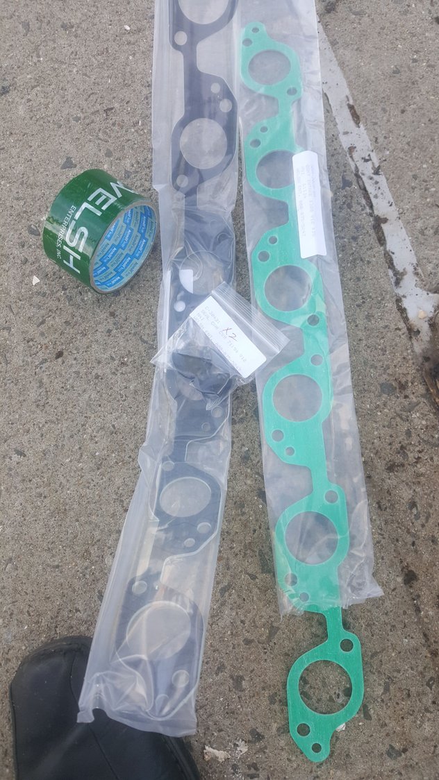

Hey Rescue and Greg! Thank you
Somehow I missed both of these posts,,, don't know how...
Took careful note. I will be driving in tomorrow. After I wrote my post and questions, about the fuel injectors, I replaced all of that two years ago. Reman bosch injectors from a reputable company and seals and the rubber shock around the injectors. I think I'm going to leave those alone. I am going to take a careful look at the underside of the intake to see if I can get a good look at the injectors caps from the underside. I am still puzzled as to the reason for the cracks that caused me all the problems a few weeks back.
I received a package from Welsh. I am super impressed by the thickness and quality of the intake gasket they sent, with a small role of what looks like packing tape (covered in the Welsh logo) to cover the ports while the intakes are off. And the two (smaller than I thought) D half moons.
I'll be very careful about cleaning up surfaces and think I will just be using Grant's famous red RTV approach. I'm excited about the job, honestly.
I plan on painting the covers once off. May sneak them in an oven to quick cure.
Greg, thanks. I do have magnets and will be super careful to make sure EVERYTHING that needs to be off of the intake connection area, everything in that area, is cleaned up and free of debris before I do anything.
I may have a tough time finding the proper allens to replace the hex,, but will try. If not I'll certainly be able to find hex heads of the proper thread and length.
This is gunna be good,,, unless it's not, lol.

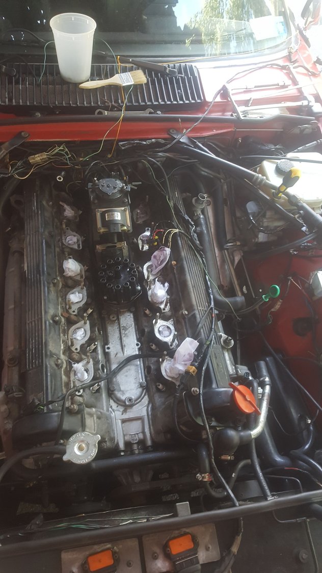

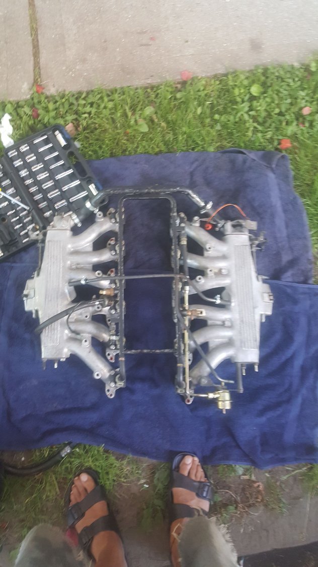

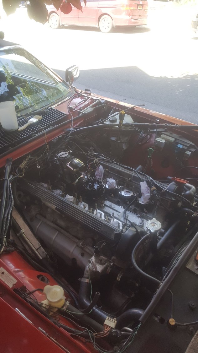

Making good progress... Down to, for one, removing intake nutts... Hmm. They are almost falling off (if gravity wasn't working against them)... For the reassemble,,, what is proper torq down for the 24 intake nutts. I mean, I could feel it out but if there was a number I could hit it.
Things are going very smoothly. Magnets in hand, lol
Loose Inlet manifold, there is a major part of your crappy running.

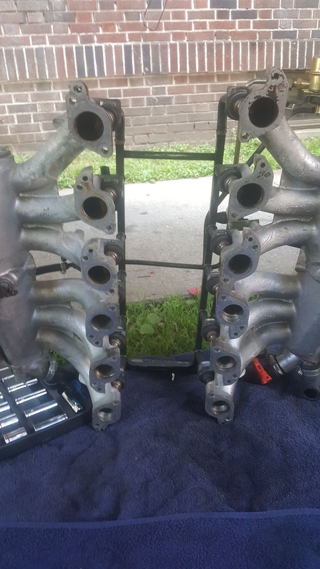

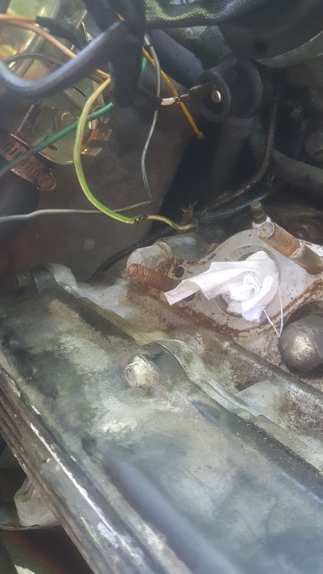

Hey,,, She ain't runn'n so bad... Lol - but maybe I ain't seen nothin yet...
The real work is ahead of me now.

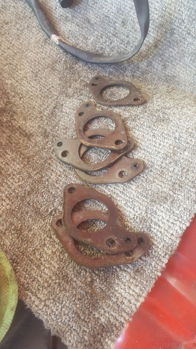

These gaskets are in SUCH GOOD shape I want to reuse them!???
Why are things so easy to take apart!?

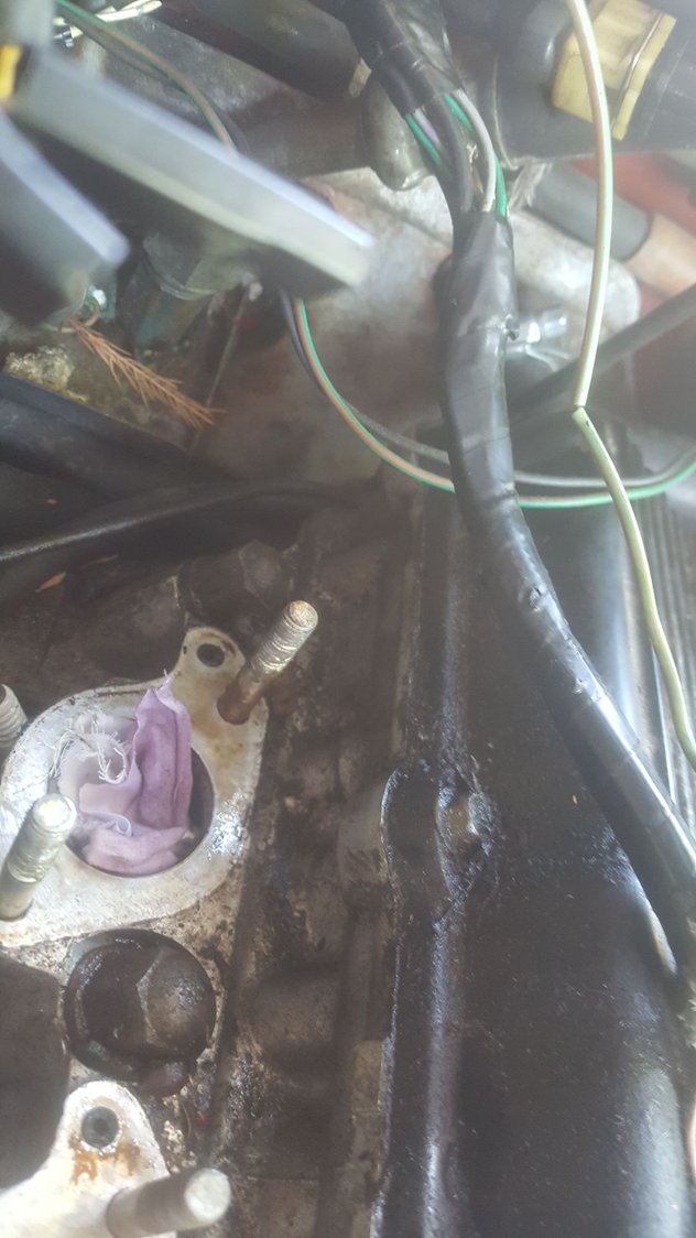

I really think this is my problem side...
This side RH, looks dry ish...
Haven't washed it yet. Looks ok...
Clean up time...
I haven't wiped them down yet,,, but they are solid and in perfect condition

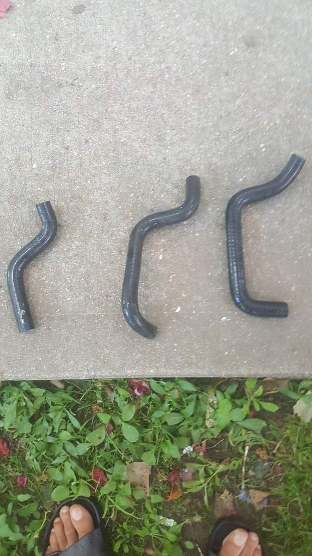

Sure makes these last few hoses easier to get too...
Glad I have and held on to them the last 2 yrs...

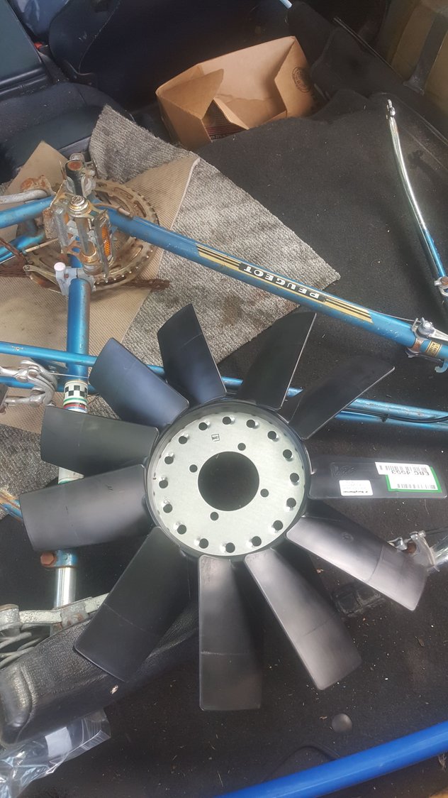

I have jacked up the front of the car. Easier for my 6.4 frame and, most best, for enabling the soap and water, grease and grime, to run off. I wish I could be neater,,, but I'm not made that way. I'll go under and clean things up at the end.
Think I'll do the fan today too!

Good stuff JJJ. Do NOT reuse the intake gaskets!
