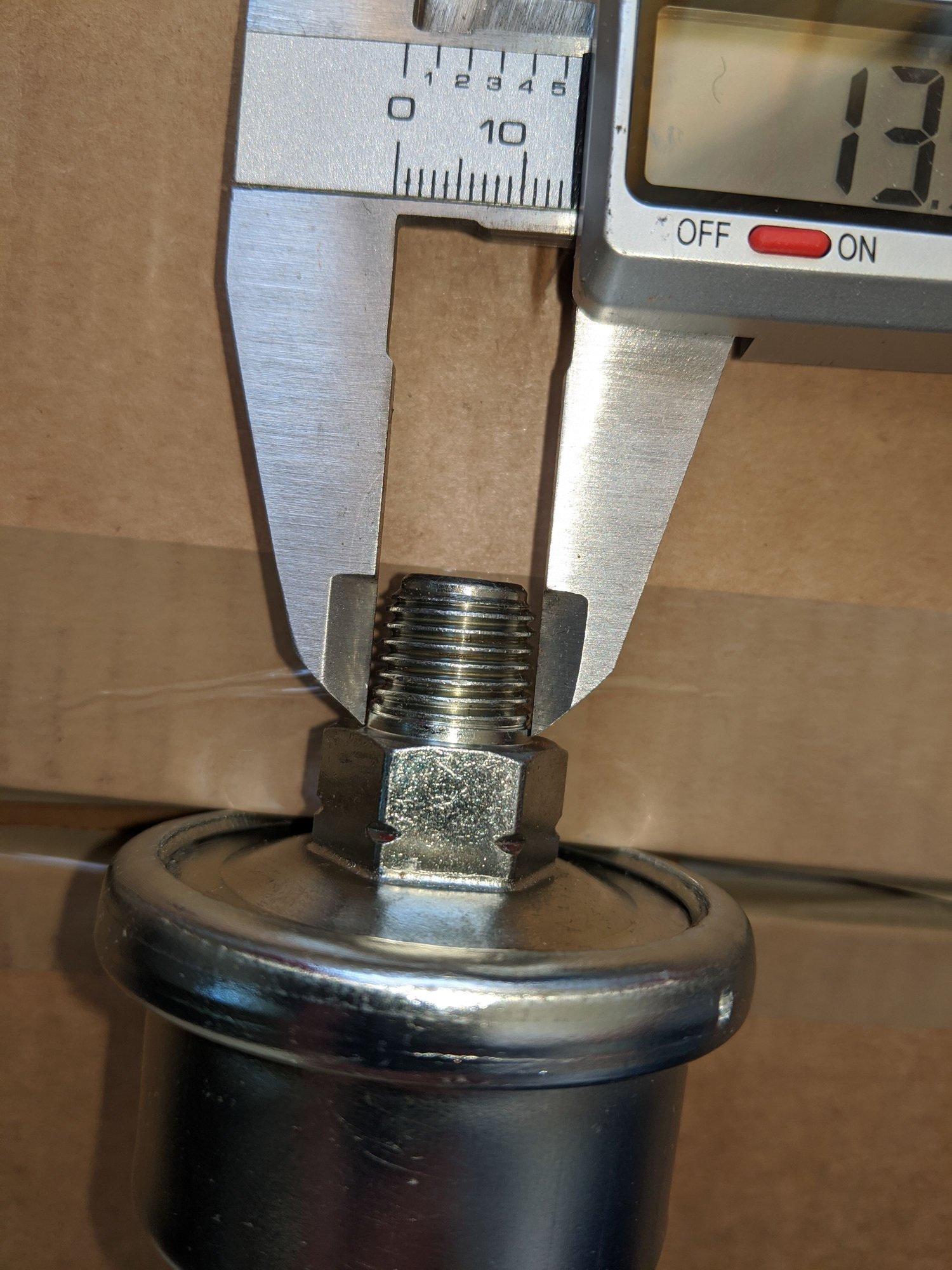

Managed to get it off in situ - Used an adjustable wrench to hold the base/pedestal part from twisting, held that in place with my left hand, & got it off. This would be much harder if you still have the intake manifolds in place - crows foot wrench would make it much easier.
So, regarding the tapered issue. Here's a pic of the new sensor:
I've had a chat with the suppliers - apparently they are all supplied like this now (changed design) & they can't get a parallel thread. I've also had a second look at the one in the car & it looks like it might also be tapered, but hard to tell - could just be a bit mashed up. It's definitely very bad practice to use a crush washer with a tapered thread.
I think it will fit OK, with some PTFE tape on the threads just in case.

Posts: 28,839
Likes: 11,292
Well done, yes, the LH words of encouragement always work.
Probably OK with that sender. I have always managed to get the OE spec one when I needed one, bit it has been a few years now.
Check the ohms prior to installing, as the Jag uses a reverse ohm set for some bizzare reason. You are looking at about 650ish ohms at rest, and then as pressure is applied it goes to zero-ish, the exact reverse of a "normal" gauge sender unit.
