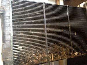

You need to ensure the Radiator has been sorted out, as the space between the Condenser and the Radiator
Gets blocked with debris as you have found out
Just be very careful that you do not damage the Core

The usual problem I have found with V12's is debris gets in between the AC condenser and the radiator and blocks the airflow. The only real way inspect and clean is to remove the radiator and inspect. It absolutely cannot be done with the rad in the car.
I don't have temps as high as Grant does, but I have had the car is 40C heat with the stock mechanical fan and it was fine. The system will cool the engine if everything is in good working order, but often things degrade and people don't address the fundamentals before condemning the stock system.

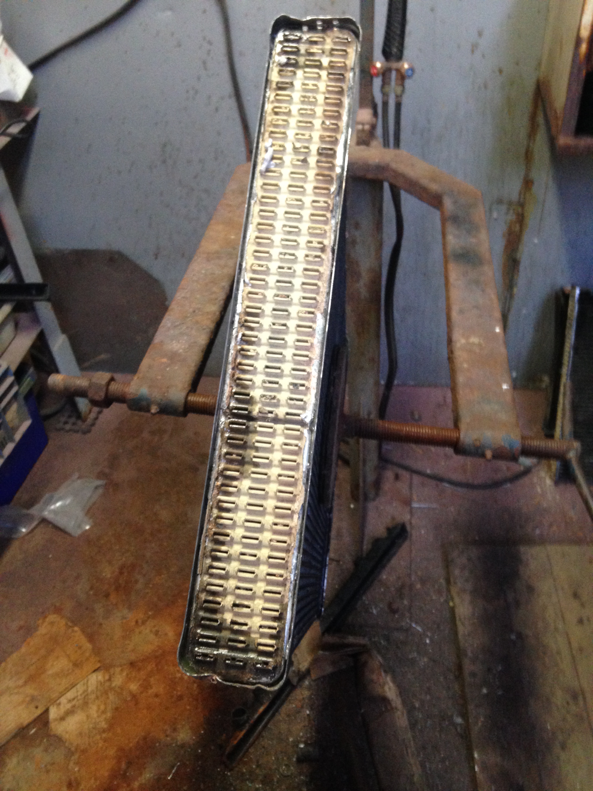

Hi Steve
I did my cooling system up based on advise from Grant Francis....ford twin thermos, stuck with the 1 - 1/2 pass brass copper system and the thermostats recommended by Grant.
Of note in my adventure was that the coolant hoses, thermo's etc were all in serviceable condition...even the rad cores were OK...see the attached photo of the externals of the radiator when i pulled it.....this would not have got me through and Australian summer.....!
anyway .....everything was renewed in the heating and cooling system ...yep heater hoses.....water rails - changed to copper....etc....and the needle sticks on half way .....and boy does she give off some heat in summer....
Pretty much followed the advise of the form members
all good
Darren
