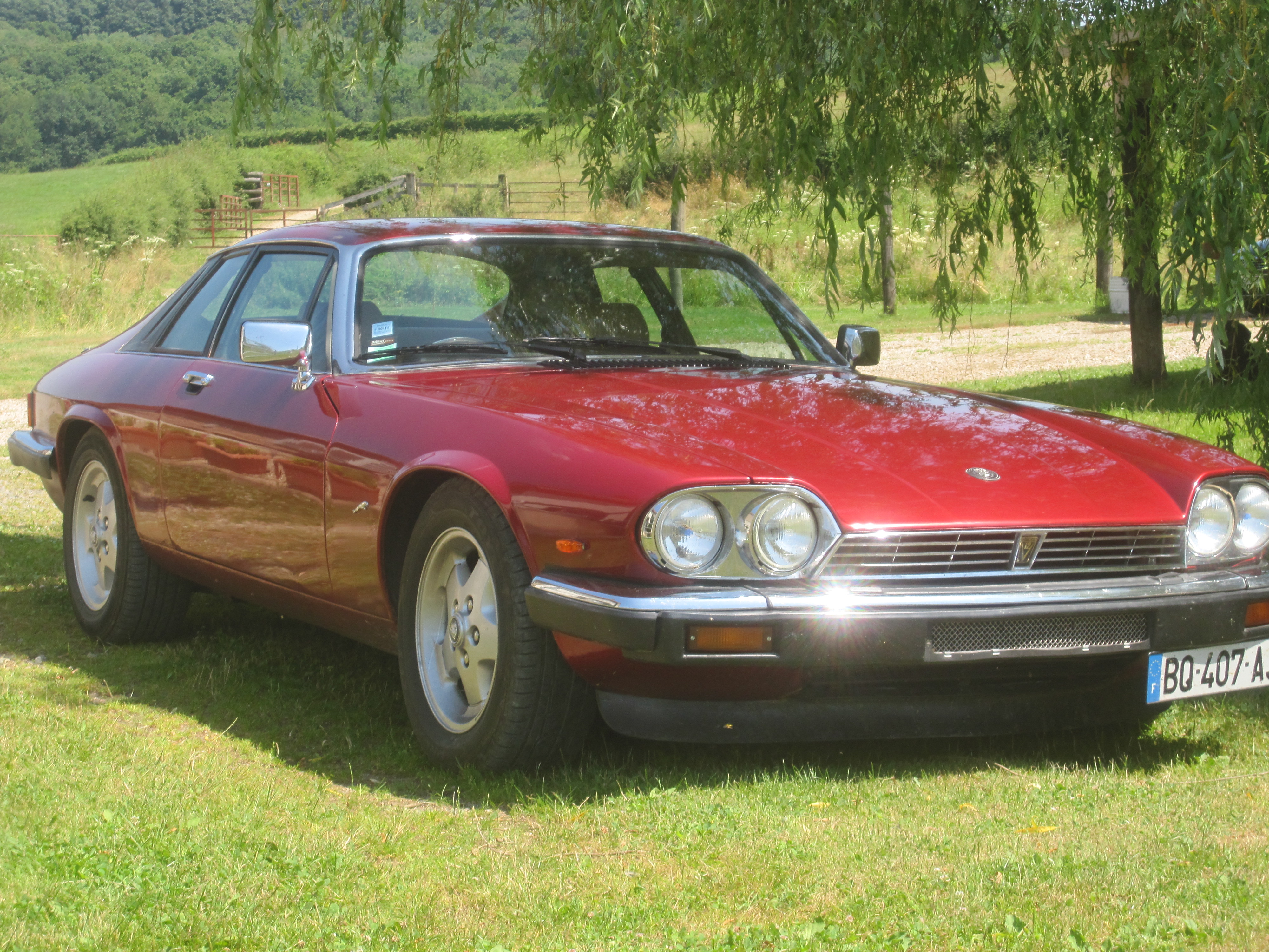

On a related topic; my 1985 car came from the factory with a rather old-fashioned oil cooler (the item under the condenser in front of the rad). It was a tube about 1 inch diameter with loops of thin wire welded to it looking like a long thin hedgehog. The more modern cars have a conventional looking cooler, as does mine now.
The point is this: the older style of cooler did not, repeat not, fill the gap below the condenser. There was loads of free space top and bottom of it for air to directly hit the radiator fins. In my mind there is no doubt that the older cooler allowed better radiator cooling than the modern style oil cooler does, purely because of better airflow.
As soon as I fitted a new modern OEM oil cooler, my car ran hotter; not overheating mind, but hotter. I did not like this much, so I removed the bumper and tested the car. INCREDIBLE! coolant temps were far lower. Anyone who does not believe it, just try it.
So, bumper back on, I cleared the air path as much as I could with a slot in the bumper about 18 x 3 inches and I moved the horns and the auxiliary coil out of the airflow. In total these mods gave over 100 square inches of clean airflow (rather than turbulent airflow) hitting the stack. Moving the coil and the horns alone gave about 40. These mods made a huge difference, particularly to the speed with which coolant temps reduced after a traffic stop, once the car got moving. "Clean" air hitting the rad stack is the absolute key to improved cooling, once all the basics are fixed.

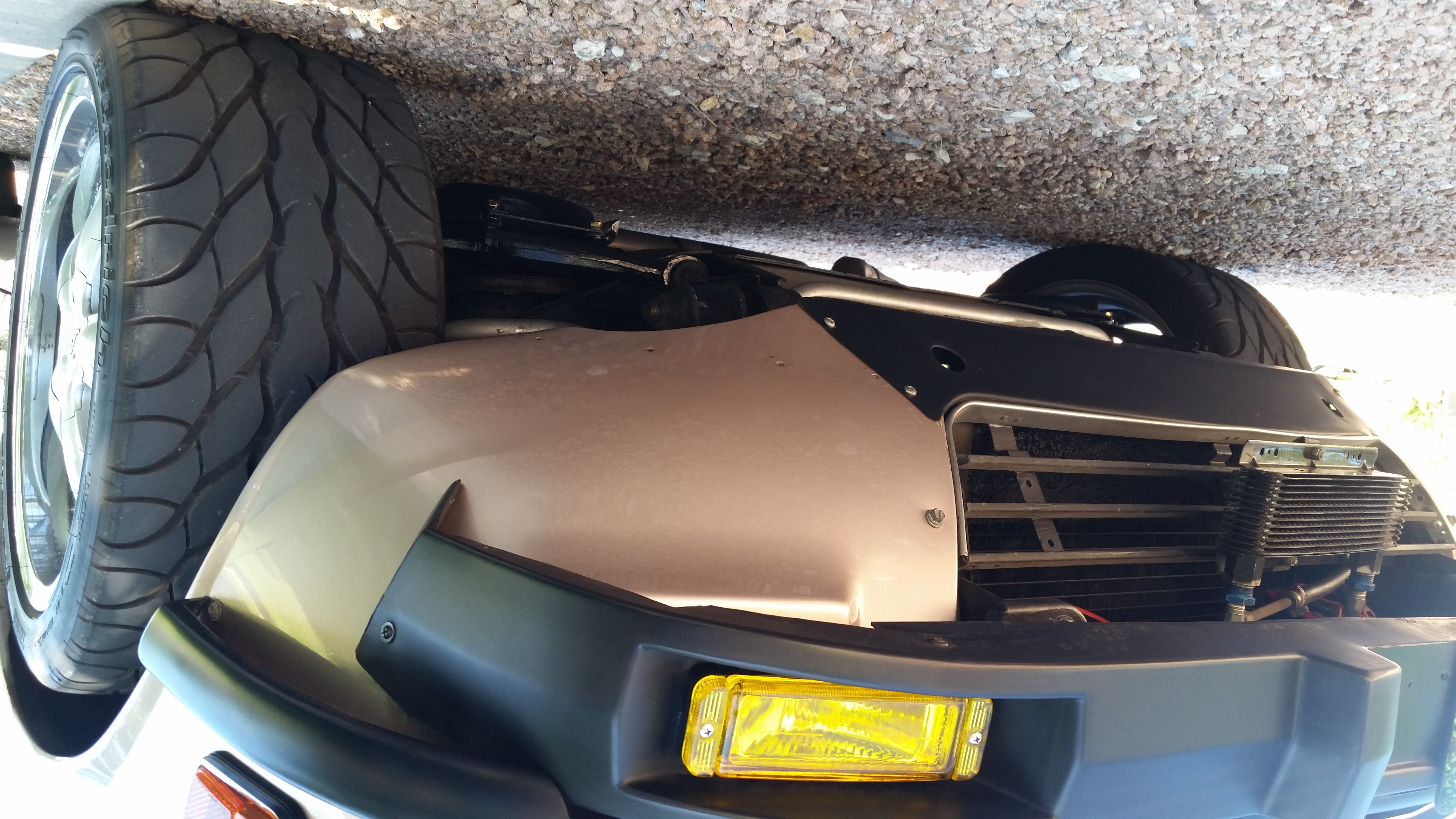

i use a standalone engine temp gage,Digital readout in 2 degree increments, most important coolant sensor mounted on left /rear cylinder heads(tossed out the sticky AAR valve), 180 stats, and use outside trans cooler,.
never in 24 yrs have temps beyond 195F even in 100+ ambient!
average is 185F 95% of time.
you can flip the pic !!!!Grr.

Where is your sensor located and the readoutscreen ? I've been debating what engine related mods to do on the car now that I've got the rear end parts sorted (shop time pending) and I was thinking of fitting a series of digital gauges to a LCD screen either inside the center console/armrest or in the same location as the trip computer which naturally doesn't work anymore.

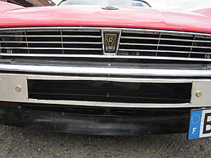

Here is the closeup, rubber cover over bumper off at this experimental stage. In the end I slightly reduced the width so I could get the license plate up on the LHS side of the bumper, as when I first slung it below it ruined the stability as it affected the airflow to the spoiler.
Ruined stability how?
I've thought of either having a shop fabricate a slightly larger front spoiler or your method with the a vent in the bumper, didn't the race cars (twr) have larger spoilers?

Because I had the license plat fixed below the bumper to start with. It interfered with the airflow to the spoiler. Once I moved it up so it was on the bumper, but to one side so the slot was unblocked, all good. If you look at the photo in post 33, you can just see the plate hanging below the bumper.
