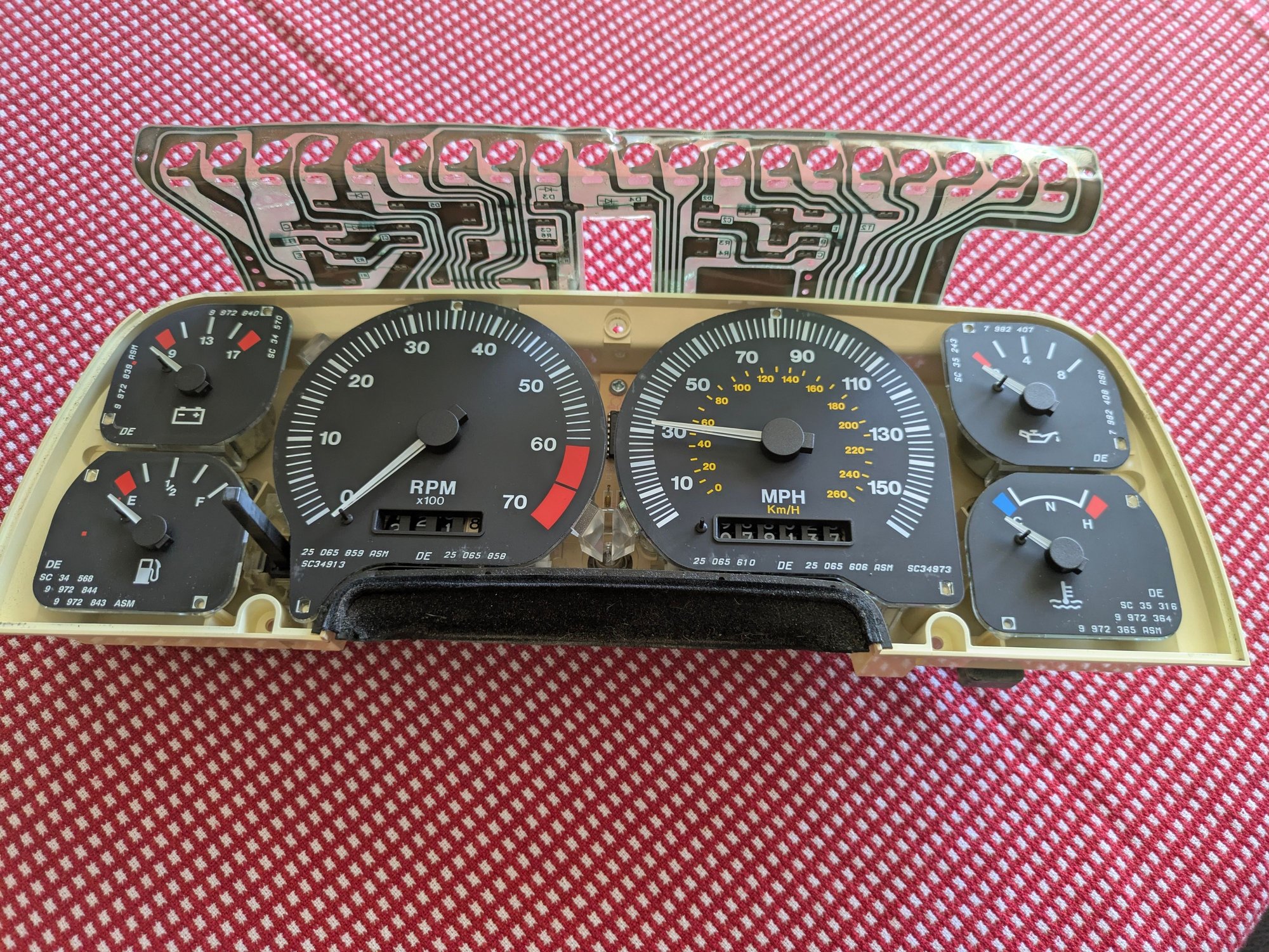

I removed 1994 Jaguar XJS instrument panel to upgrade bulbs. Now the speedometer is all the way over beyond 150 MPH. Not moving back at all. Any thoughts on how to correct?

Turn it upside down, if that doesn't fix it remove all the row of bulbs and six screws and you can use your finger to reset it

All I had to do was flip it over. Thanks for “making” it that simple.
