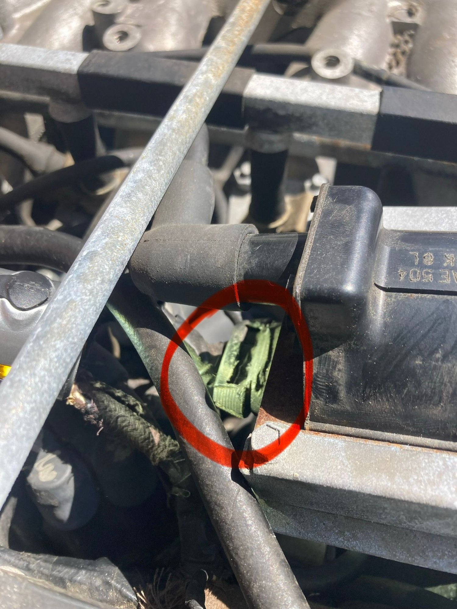

Rodents got a couple of the wires. Could probably repair, but please identify the little snap-in set of wires in the photo.
Thanks very much in advance!
Please identify the name of the little snap-in wire
Please identify the name of the little snap-in wire "harness"...THX!

Are you pointing to the ignition coil connectors?

I think you better post a closeup!

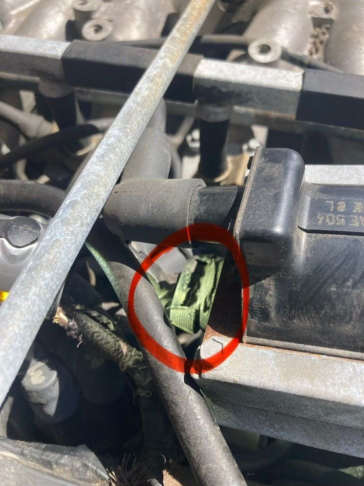

Default Please Identify Part Name for 1989 Marelli XGSRodents got a couple of the wires. Could probably repair, but please identify the little snap-in set of wires in the photo.

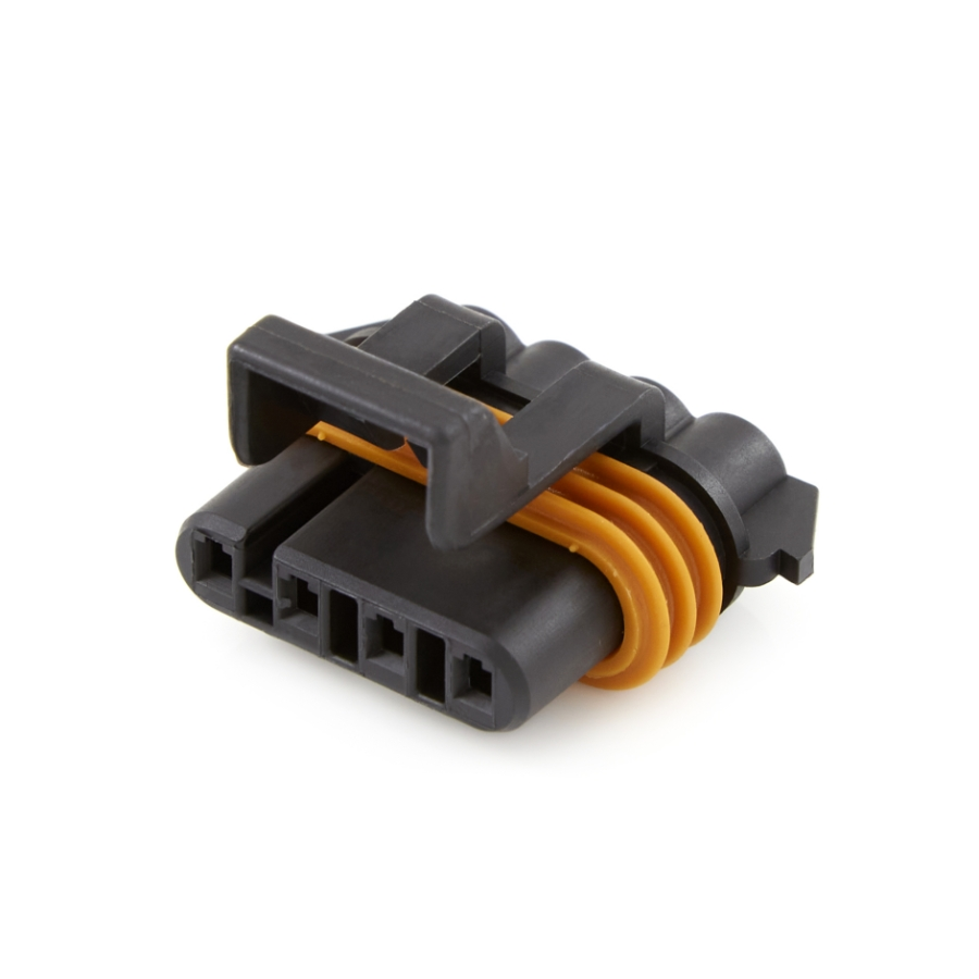

4 way "Packard" connector:
E.g.
12162144 Delphi Metri-Pack 150 4 Way
Double check but I'm pretty sure that's the varient.

NAPA EC194
