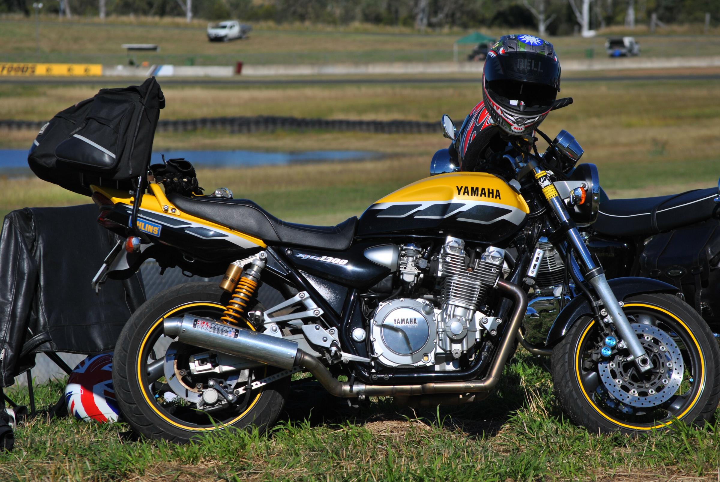

I well know the feeling. My 2001 XJR1300 was like that(had it for a life time). Until I had to sell because after 29 years of riding(on all sorts of fast bikes) I realised I was tempting fate every day using every one of those horses. (one of those morons you see doing really stupid stuff)
Bought a Bonnieville and a Jag,loving it. But I do miss the redline scream and absolute thrill of just blipping the throttle to do a massive mono or just plain go fast... but as I was getting older I was getting less responsible so gave it away for red wine and grace.
My manager of 12 years is wondering why I suddenly changed to captain slow.
Passing a mobile speed camera car at 176km/h on the back wheel accelerating out of sight(in a 70 zone),then him catching you 14km later at your off-ramp slows you down. That was my dialy trip to work for many,many years.
Suddenly realised I was 44 and not 19.

But I've got Cousins who are Speedway Riders and they never stop talking about that adrenaline rush!
Captain Slow you are certainly not and I could not be even more impressed!
And I think that it goes without saying, that those Bikes of yours are Awesome!
