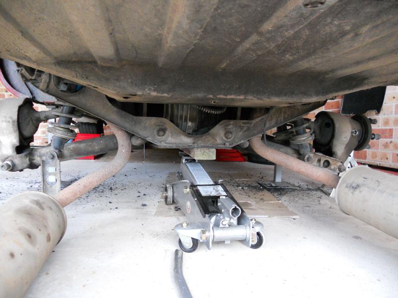

I used jack stands under the jack points and a jack under the rear end with wood. I jacked the car up under the diff inserted the stands unbolted the mounts then lowered the rear end.
Greg is right if the rear mounts are bad the whole rear end will fall out unless you have it supported, and this unit very heavy probably 200kg.

The rear end can ONLY FALL OUT if the subframe bushes are shot. You can jack under the 4 jack points, I have also jacked under the diff cage with a bit of wood to spread the load. The same with the front subframe always use wood to spread the load on the subframe. When I pulled the front subframe out and cut it open the inner ribs were bent from being jacked in the middle. I have welded in 2 supports so my front subframe can used as a jacking point.

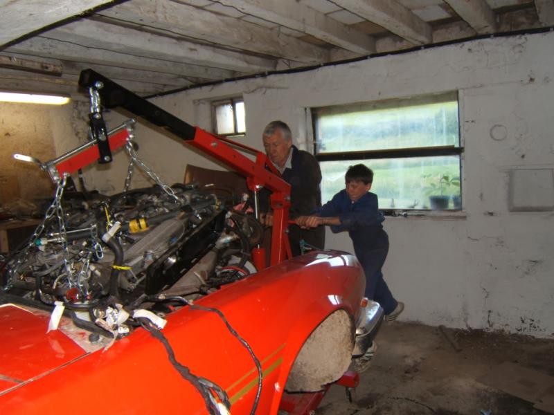

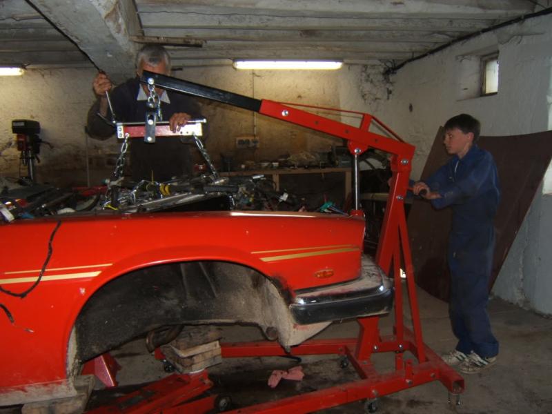

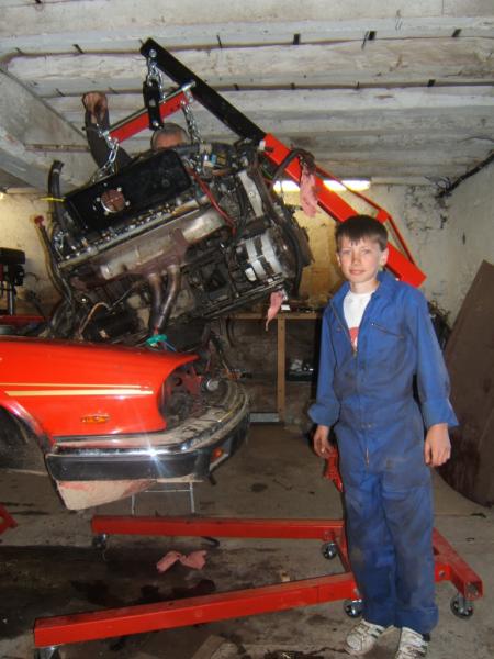

Pulling the engine and trans out together is doable, if you have the right tools. The hoist needs quite a long reach, must carry one ton, and needs a tilting device. In particular the car has to be quite a bit off the ground (say 2 feet or so). Most importantly, to take out both together is MUCH easier if the front subframe is lowered/removed first. This is because the sump forms a downwards 'step' rearwards of the subframe/steering rack, and the engine/transmission has to be tilted at about 60° to get it out if the subframe is still in place, and the downpipes may have to be removed. All of this is MUCH easier if you have removed the radiator stacks, so there is free access from the front of the car. Pics attached to give you some idea.
Taking the trans off on its own still a big enough job, and also requires the car to be off the ground quite a way. BUT, if it is taken off first, getting the engine in and out is quite a bit easier.
Hope this helps
Greg

Wow, thanks for the info and the pics. That's how I usually do engines ( Disconnect tranny first ). Just wanted to ask and thanks for those pics. Reminds me of my son helping me with an overhaul I did on the truck.

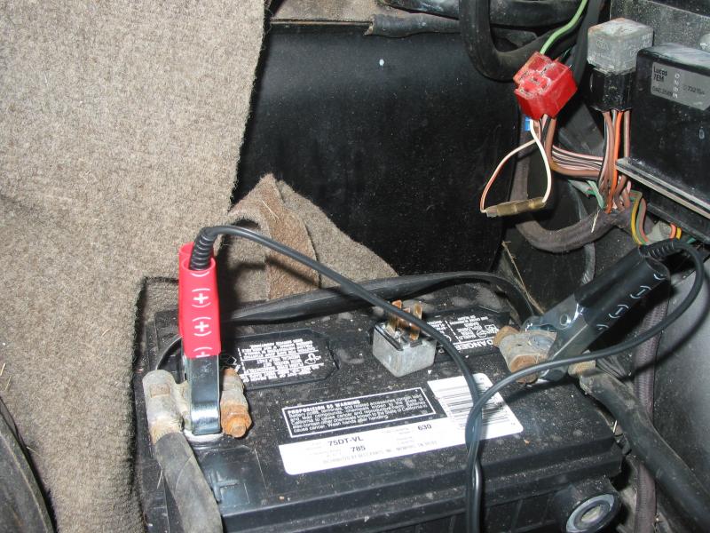

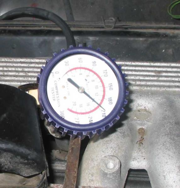

I finished my compression check. . These were my results: 1A-203, 2A-198, 3A-200, 4A-200, 5A-201, 6A-205, 1B-205, 2B-204, 3B-200, 4B-198, 5B-204, 6B-204. Couldn't attach movie file, but have movie file if interested. Tested after warming up engine. Removed A/C compressor and throttle pedestal so I could get at everything. Also removed pickup coil from ignition amplifier and removed fuel pump relay ( #3 ) from socket in trunk. I believe these readings show that the engine should be ok, but comments are welcome.
