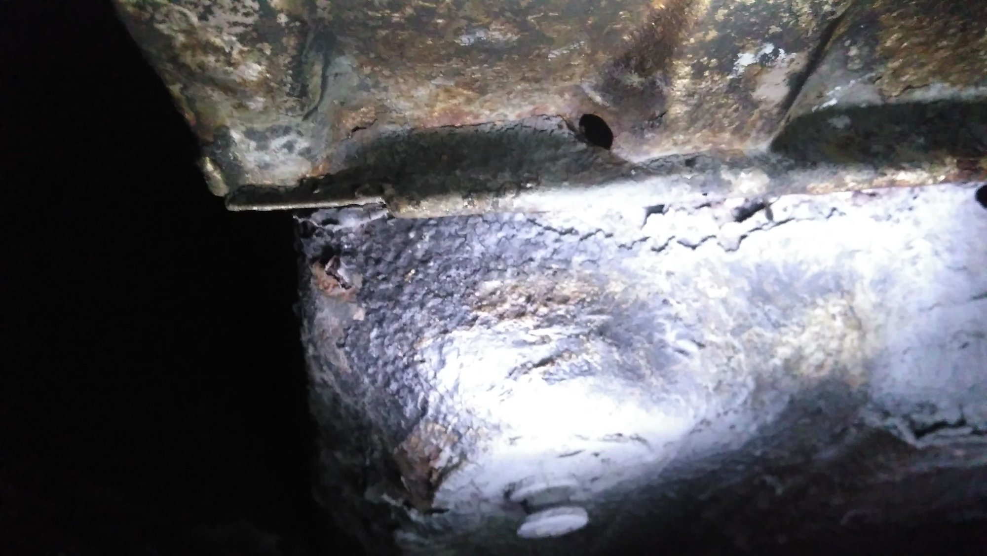

Anyway, I wanted to be absolutely sure about the condition of my sills (here are my offside) so I poked them in various places and two failed.
That's pretty obvious where the new hole is and didn't hold up much resistance sadly. The area surrounding it seems to be fine. The next one is the sill end and there is a hole (just that the picture is awful). The hole about 1 mm in diameter so it is tiny but I fear it is a rusted from the inside out job.
For those who don't know I'm 16 with no knowledge of cars, but this is a learning curve. So what's the process for repairing a rusty sill?

Depending on har far it has gone, a new sill would be best. You can either patch it with a repair patch or replace the sill. You'll need to weld or have someone weld.
If you could weld, you'd start by removing the rust and seeing how far gone the area is. Cutting back as much rust and as little good metal as possible. When all the rust is removed, you'll want to weld on the repair patch/sill. Flood it on the inside with wax or some sort of rust protective stuff and then get it painted. Recommended is a good underfloor sealant which can be painted on, i order to stop stone chips causing more rust.
A good shop shouldn't charge mich. I cam get a sill replaced herr for around €150/side incl. paint afterwards.

I do want to get into welding as part of the project. My concern is while I start cutting sections of sill out, won't that comprimise the strength of the car and it'll start to crush in on itself?
And when you say "too far" is that if the rot spreads through the first flange (I think that's what it is called? The piece of metal that joins the inner and outer sill?)

The outer layer is rarely a carrying load bareing part. Like the wings...If you cut the roof off amd leave the doors open, then it'll bend
