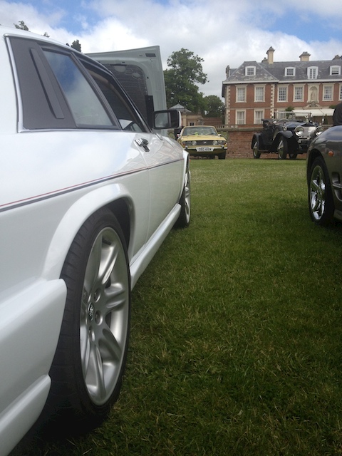

the coach lines all come separately , and a car has a set of 8 decals to apply to individual panels ,
depending on year and spec, the coach lines are slightly different, but basically they are applied just above the swage line on the car
3650 by MyPix on Talk Photography
these are a set of ' sports-pack ' spec coach lines ( flame red over pewter ) for a 1989 car
1819 by MyPix on Talk Photography
BB

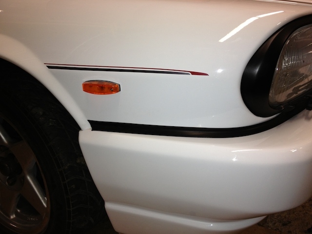

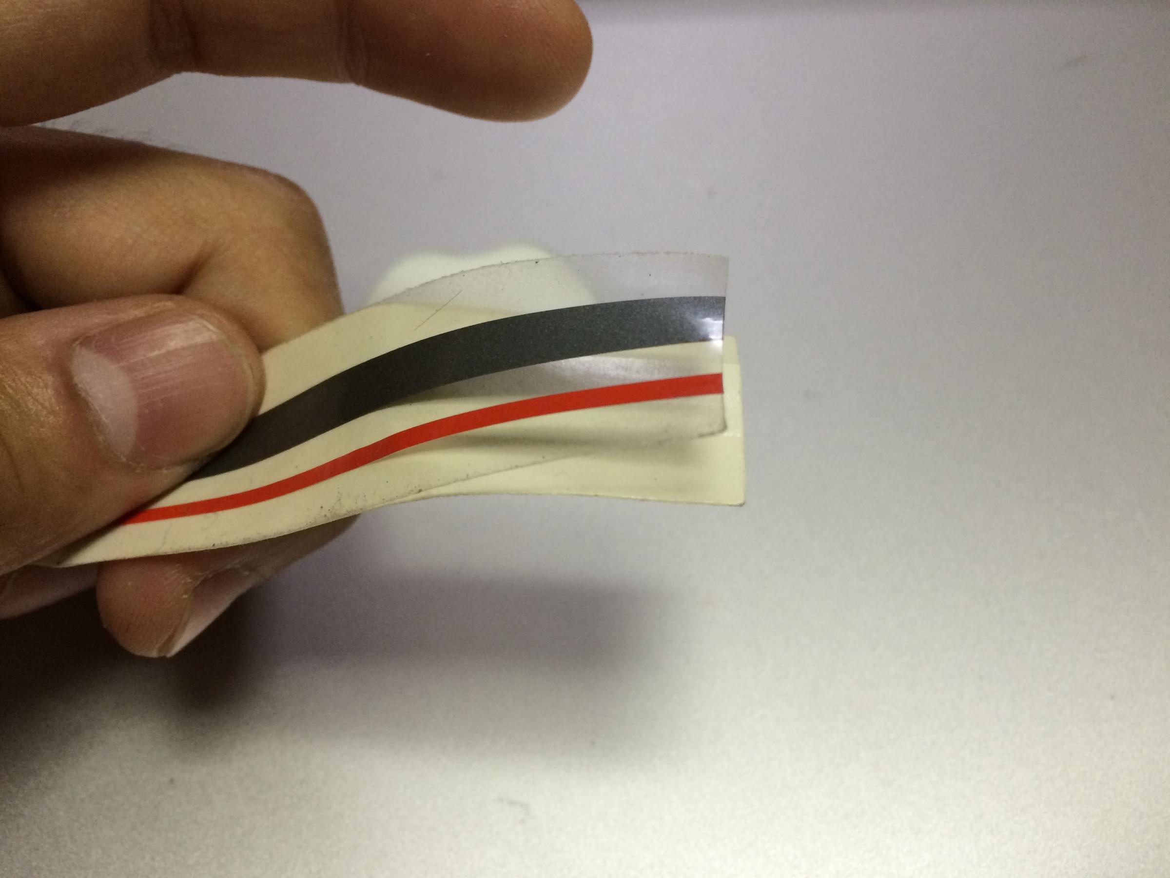

I re-did the coachline myself. The tape is sandwiched with film and backing paper. After peeling off the backing paper, stick the tape and film together on the body, press and rub the film/tape to stick properly, and lastly peel off the film only then the tape is left on the body.
It should have been a quite easy job, but there is one problem which makes the job a bit hard. Some of the stock you can get from Jaguar Heritage are dead stocks. After a long storage the film shrunk and made the tape come off from the film and backing paper in some parts. So you will have to peel off the film to flatten the tape onto the backing paper and redo the film on the tape.
Now the coachline which you can get a set for a whole car is;
sportspack amber/quicksilver
sportspack flame red/pewter
Coachline Tape-Sportspack - Parts For XJS from (V)139052 to (V)179736 | Jaguar Heritage Parts UK
The rear short parts of the front wing isn’t available cheaply on the amber/quicksilver, but you can make them by cutting the one for the door/rear wing.
The parts with part the number starting from BCC/BDC is the old stock, so be carful. The ones with the number from BEC is newer ones and easy to fit.
