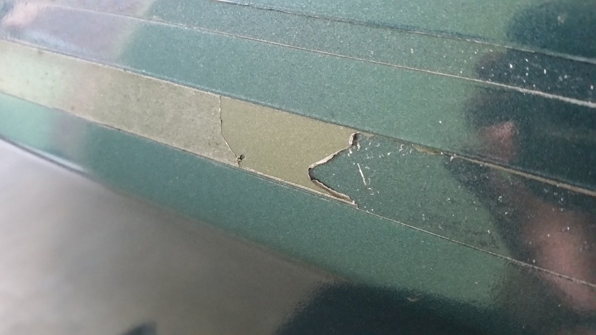

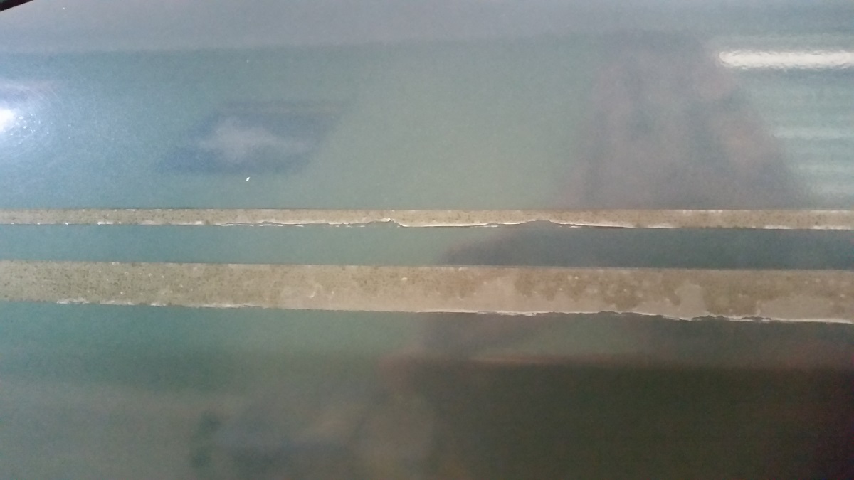

Ok day 1 down and about 60% of the job is done. I am ready for a drink....
I am sure the Great Wizard would agree, this is one of those jobs best done with patience and plenty of liquor lest one do his head in.
As you can see from the pictures some of my stripe is near perfect and other sections look shidouse. It was also one of those jobs that once you start it you can't go back. I also made the decision to remove the parts that were in good condition too as I probably have a slim chance of getting the exact same coach stripe back on. As you can see from the pics mine has a little leaper on the back of each side near the buttresses. I doubt I could get another one like that so a little sad. I gather I would remove it all and start a fresh. Not sure if the colour was meant to be silver or gray or something else. I think I mentioned this earlier in the post but does any body know what color Jaguar originally used to pinstripe JDM (cobolt blue) ?
I also found out that for most sections my coach line was the same level as the paint. This means that when I removed the coach line you could feel the indentation of the paint between the lines raised higher than the line. This seems to indicate that the coach lines were masked at the factory then a final coat was sprayed on the body so to give a flat surface all around. Anybody knows if their's the same?
Another little bugger of a thing I found out was that one of my sections had a double coach line. I peeled off one line only to find another underneath. I started to peel this off but the barsturd started peepling the paint with it!
Also the sections that looked the worse were the hardest to get off. The sections in good condition just peeled off.
So how did I do it?
Well I took my two good mates advice and used a heat gun to assist in freeing up the adhesive underneath (thanks James) and used my finger nail for the most part (thanks Clarke) to save scoring the paintwork with anything more harsh.
There were a few section where I found it helpful to use a scalpel however extreme caution was used lol! Also used some tweezers in some sections but mainly my finger nail which explains why my thumb is throbbing so much tonight!
In summary the finished product on one side doesnt look too bad. You can definitely see the shadow of the stripe due to the different levels of paint but it will be ok once a new stripe is put on I guess.

hmm
as far as I know, Jaguar never painted ( or lacquered ) over the finished coach line, and to find two coach lines stuck over each other indicates to me that the car has had some paint repair and or a full paint in its past
This is born out by the paint under the coach line being lighter than the rest of the door !! as if the exposed paint had faded in any way this would be the opposite way round ?
as you say , you have to keep going now.....
I suspect the car was repaired in some way , coach lines replaced and covered in places and the car was clear-coated all over ?
lets hope the new coach lines cover everything up

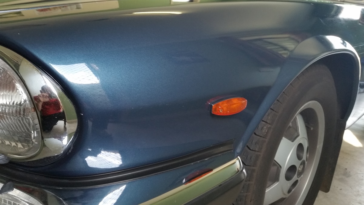

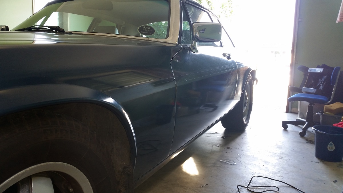

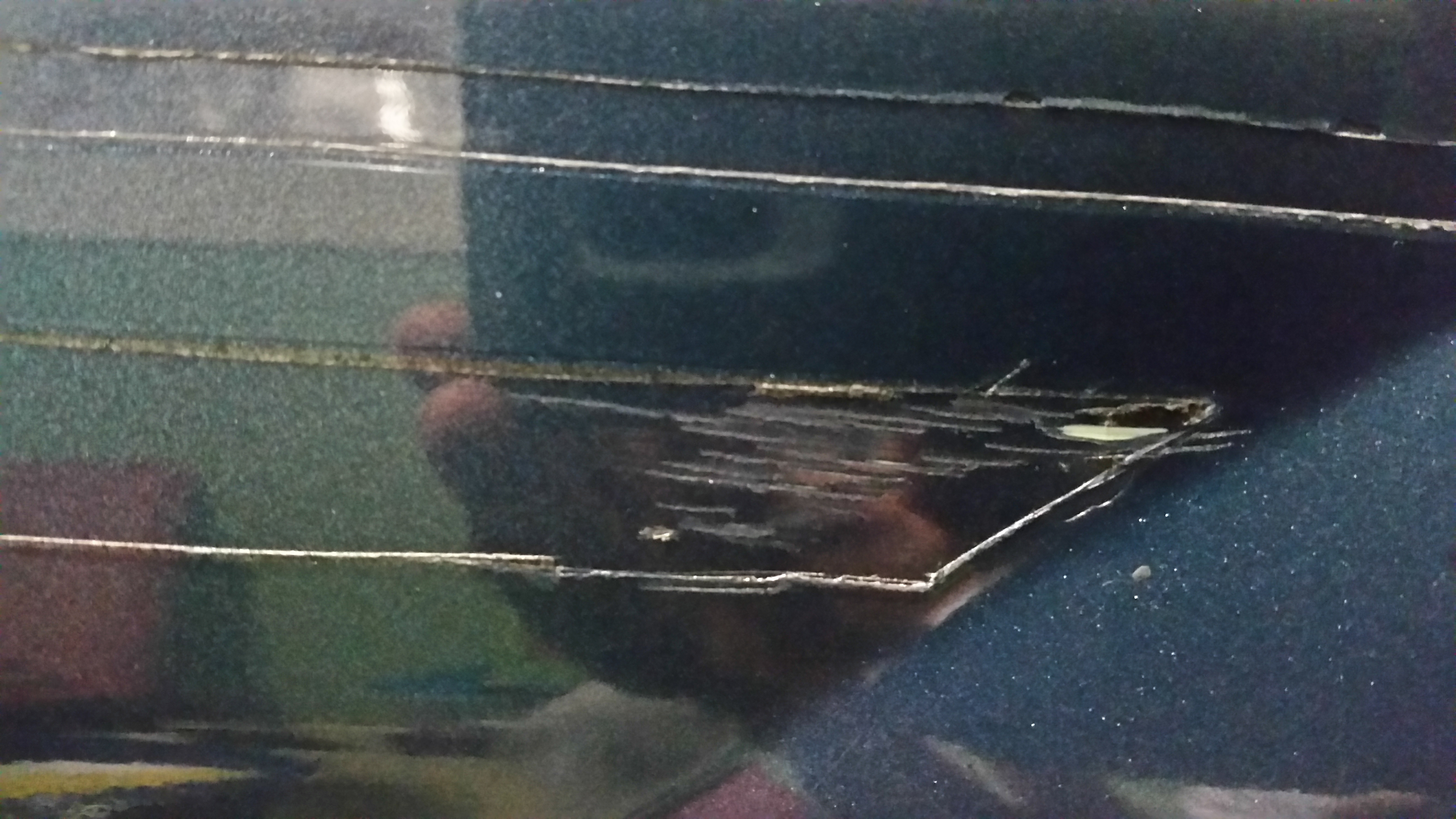

Well i finally finished removing both sides however i came across a few difficult sections.
I bit the bullet and went out and got an eraser wheel for my drill. It works a treat BUT....you have to be soooo bloody careful. I mean really light handed and very precise. I did one section with too much enthusiasm and look what happened!
Lucky that bit will be covered up with a new stripe. Im going to go over that section today with som touch up paint.
You live and you learn I guess. It will eventually look good again, ill just have to be patient...

You just about got away with that!
If you get yourself an 'Air Brush' from an Artist/Model Shop, you can use that to touch up any bad bits.
Just don't end up re-spraying the whole flipping Car! (lol)
Anyway, massive Respect to you for having a go yourself! Its not a job I'd really want to do.

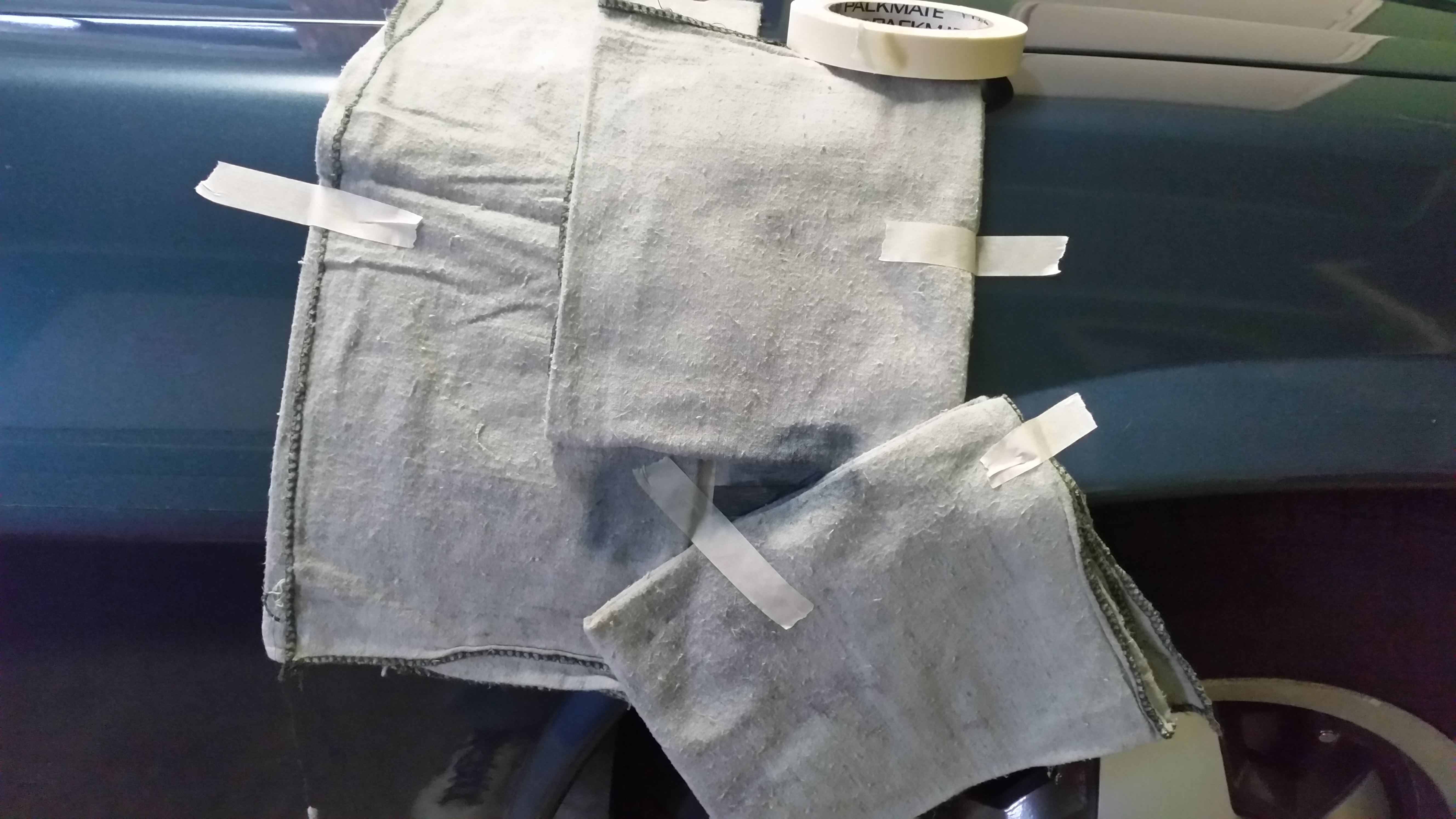

Well i masked her up with rags and masking tape underneath and gave it a shot with my Spray Can of JDM (cobolt blue) i had.
It looks better but still i can notice it.
