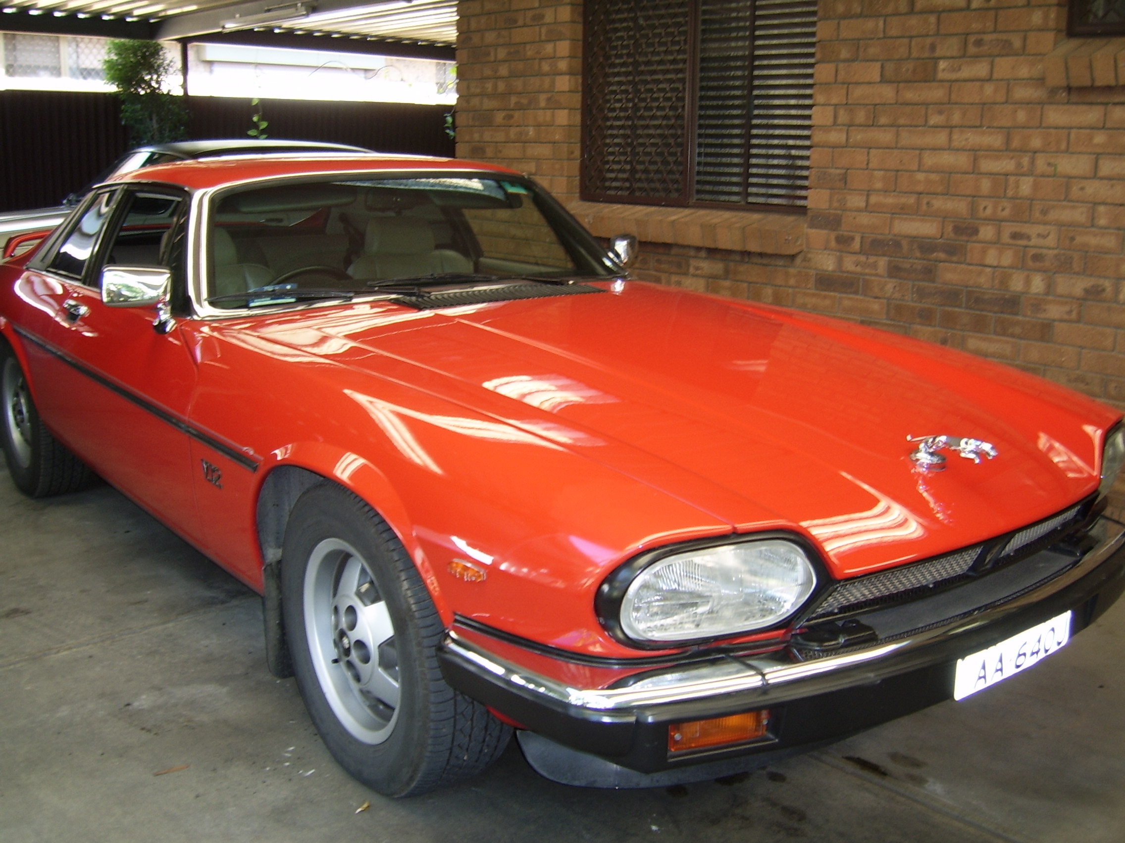

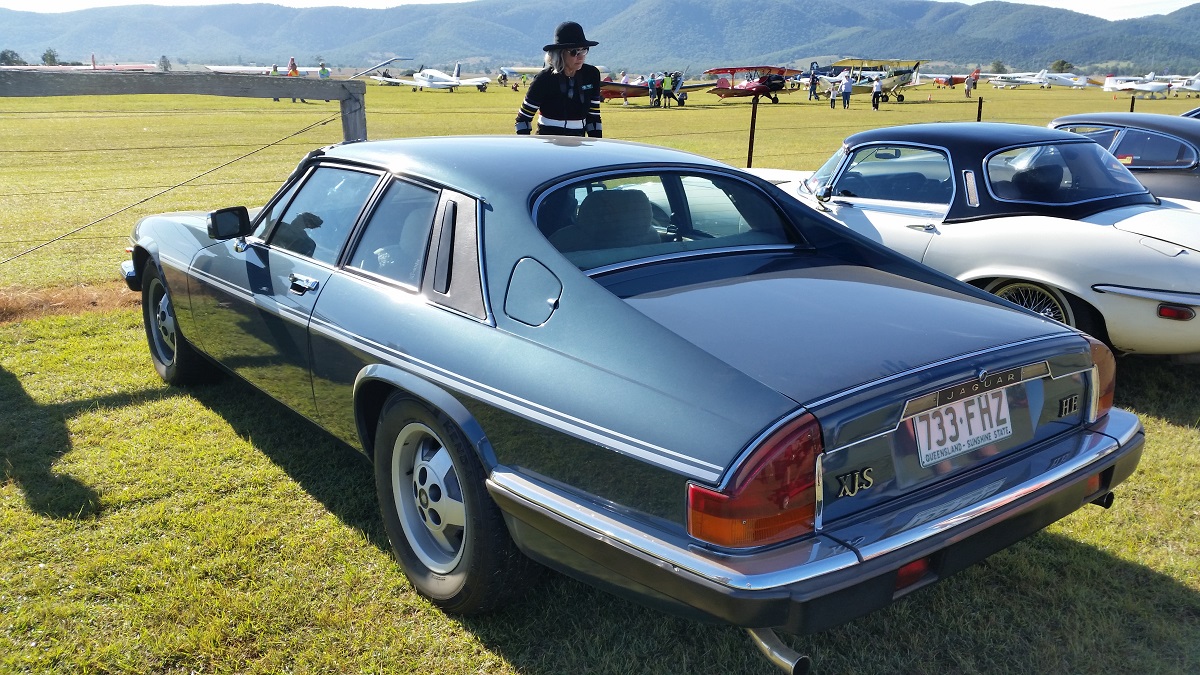

Paul,
Clarke is spot on.

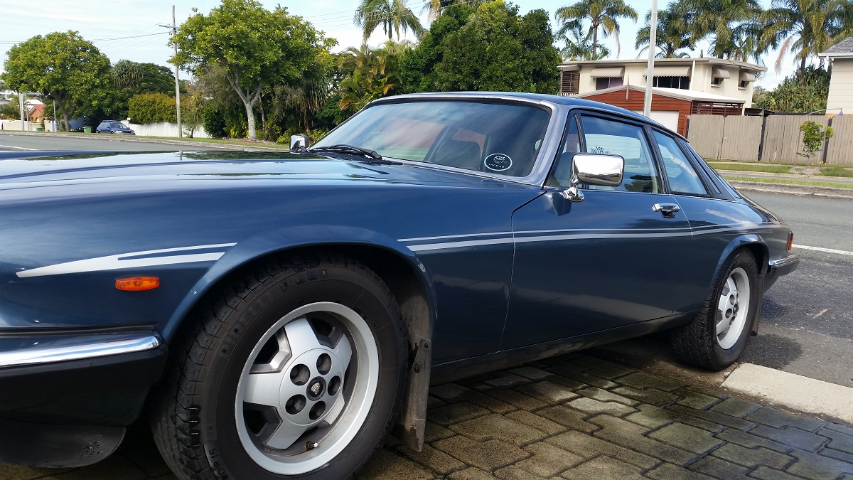

Down here we have a lot of these striping guys in vans that frequent the used car yards. Some are great, and have the method, imagination, outside the norm thinking, and they would do it in a snap, little leapers and all.
Mine had the stripe, with leapers on the front guard, and then the "bump guard" fitted as long as I have owned it. Bear in mind this car was stripped and resprayed by Jaguar under warranty when it was 3 months old, due to massive "Orange peel", and the paint guy fitted that stripe arrangement, at the request of the owner at the time. I think the Red colour gives a different look than other colour cars.

Cheers Grant. Nice pics bud
Actually yours looks alot different to mine. I have the stripe continuing onto the front headlight where it connects up.
BTW do you have black head light frames (as opposed to chrome) or is that just the picture? Always love pics of the Red Devil!
So these mobile companies can make up any length/width/design you want? That might be a good option...

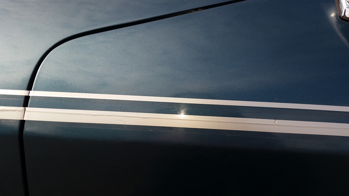

BTW here is the link if you want to toy with the idea of a brand new Jaguar. Its a price calculator and has different model versions. Pretty cool: https://jaguar.webqem.com/driveaway/#?range=XE

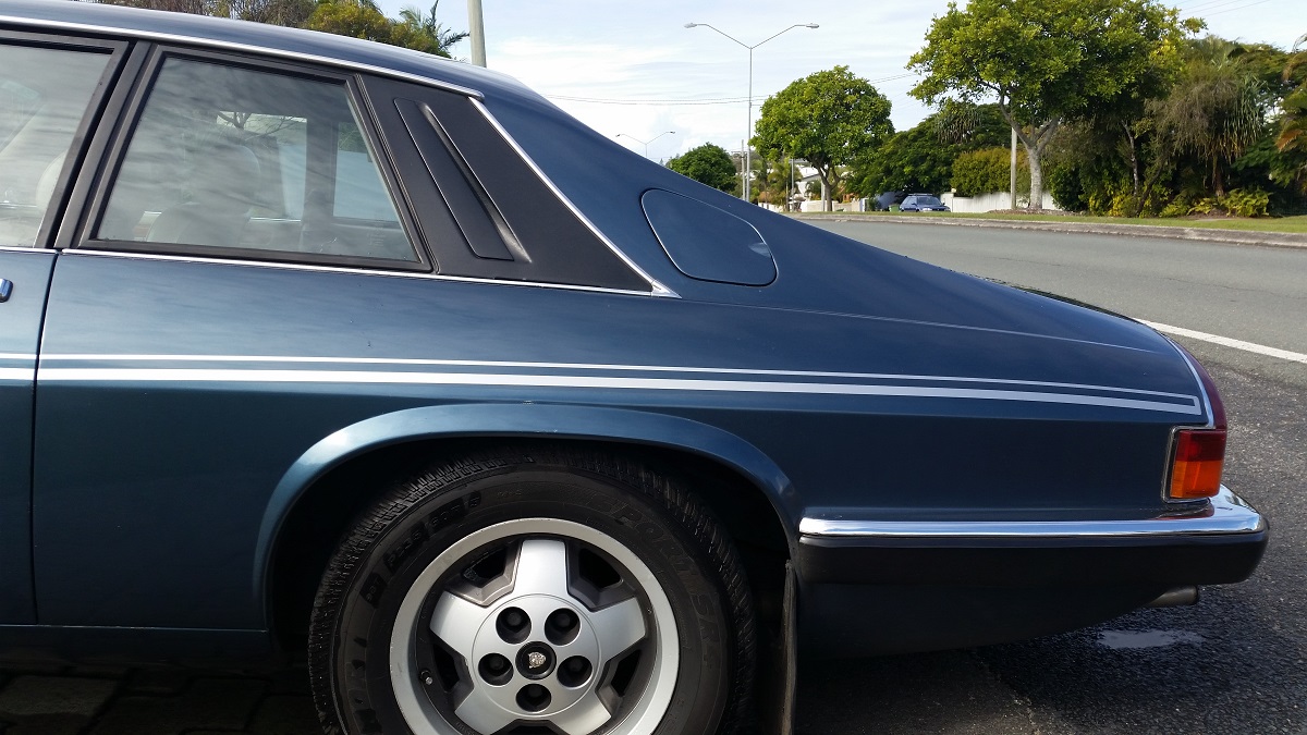

Well in regards to my coach stripe, I had an answer back from Jag Heritage and a few other mobs:
We can supply the silver pinstripe set for your car, picture attached. The
> leaper was added to some of the stripes by dealers and were not original
> Jaguar issue.
> The cost of the set is £95 + £15 shipping + VAT = £132 total
So thats just shy of $200 Australian. I guess that sounds ok? They sent me a picture of the sticker. Does it come in a roll?
I didnt know about the Leaper being added later, can anybody else confirm that? That would make sense though I guess as I met a bloke who had a car very similar to mine at the last meet and his had no leaper at the rear (see pic). No, that isnt the Blue Goose! His was an 83 build in real good condition but unfortunately had not had the blessing of the great Wizard!
Well..... it all sounds like a goer anyway. Happy days!

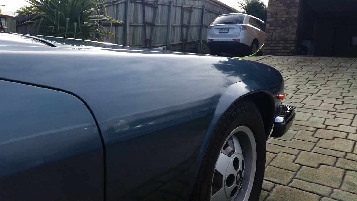

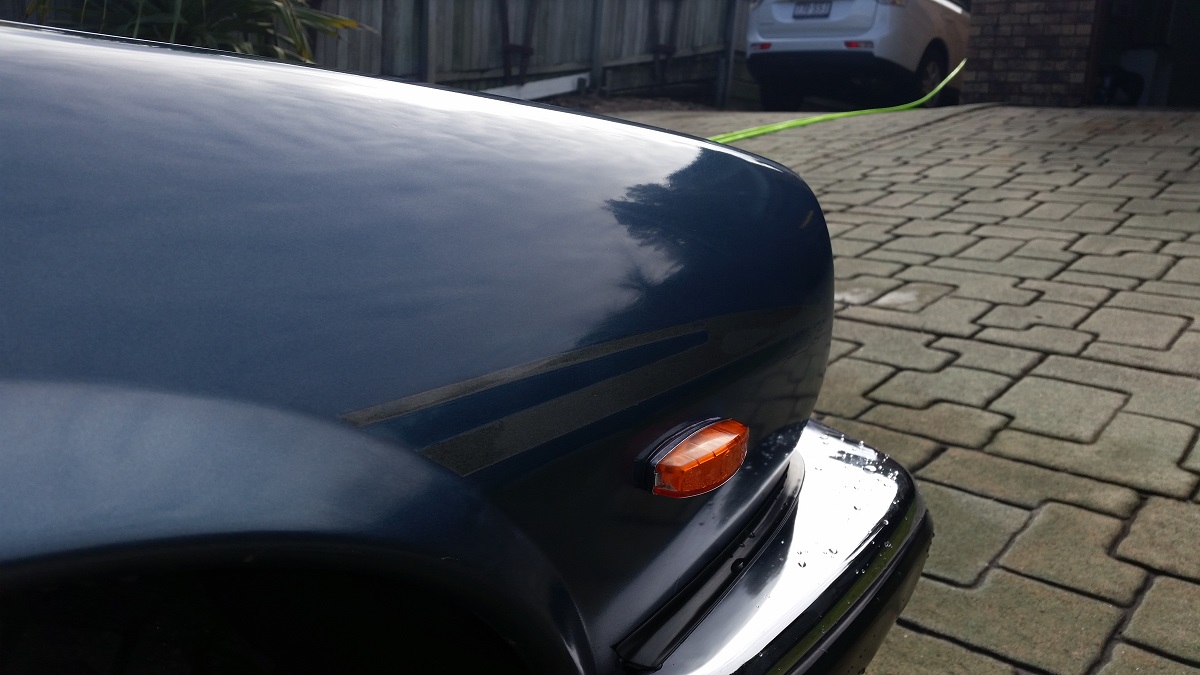

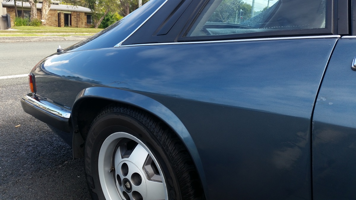

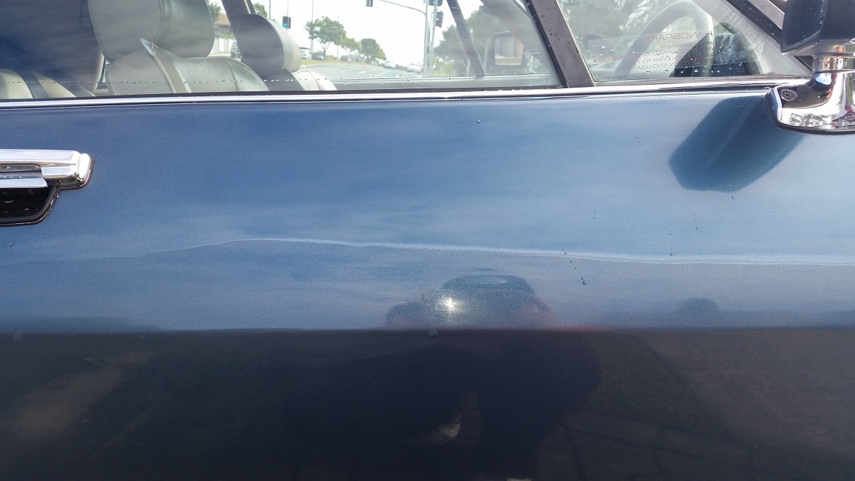

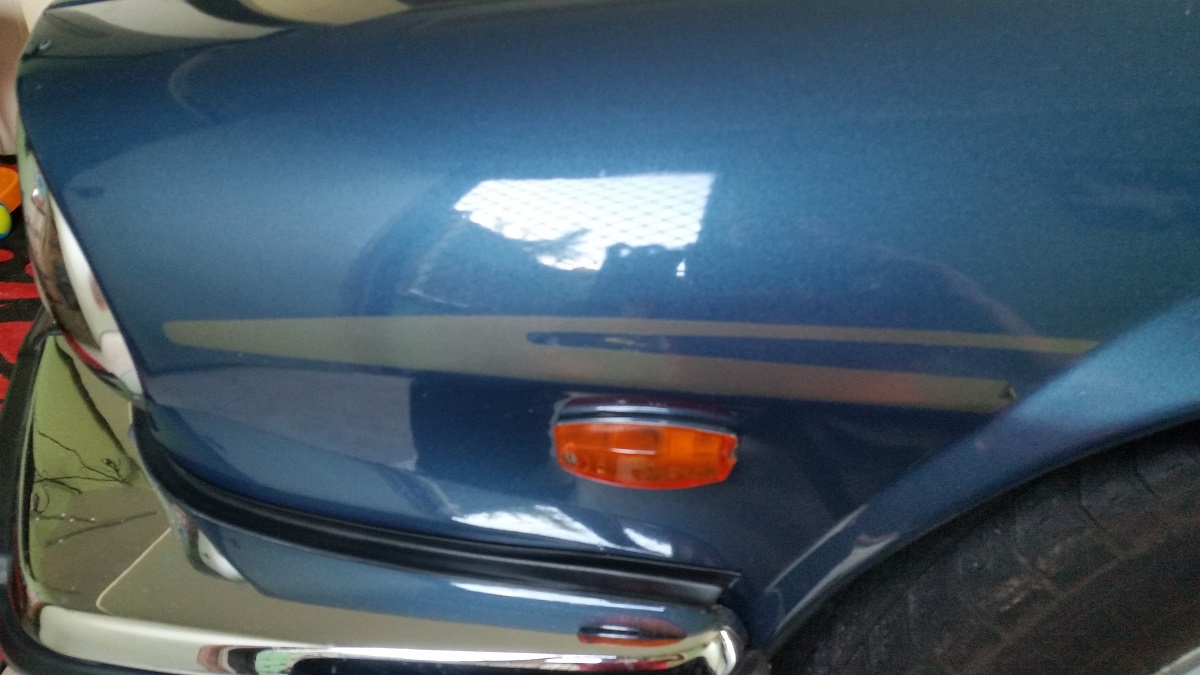

Well i got home from sea only to receive my coach stripes from the UK. With an offer to help from the very generous 34by151 we picked a day and tackled the mission.
They appeared an identical match save for the leaper design now missing in the rear. We started doing the LH side first and after a bit of preparation we laid her down...only to find it would not go in the "groove" left by the last coach stripe. As mentioned above the paint is lower where the stripe used to be than the rest of the body. What we figured out is the previous coach stripes had a curvature in them to follow the rear panel.....the new ones were dead straight. We bit the bullet and just continued to lay it down...we had already committed.
After stepping back we realized she didn't look too great and you could clearly see the older lines and it looked a bit wonky as the old lines through you off and it doesnt follow the curve the same....bummer.
We looked on the other side and we used a heat gun to clear off a bit of the residue on rear RH panel. Low and behold the indentation started coming off and hence the raised line....it appears it is the clear coat. (ie. they sprayed clearcoat over the stripe once they finished) We worked at it and got the rear RH panel looking great.
Now....the problems started. The RH drivers door had alot thinner paint and at once section it started to show bone. We used a different approach and used 1200 grit wet n dry to smooth out the lines made by the clear coat. It started to work. Then we used some cut and polish with a buffer tool to go into the electric drill and we buffered her up real good. Only problem is it has a distinctive line of clear coat left. We are going to re-apply the clear coat in the next few days.
Now the front RH panel behind the wheel arch was the worse. The paint was paper thin and with only a little scrubbing revealed the body! It looks like in her early history she may of had some panel work done or who knows...she is 30 years old after all and history is only really known from the last two owners. Anyway I tried to use some paint and polish the edges back but she still wears down to the bone just as soon as I breathe on it lol!
Finally the front nose (RH) was looking swell however once i polished off the line it revealed a "painted on" coach stripe underneath! Geez its becoming a mission! Hopefully I can just lay the new stripe over that.
Whats next? Clear coat the RH door and front panel. Rub back and polish. Then apply coach stripe.
The LH side? Well we are going to remove it and use the same technique as the RH side to remove the lines, now that we know how. Probably going to have to take a sample coach stripe to a print shop now and get up the pieces that will be wrecked on the LH side during removal. oh well it has been a learning experience.
I would have been totally lost had it not been for again the generosity of 34by151(James) cheers mate!
to be continued.......

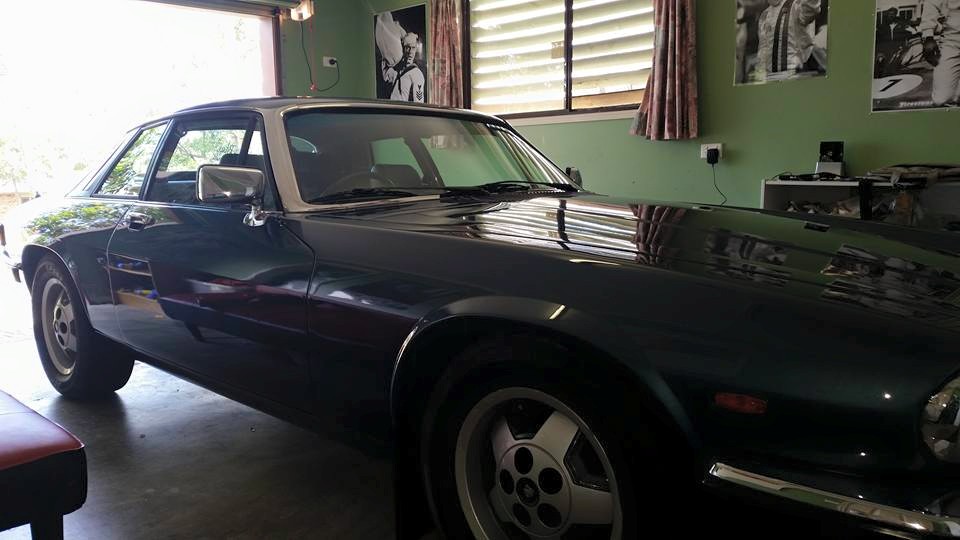

Heh guys
Sorry its been so long since an update.
Just got her back from the Spray shop. Got both sides resprayed plus a few dings and scratches repaired for $2500 AUD.
I am really really happy with the result. The bloke did a great job.
Seeing her looking nice now without the coach stripe I think I am going to leave it off for good. Thoughts?
I have to clean her tomorrow a bit so will take some more photos then but for now just got a quick one in the garage.
