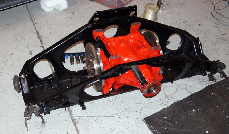

If half caliper is out of the car, pry them out with two opposing screw drivers, using that groove on top of the piston. If you succeed moving it up a little, then lock wise grips onto the top of piston and spin it out.
I just did all that with my rear end being fully redone... fun fun fun!
