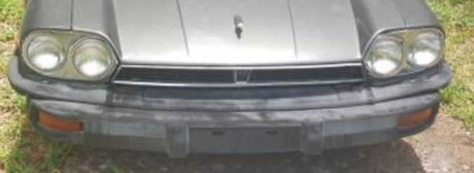

Dont think it can get much worse than this... I,l let you know.

That's definitely a sad bumper!
I've had good success with a good surface prep followed by multiple thin applications of Forever Black with a foam applicator brush:
Cheers,
Don

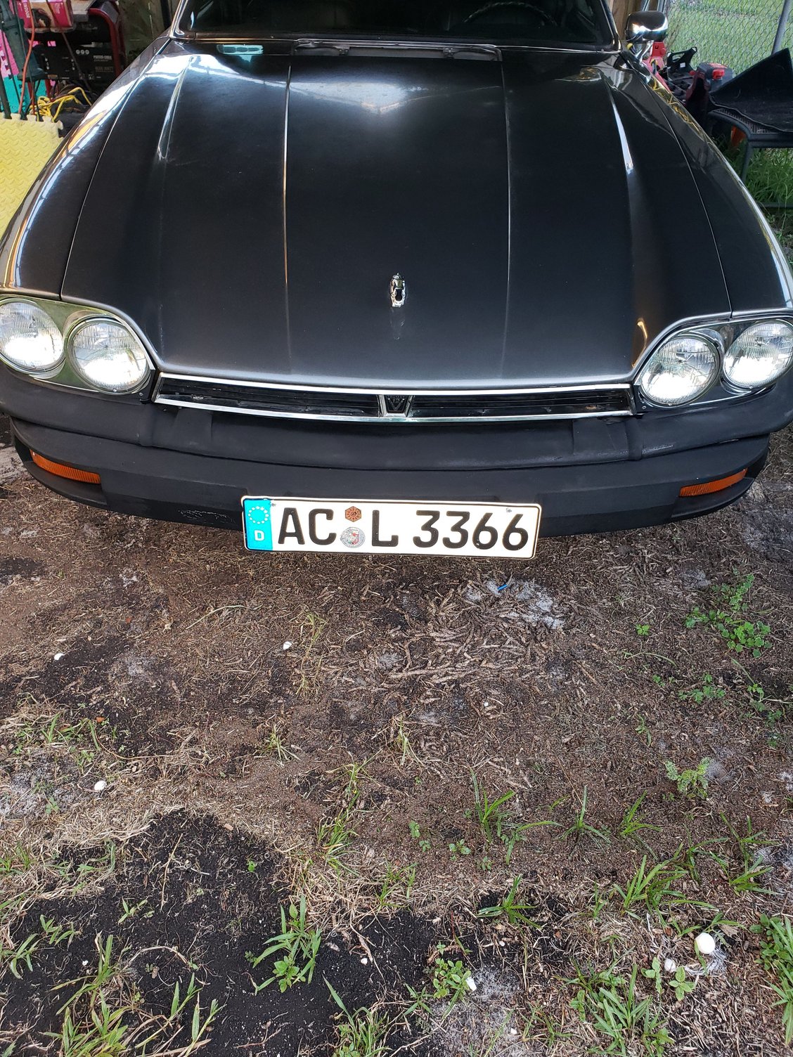

Post the after pics if you don't mind.

Default Little better

Came out nicely.
