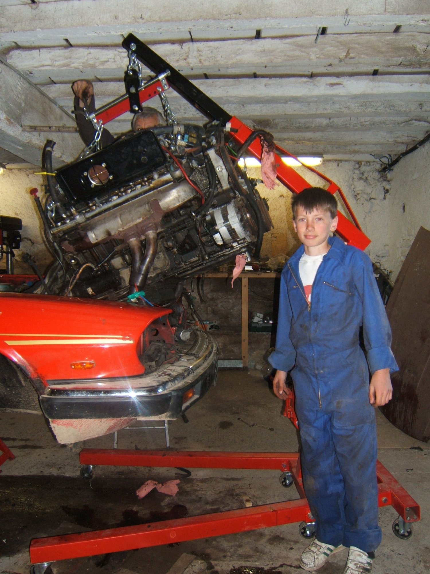

Old Dec 8, 2025 | 12:01 AM
Greg in France's Avatar
Posts: 14,600
Likes: 10,794
From: France
Well done! and snap!
Greg you look much younger than you let on…

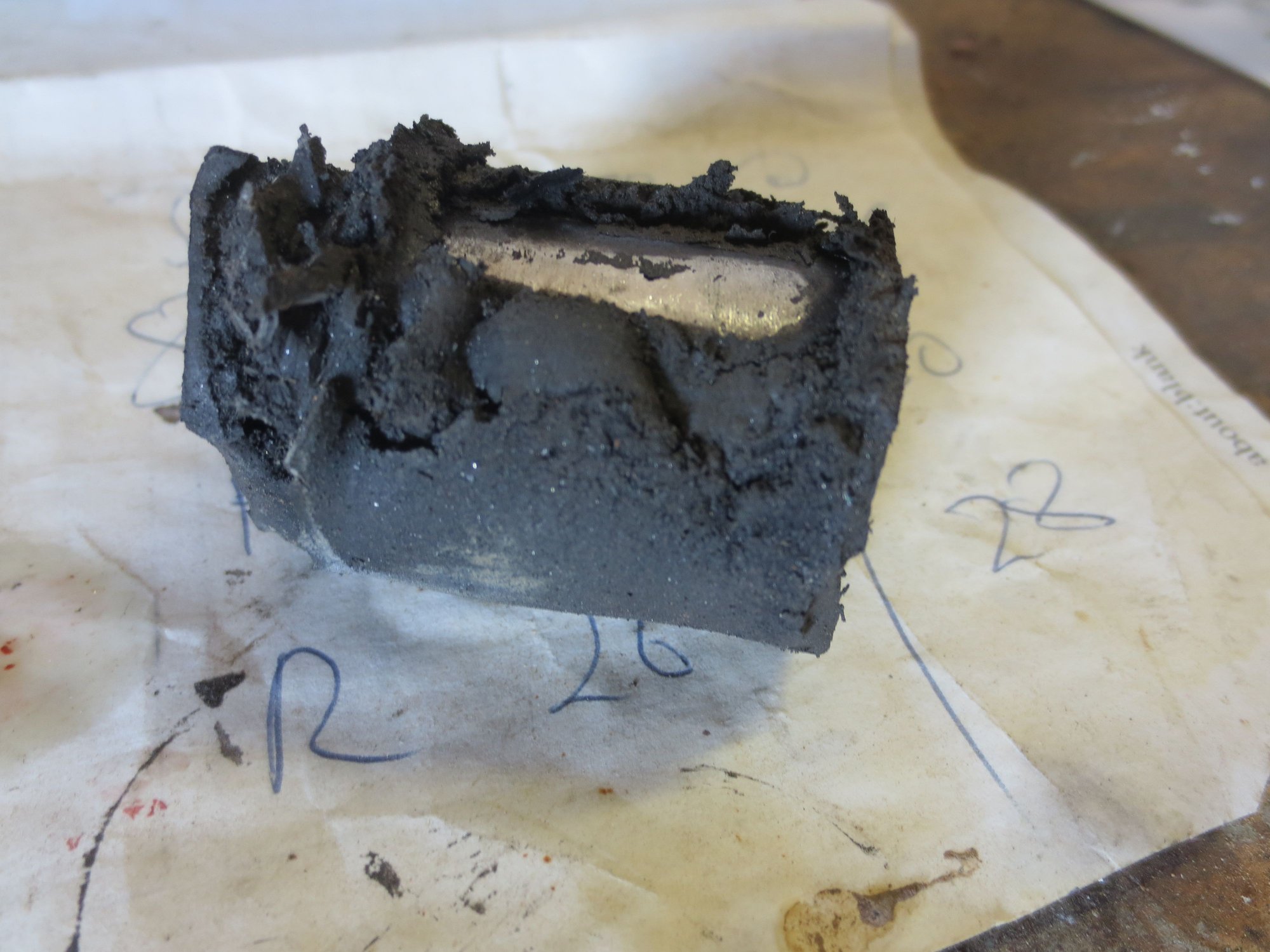

FWIW I think having the tranny professionally rebuilt is a very sensible plan. There are critical clearances in it which if not correct spell disaster...
New shocks for sure, but to retain the famous Jaguar ride, you need either OEM shocks (which were Boge part number Boge 30-D86-A009 and are still available if you look) eg:
https://www.simplyperformance.com/sh...boge-shocks-68
or adjustable ones (as you mention, I do not know that particular make) as long as they have a wide range of adjustment. The best ones over here, which are widely used by the Jaguar classic fraternity, are Gaz adjustables eg:
https://www.ebay.co.uk/itm/123226089...Bk9SR_qxtK_iZg
Absolutely the right decision to change all the suspension rubbers, including engine mounts, front crossmember mounts, rear cage mounts, control arm and rear radius arm bushes. However, be warned, you absolutely MUST use genuine OEM Metalastik brand items, front and rear in ALL places. These are getting hard to find, but Jack Weston at David Manners
https://jagspares.co.uk/
is the guy to talk to as he still has some, I think. If not, get the part numbers from Jaguar Classic and start searching!
https://parts.jaguarlandroverclassic.../brand/jaguar/
trawl ebay etc etc. Anything else will fail in weeks or months, as these sad photos illustrate (I learned the hard way) these innner front lower wishbone bushes from a well known aftermarket supplier, had been on the car two months:

Wow Greg that is terrifying and is causing me serious pause...
Alas I am in the US so sourcing from the UK is a serious budget hit, but also I cannot afford what you showed happening!
I live within can go in person distance from a "major US Jaguar parts supplier" - past transactions have gone well - but I've not bought anything this critical.
What I've read here and elsewhere has steered me (pun intended) well away from polyurethane except for specific uses like steering rack bushings. But is this an option I should even be considering from a longevity trade off?
And also 100% on the fuel and brake hoses! I'd already done all of the engine related fuel hoses and they were in terrifying shape. I am in full on "hey ...you should do this now while you can do it easily" mode
