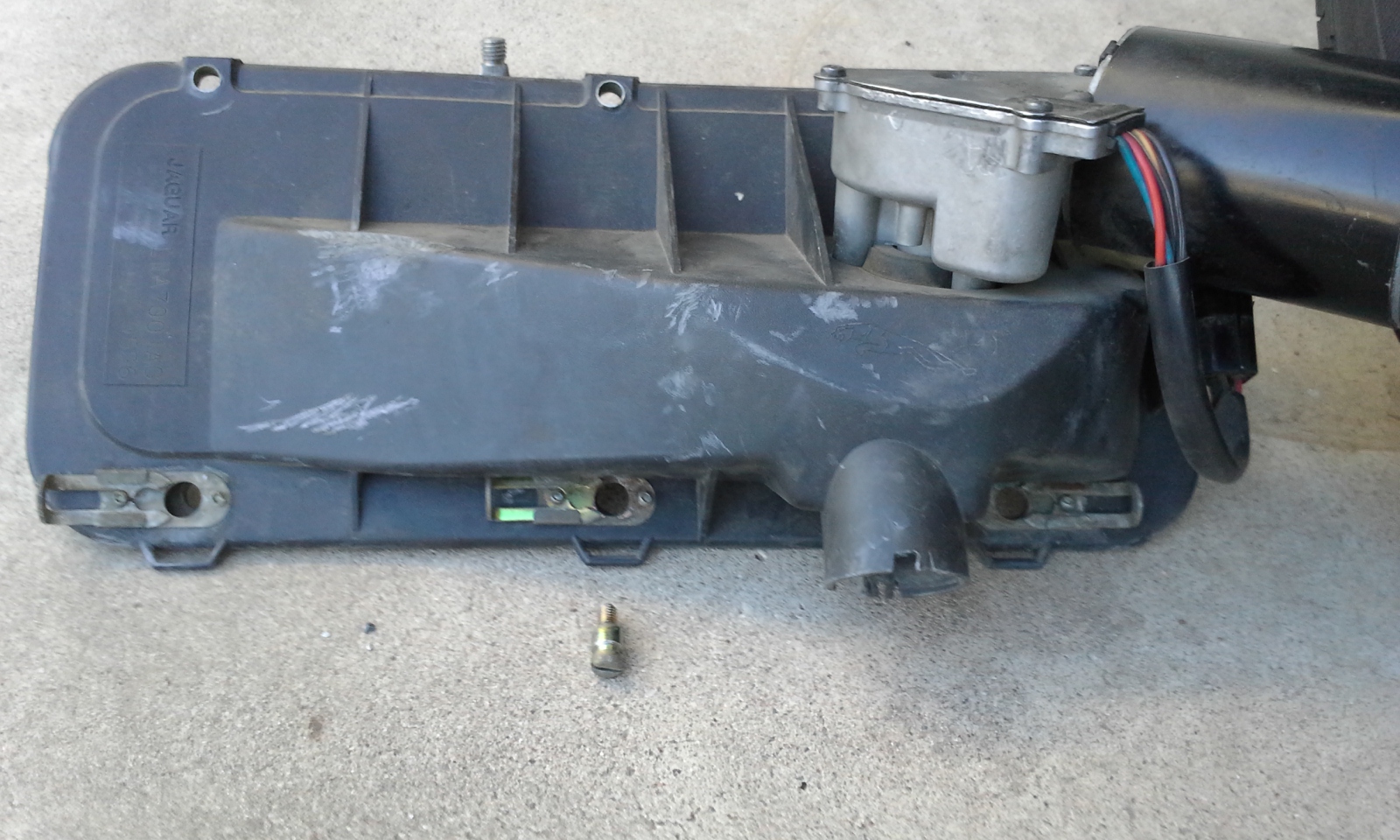

It is downright easy once the manifold is off! While you're at it, replace whatever else suits you. Namely, the two coolant pipe gaskets!! {EDIT: Part# EAC9745} ... Easy. I also put in a starter and repaired a section of heater take-off hose. You might do the lower hose or the oil sender gasket too. I think the most difficult part was removing the wiper mechanism to get clearance. No need to disconnect the harness to the coils or injectors, leave all that connected to the intake manifold and runner. You'll get a new intake manifold gasket installed then. A good cleaning might be in order down there too!
The Dayco part # for the bypass hose is 71666. Also called the DEVIL hose.
There is information in the X300 section about doing this job without manifold removal. Access is a real devil.

My apologies. The correct gasket part number is EAC9745. I corrected my original post. Those pictures are from my AJ16 Vanden Plas. The setup of the AJ16 XJS is a bit different but the water rail and gaskets are the same. Thanks for pointing this out. It will be interesting to discover all the differences when I become an XJS owner someday!
AJ16 XJS water rail, pipes and such:
