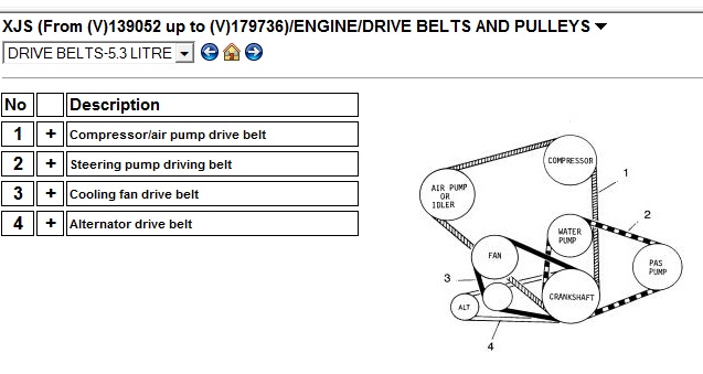

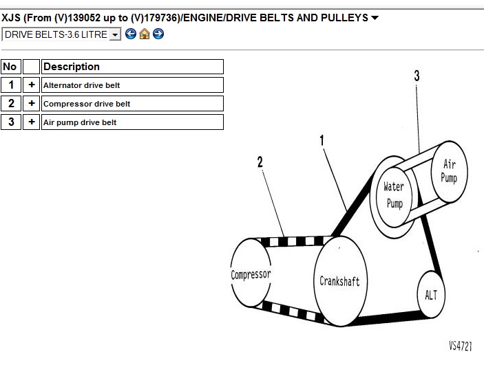

A diagram may help identify the one you need to replace:
1. 3.6 Litre
2. 5.3 litre
Click on each of the images to enlarge them.
