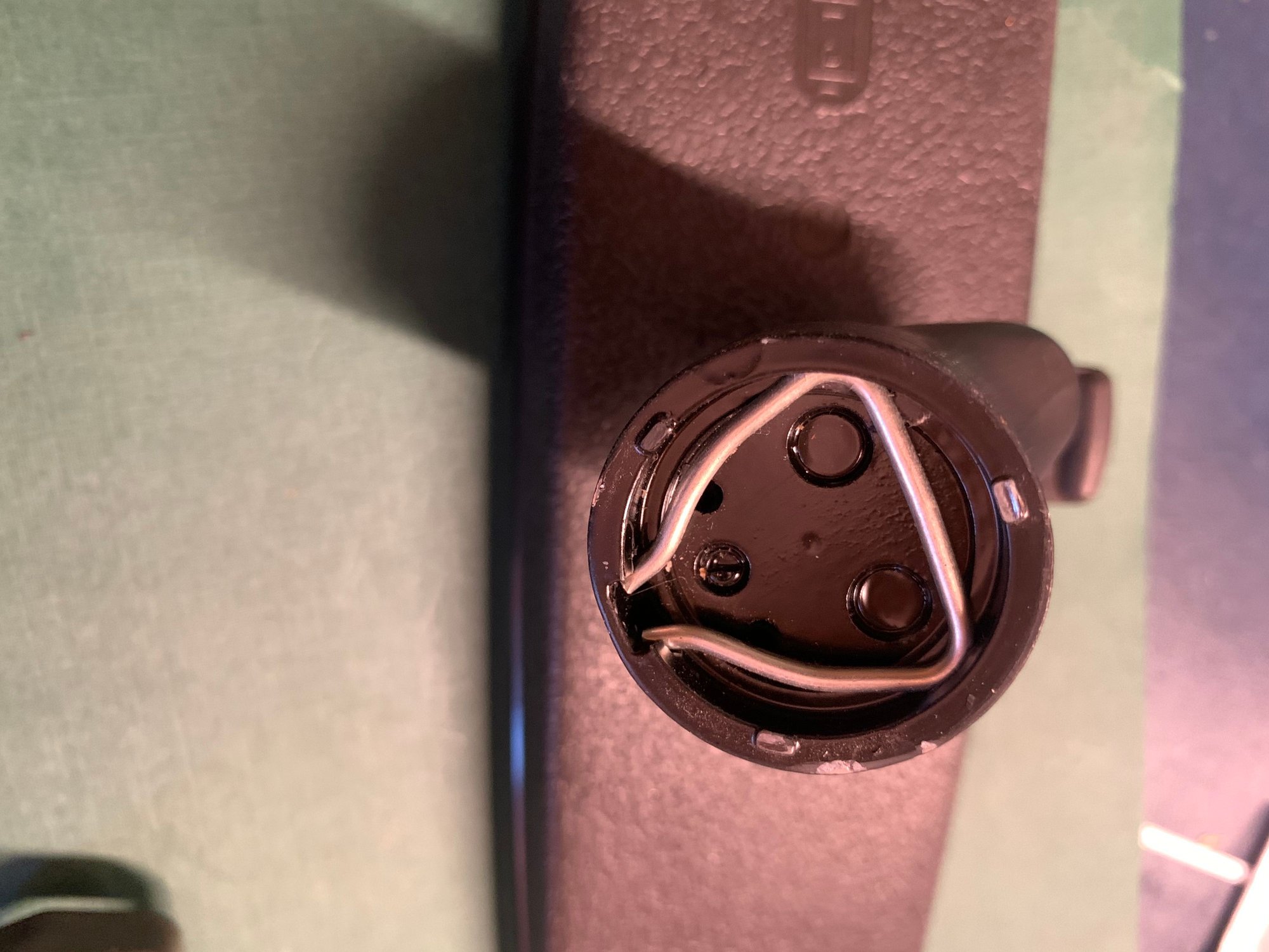

Ok. Apparently there is a metal base that comes off. It’s basically a slight rotation that disconnects the mirror from the base. I used some adjustable pliers to grip the base.
Mirror with base removed. The base is held in place by that metal triangle frame.
Base that should be glued to the windshield with minimal problems. You can see how the base is held in place by that metal frame in the mirror now.
