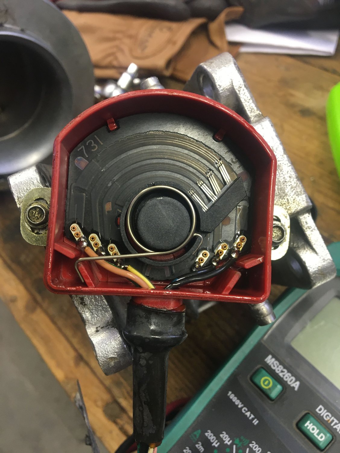

I'm guessing this is late 80's technology in a mid 90's car. Something Im a little familiar with from my past life as a USCG engineer. So I'm also guessing that there is some kind of contacts inside the TPS where there is a physical contact between switches. Otherwise cleaning it would not have any affect. If that's not the case and this is a "solid site" electronic switch I need a "new" one, because a resistor or some other electronic thing beyond my knowledge has failed. I know from reading, this TPS controls the injection system and transmission shifts. Thats why there are 6 wires verses 2 or 3 wires as there are on other Jags. After cleaning the original three times there really is not much improvement. I have two used ones coming as a new one does not seem to exist anymore. Once I replace the original Im going to try and take it apart and confirm my original guess. l'll post what I find.

The inside of the TPS.

So the inside is a potentiometer. The outer wire corresponds to the GY wire that controls idle and I believe throttle control.

Ive never removed one. But its great to see you do it. I hope this clears up your issues
