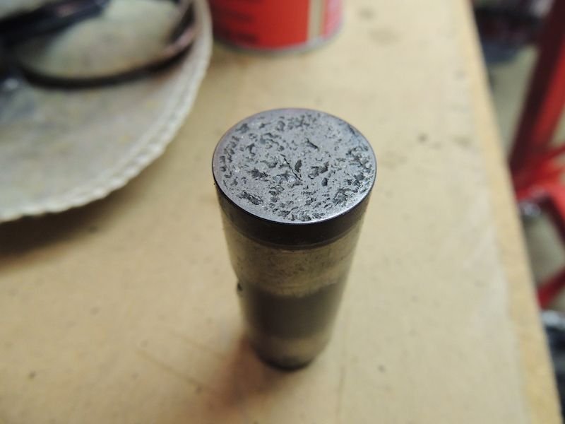

If you car has roller tappets, you are OK using an oil with reduced levels of ZDDP.
If your car has flat tappets, you need the protection that ZDDP offers. You can either buy a ZDDP additive or use an oil with the higher levels of ZDDP. I personally use either a diesel rated oil (Rotella T5 is my current favorite), Valvoline VR-1 High Zinc (I can only find it in 20w-50), or Brad Penn motor oil (expensive but good).
Here's what happens to a flat tappet if you use the wrong oil. I pulled this from an MGB I was restoring. The lifter had spalled and the camshaft was chewed up. Not sure which happened first and I am not sure it really matters.
There are some who say that you only need the elevated levels of ZDDP during break in. My personal opinion is it's most important during break in but still needed during operation.
The levels of zinc and phosphorus were reduced sometime in the 90's to keep blow-by from poisoning the cats. It wasn't the last time the longevity of the engine was sacrificed for emissions control. If you're bored read about how the newest Mercedes diesel engine sacrifices itself to keep the diesel filter from dying.

In my mind, the question is less about SOHC, DOHC, or QOHC - it's flat tappets or roller lifters. If your car has roller lifters you can get by with the lower zinc/phosphorus levels because of the nifty roller wheel. If you have flat tappets, regardless of how many cams you have, the higher zinc/phosphorus levels provide the protection needed for the cam and lifter.
On the other hand, it's not like it's something that happens right away. My dad has a B-body Mopar with the 383/4-barrel engine. He has ignored my advice for the last ~15 years about being careful about what oil he puts in it, and is just now starting to see the effects of the cams/lifters eating each other up. I think he has another year, maybe 2 at the most before we have to pull the engine and rebuild it.
I'm not trying to start a holy war and I'm not trying to sell anyone to my way of thinking. I have personally seen the effects of the ZDDP change in my own cars and learned my lessons the hard and expensive way. At the end of the day it's your car and your decision to make.
